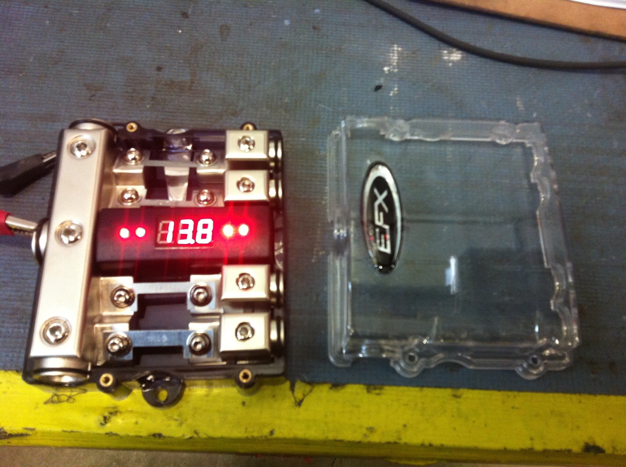

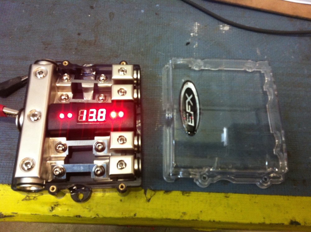

if the main wire feeding your fuseblock is too small, then yes. it doesnt matter how big the alternator is, if the wire is too small to carry the total load, you will have problems. you might think of adding a second fuse block that feeds the add-on goodies. also keep in mind that clean, tight, corrosion-free connections and grounds will help.
