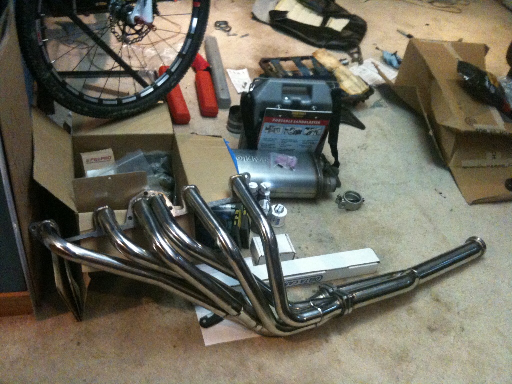

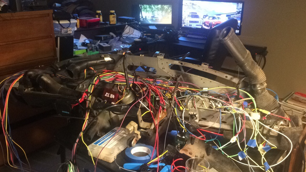

I posted a thread about a year ago. But I can't find it anymore. Well I was even stupider than I am now so let me just start a new one and keep this one alive. Anyway for those who don't know I'm 16 and bought a late 1971 240z with a L28 bottom end and a 73 e88 head. Now I have rebuilt the motor with a e31 head, new valvetrain, high lift cam but not long duration. Bottom end remains stock with flat top pistons. Twin SU carb bored by rebello, Zstory header and muffler, 2.5in exhaust with a resonator and a cutout right behind it. I'm still working on rewiring the car but I have put a AFR gauge in where the clock was and a knock sensor will be in the map light slot. A tenon amp and some old Sony speakers because I might need it. This is all that I can think of and body and suspension is my next objective. I have never seen the car running so I'll worry about rust later. IMG_0021.thumb.JPG.0049ec60fb2fa109ad1d7

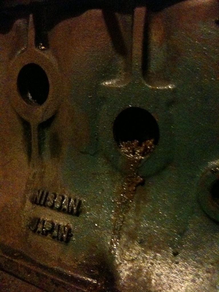

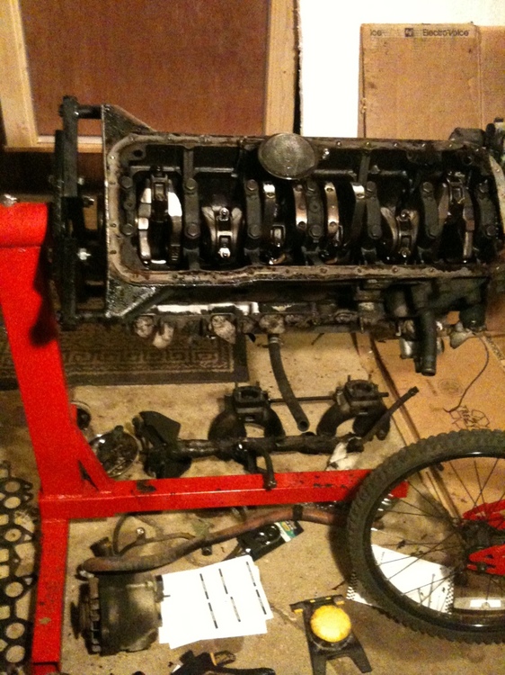

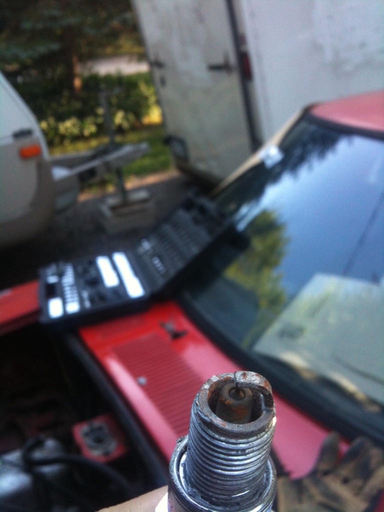

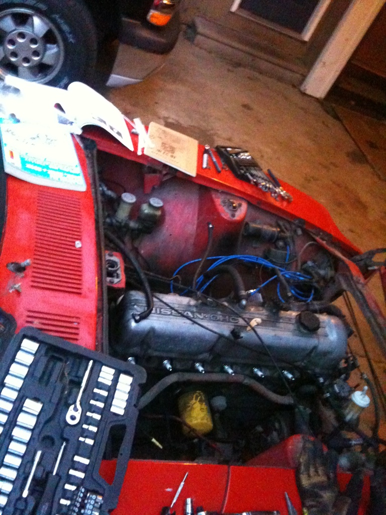

Here's the car when I got it, tried to start but failed. Later found out there's rust on the 2nd cylinder...IMG_0023.thumb.JPG.7dba37f46952736d84f13IMG_0026.thumb.JPG.2750ff7a872463f7dc063Pulled the motor myself, man that was a full day of grease and sweat!IMG_0035.thumb.JPG.9f7ff1e07e94906ca9965IMG_0036.thumb.JPG.926cc9eb268b6aefb83d2IMG_0039.thumb.JPG.2b54f584fc53c3476305b

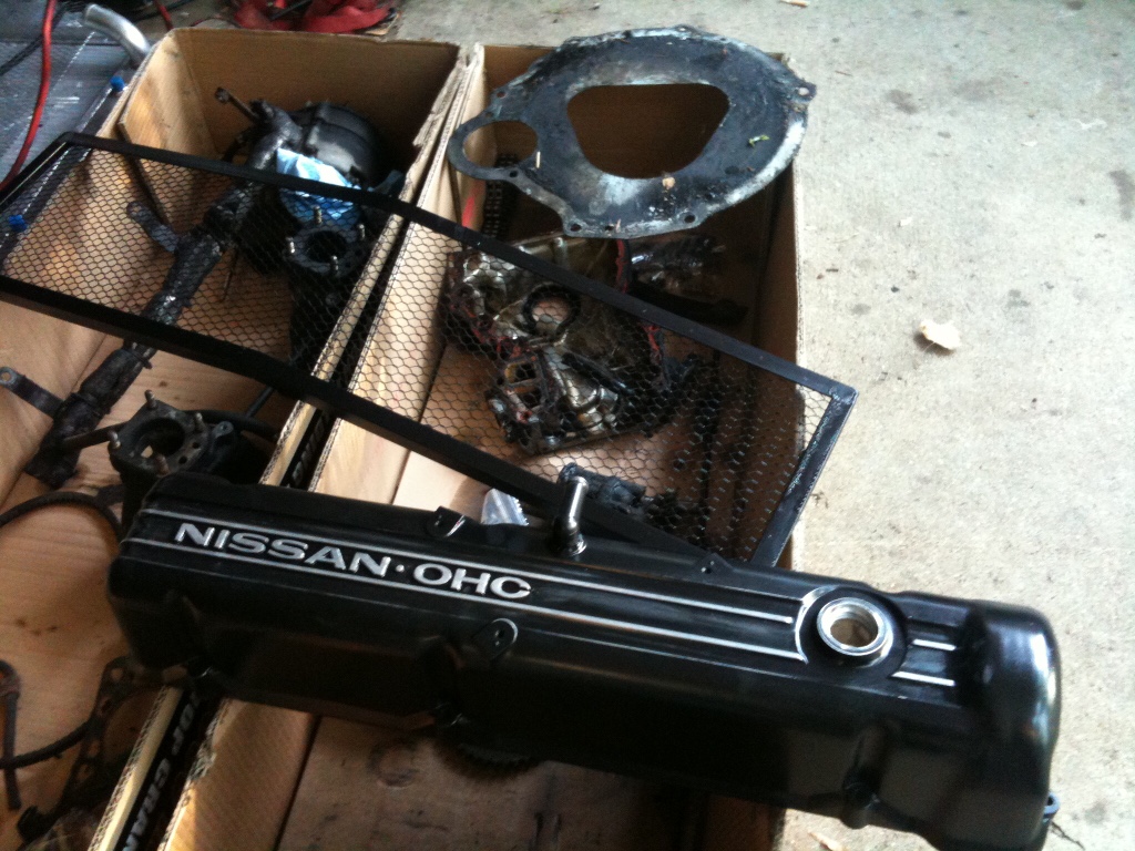

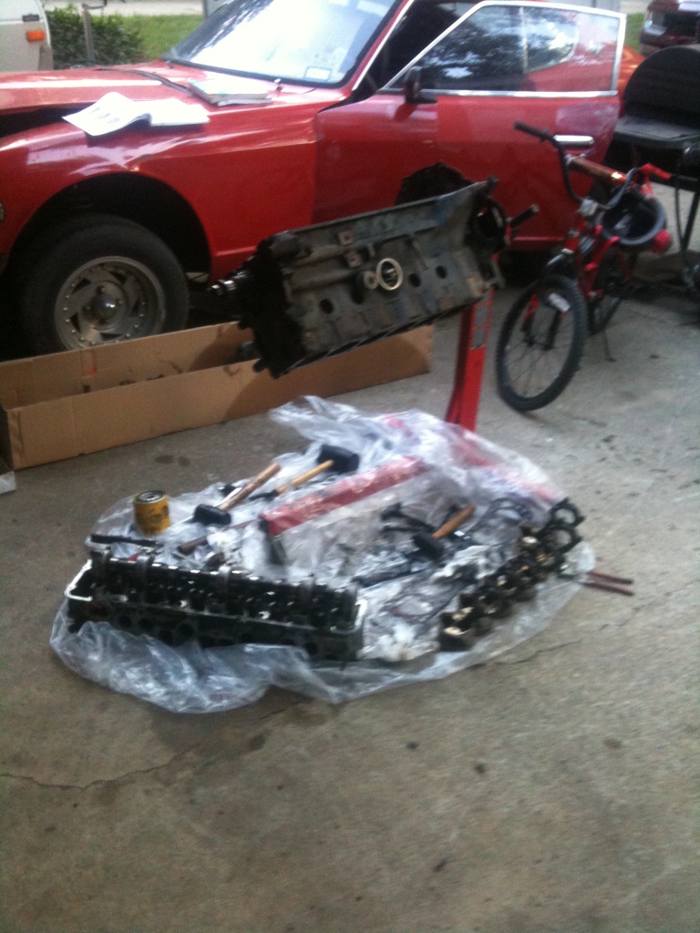

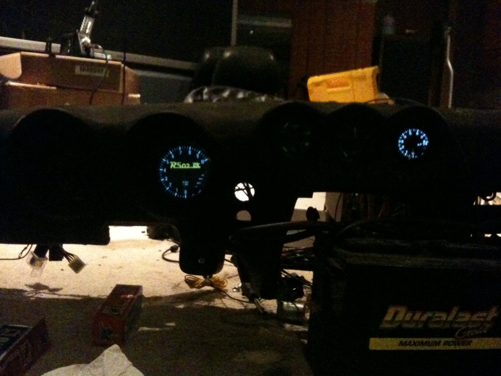

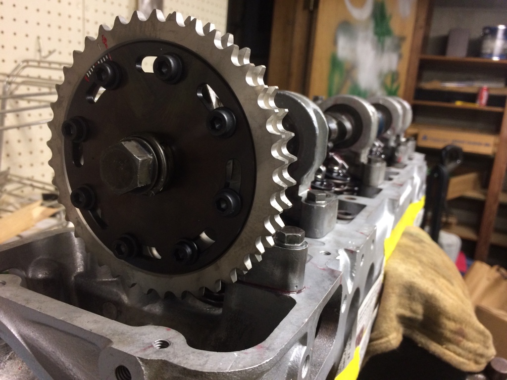

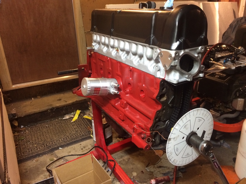

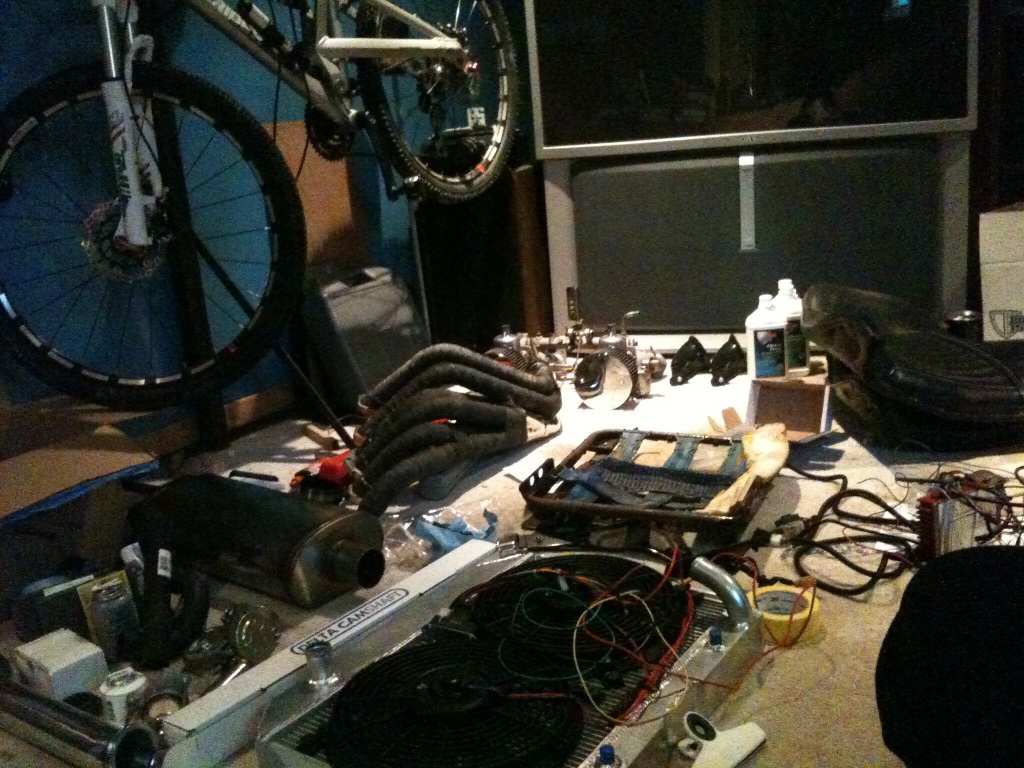

Disassembled and sent to machine shopIMG_0106.thumb.JPG.e8e0e1e802441903efbd1made a grill myself and paint the valve cover as I'm waiting.IMG_0125.thumb.JPG.016cb28ebbed2af966c2fseat coversIMG_0143.thumb.JPG.9010012c2545fbb9e3626IMG_0249.thumb.JPG.4125dc664601a734f7a3dIMG_0177.thumb.JPG.d8ef07e013345c000297fIMG_0215.thumb.JPG.d96ca61ee63e6873bdbc2exhaust and parts...IMG_0147.thumb.JPG.a325683e66e17462c20cepolish cylinderhead...IMG_0227.thumb.JPG.ffe7fd4931000c7f79cb4new gauges IMG_0343.thumb.JPG.aa8c3599444587ba8cd6awiring. Yep. Plan ahead or get messed up like me!IMG_0364.thumb.JPG.6ffc3bb48ca438613e86eIMG_0241.thumb.JPG.8a8b2ab05bcd37fd3d469IMG_0387.thumb.JPG.531e7e55e0bb5da5784a9 Here's where I'm at, degreeing camshaft.

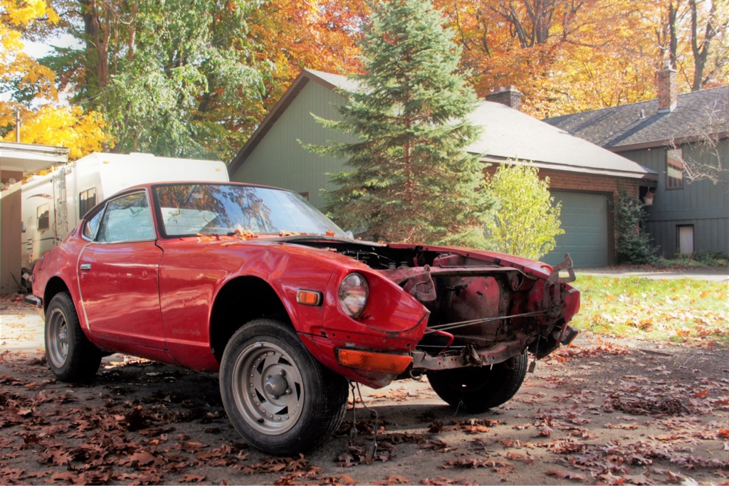

The phone app really screws up the order of pictures and words... Here's some pictures I took on a sunny day in autumn. IMG_0195.thumb.JPG.5425b51b2d31fce3ddb27IMG_0196.thumb.JPG.0e6d08e5e35ebed834fd8IMG_0197.thumb.JPG.7c804c3acf9307201f0fc

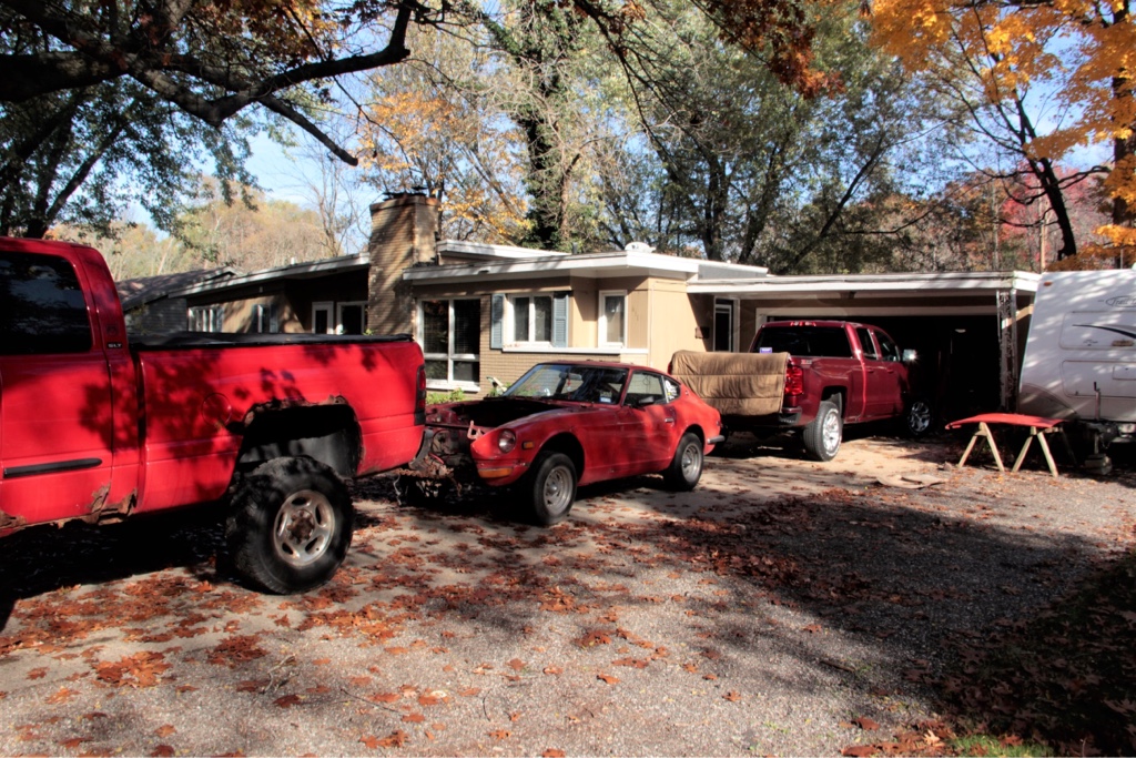

Oh, and here's how you pull the front radiator support strait! LOL. Well I guess I have to make a new one and wield it...IMG_0198.thumb.JPG.0f227ab6d67fb85223bf2
