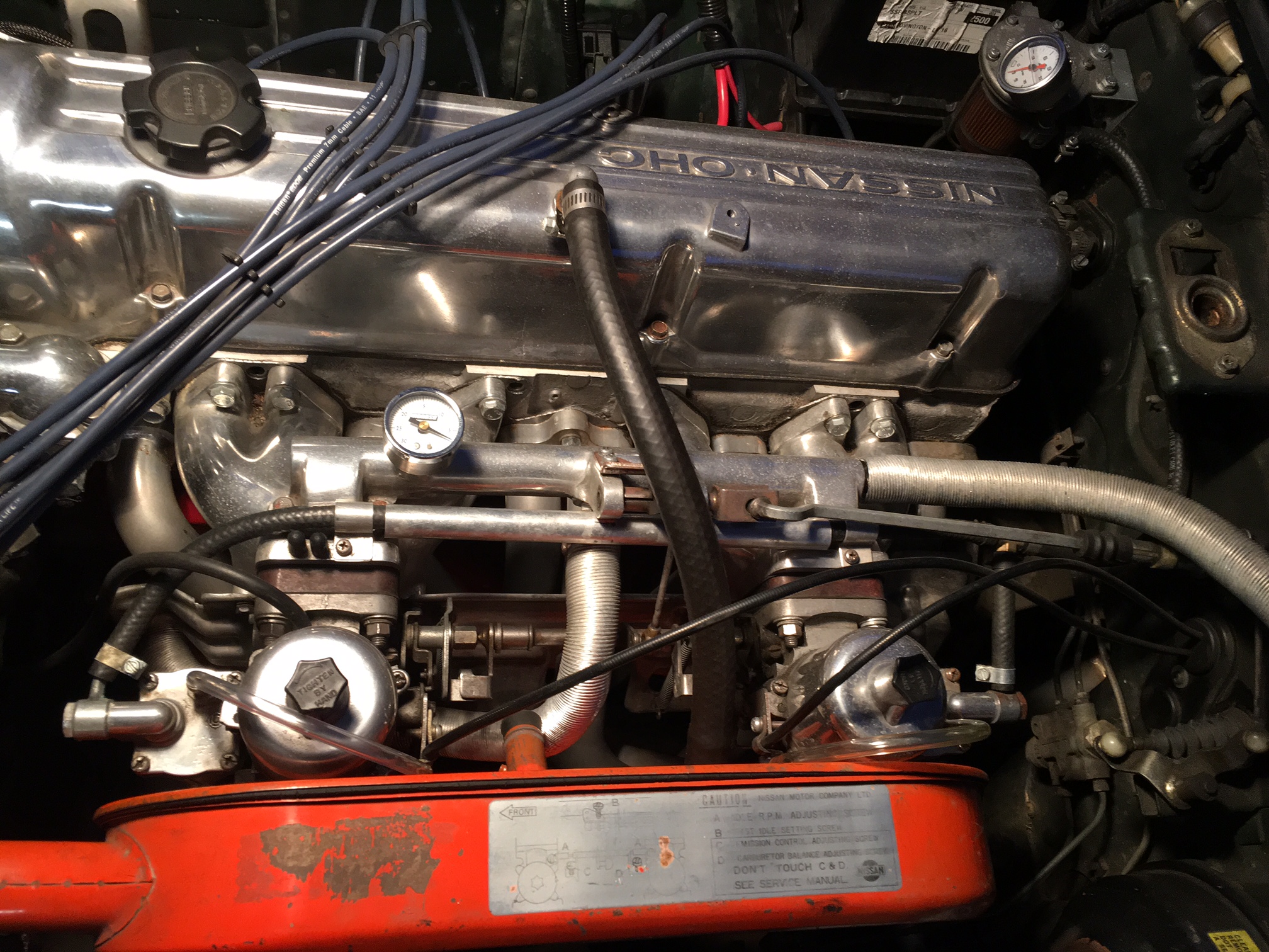

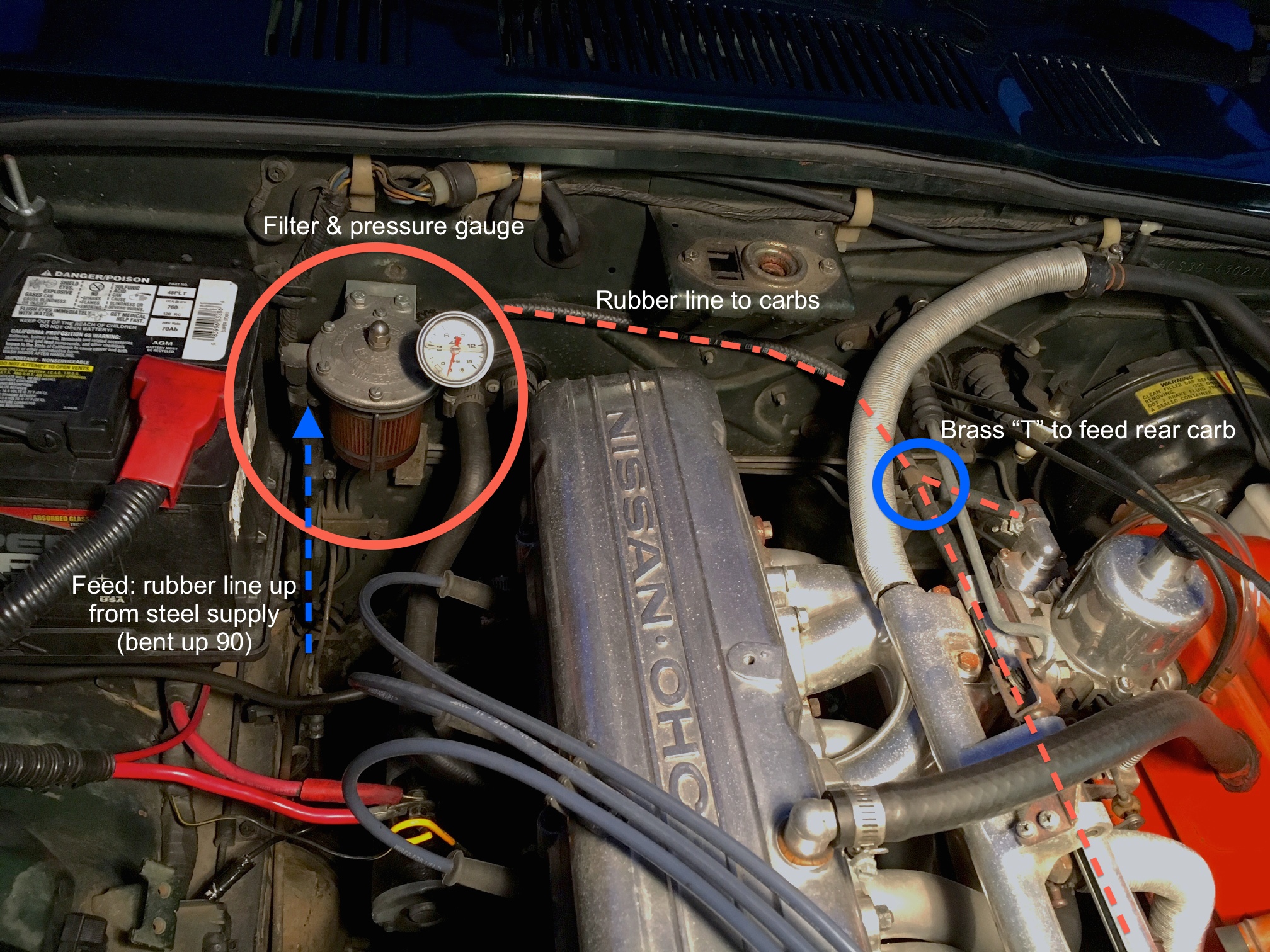

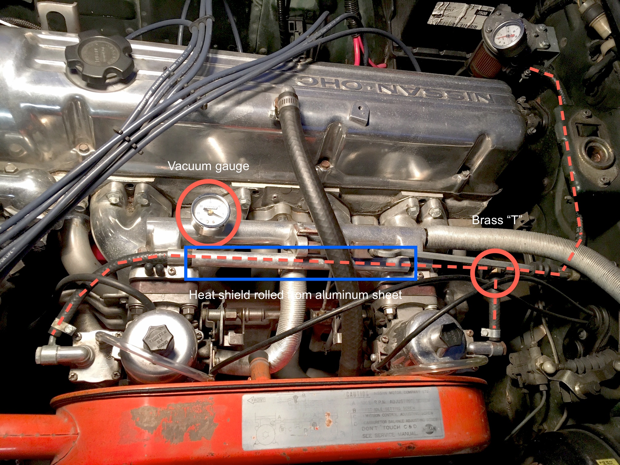

i never liked the steel fuel rails or their routing around the front of the engine, so when i started from scratch w/the fuel lines in the engine bay. i bent up the feed line that comes up under the battery 90 degrees and put a rubber line up the fire wall, mounted an old-school "filter king" glass bowl filter/pressure regulator with a bottom input/right side output and ran rubber fuel line across the firewall (up under the windshield washer hoses) over to the carbs, fed both and dead-end at the front carb. i rolled a strip of aluminum sheet into a tube and loosely wrapped the piece of rubber line in between the carbs to act as a radiant heat shield for it. the system is fed by a little electric pump mounted in place of the stock efi pump. my round-tops came with a steel heat shield which is installed. it really got rid of a lot of clutter and it works great.
btw: i also ditched the vapor canister and associated plumbing/clamps.
here are a few pics - no comments on my filthy bay please! it's winter and i drive her every day...
kinda hard to see, so i've included a set w/notes to call out the fuel system. i cut the steel feed line from the tank/pump and bent it up 90 at the firewall, then used rubber line up to the filter. i removed the evap canister and left the steel vent/return line in place and just capped it w/a bolt in a piece of rubber hose clamped onto the end.

as for the fuel pump - i used a little electric airtex unit mounted in place of the original (above passenger side rear wheel) and used the efi pump wiring to power it.

you can also see i used some flexible aluminum heat shield around the vacuum line for the brake booster as it's above the exhaust outlet and gets hot. i actually bent up a piece of steel tube (old bits from the original efi rail) and slid it inside the rubber vacuum hose b/c when it got hot i noticed it would collapse. also used the same shield material on the pcv hose. the vacuum balance tube is a stock unit that i cut off all the egr and other crap, welded up the holes and ground/polished to look like a euro-style tube. i left one port on top for the vacuum gauge and fed the brake booster from the end.
