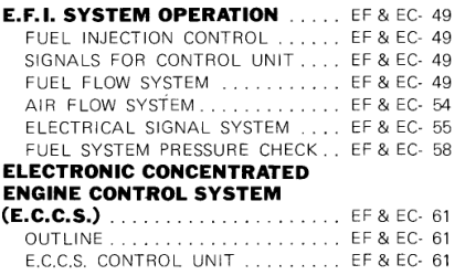

A 280z or 280zx has no ECU....  It has a ECCS,  what could be explained as an ANALOG "computer" It does not have a "clock" as a ECU has and no Programming Either..  But.. please correct me if i'm wrong..
And ECCS stands for: Electronic Concentrated engine Control System.

The ECCS came around in 1981 with the Turbo 280ZX's.  They did call it E.C.C.S. and it stands for what you're showing.
But Nissan called the 280Z EFI control systems just "E.F.I" and actually just called the control unit the "control unit".  You can see a good comparison in the 1982 or '83 FSM's.  I think people just added "electronic" to control unit because ECU is commonly what they're called for most brands.  And Nissan still calls the box a control unit, for the ECCS.
Anyway, the first few pages of the FSM's are like school books.  There's a member here, cgsheen, who recommends the later 90's era ECCS if you're going to go to Nistune.  It's more advanced than the 80's 300ZX systems, but not too complex like the 00's and 10's systems.  The key is modifying a distributor to use the CAS wheel.
