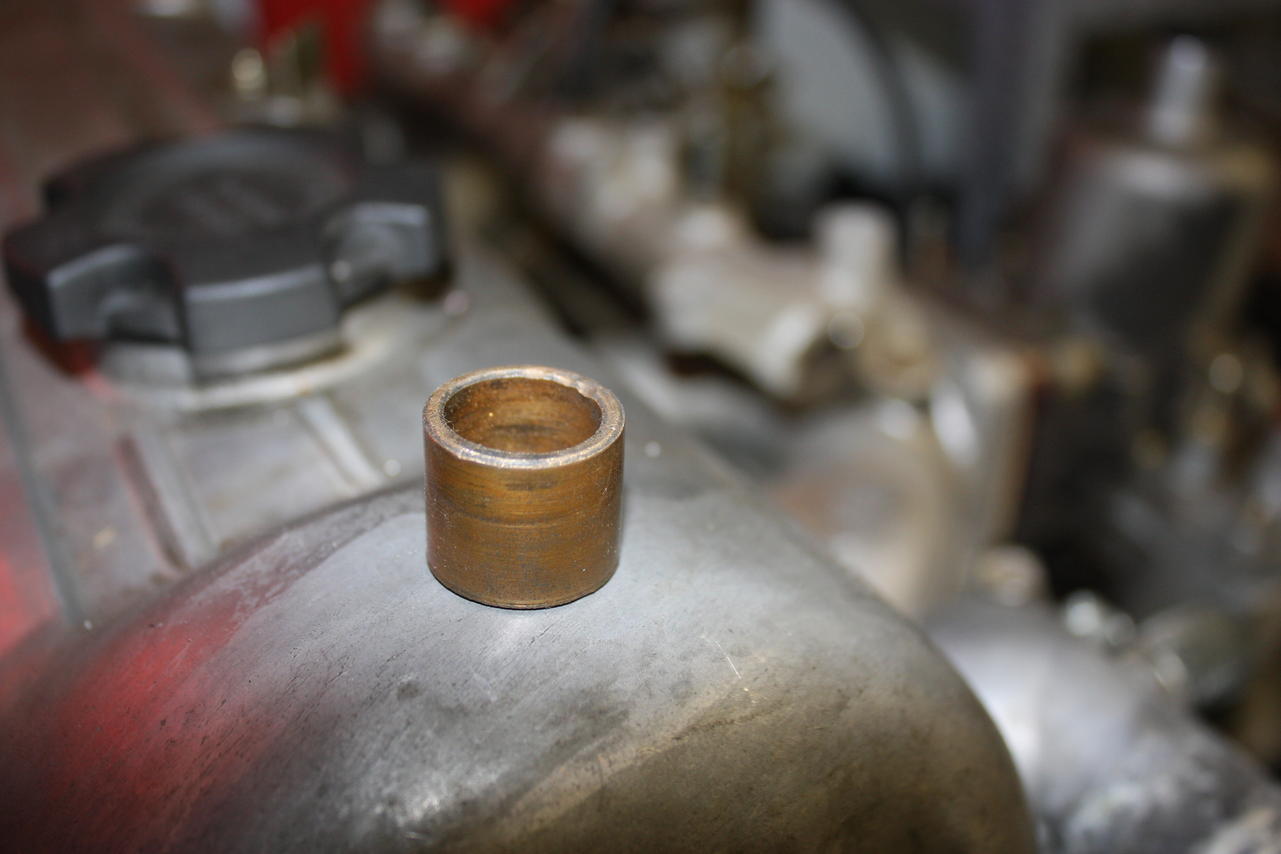

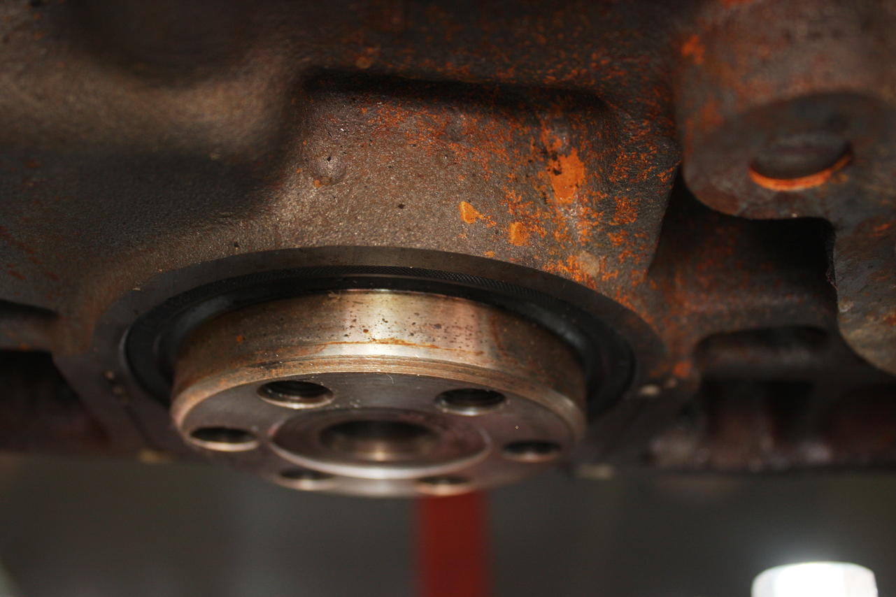

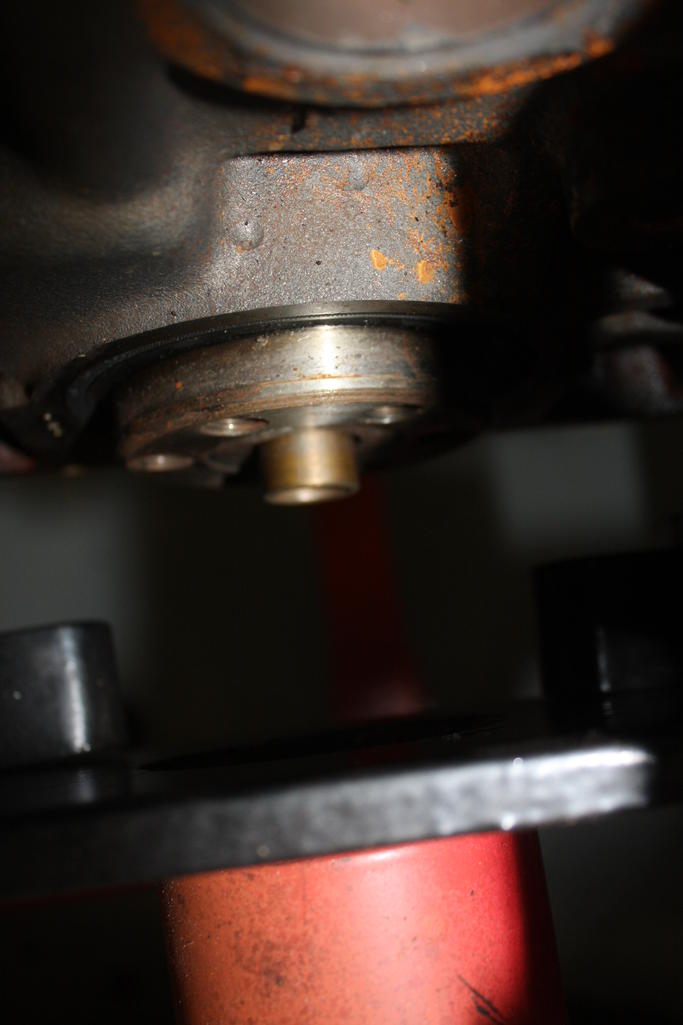

Attached are pics of an automatic tranny crank.....the last pic is with no bushing.....two of the pictures I put the bushing in the hole partially and one pic of the bushing alone. Hope this helps. When installed correctly, the bushing is tapped all the way in. I didn't do that, because I wouldn't be able to retrieve it.
