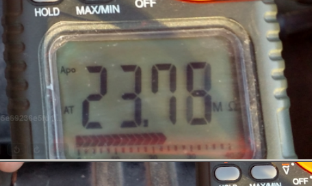

Got some pictures of the engine numbers and distributor cap. It looks like I have one pick up coil, a red and green wire and no black box do-hickey. I took the screws out in the picture but put them back in. I thought the assembly may pull out as a whole but it did not come easily so i didn't force it. I have not checked the vacuum system on it or really done anything except test resistance across the red and green wires.
The manual I have for testing the pickup coil is from a 280zx, however they specify "approximately 400 ohms" and not anything in the mega ohms. If it's "anything substantially over or under, then check the pick up coil." Yet there's not a way specified to test it other than plug in another, at least not in the manuals I have right now

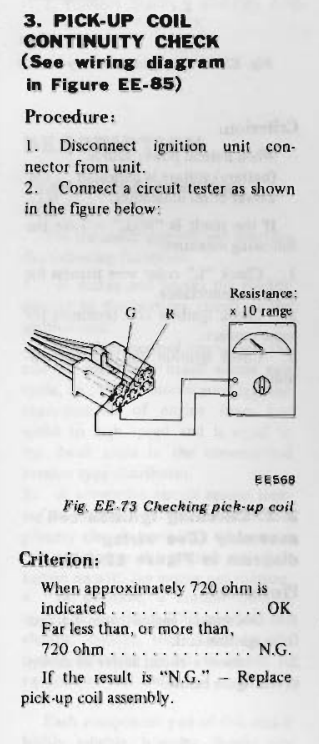

Looks like you have a mish-mash parts.  A single pickup distributor, which is right for 78, but a two pickup terminal block.
If I read your meter right, you're in the Mega-ohm range.  Not the spec. you're looking for.  The test shown in the FSM, for that distributor, is from the TIU plug but it ends up on the same wires you're testing.  Spend some time making sure you're getting good contact with your probes and that the ring connectors haven't broken loose from the wire ends.
The test and spec. is shown on page EE-32.
Darn it.  Just realized I was looking at your terminal block wrong.  It's actually right for 78.  Ignore all comments about two pickup coils, yours looks right, a block for a single pickup.  But the resistance you measured isn't right, it's way too high, essentially open  Triple check those wire ends, it looks like somebody put new ends on, and might not have got them right.

I pulled the rotor off earlier and inspected the wires inside visually and they seemed okay. I discovered the guys before me did some "work" to the pickup coil wire, and by that i mean they cut both wires in half then did a bad solder job and wrapped em in tape. Why? No idea, but I re-did the solder and heat shrinked them separately and still was getting mega ohm readings. Autozone has a $30 pickup coil so I'll grab that and swap it out this weekend if they have it in stock.
