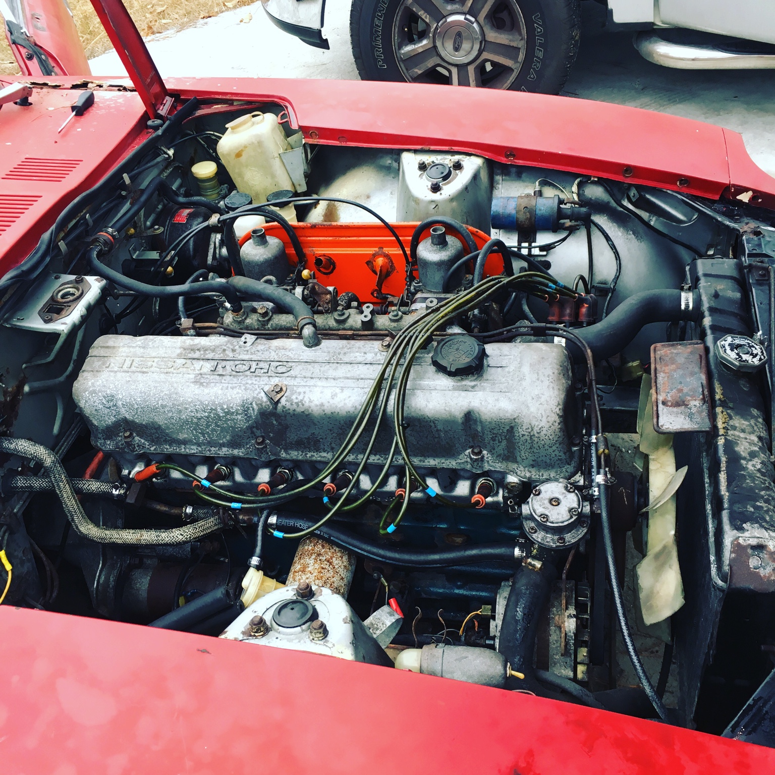

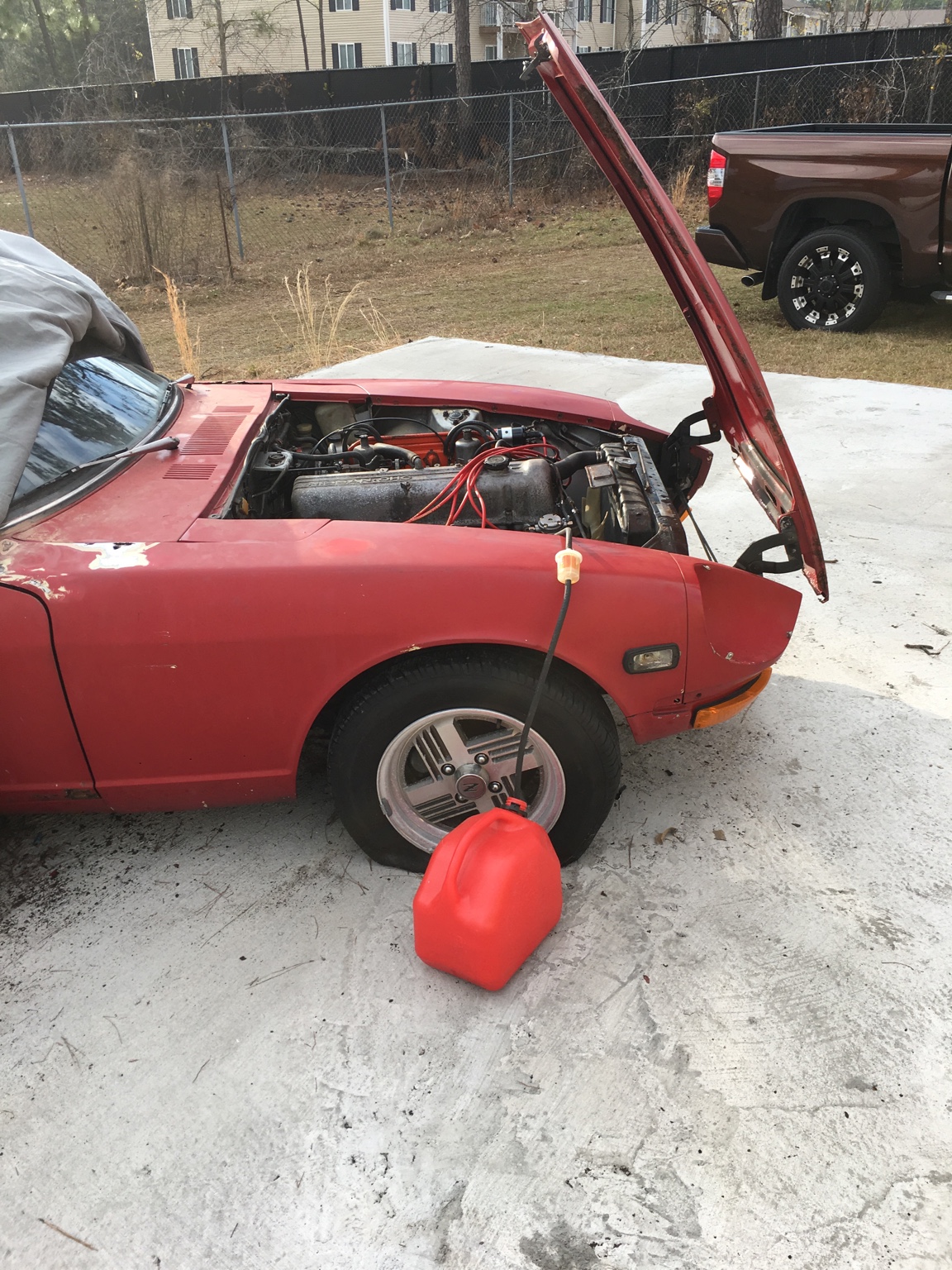

Do you have the air filter enclosure?  It appears to be missing in the picture.  You'll want the air filter in place before running too much air through those carbs.
Also, looks like the car was originally silver based on the paint in the engine compartment.  You might want to look for panel rot on the rockers, doglegs, and rear fender arches.

Front bumper, front fender Datsun emblems, at least one front side marker light.  Got any more pictures of the rest of the exterior and interior?
Dennis
Seriously, it's difficult to gauge the condition of most of the components just by photographs. I would look at this thread and do as much of it as you can:
After that, you'll need to assess the mechanical components. Look at the date stamps on the tires. There's a good chance they are old and rotten. Examine the body above and below thoroughly.
What is your target? What kind of car do you want to end up with? That will drive your budget.
