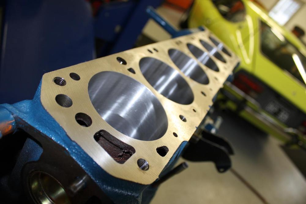

1 hour ago, Diseazd said:
Cliff.....The large water jacket is a common problem area, but any of the smaller jackets can cause problems too:rolleyes:
I see something to read up on.  You're head bolt holes are threaded, mine aren't on that E31.  Is that something you did or do all P79s have that? Thanks!
That's an F54 block not a P79 head :)  All blocks I've dealt with are threaded.....:beer:
Egg on face.  Sorry
I looked at a head in my spare bedroom to see that water hole then looked at your picture.  Looking back those 6 cylinders are a dead give away. :facepalm:
