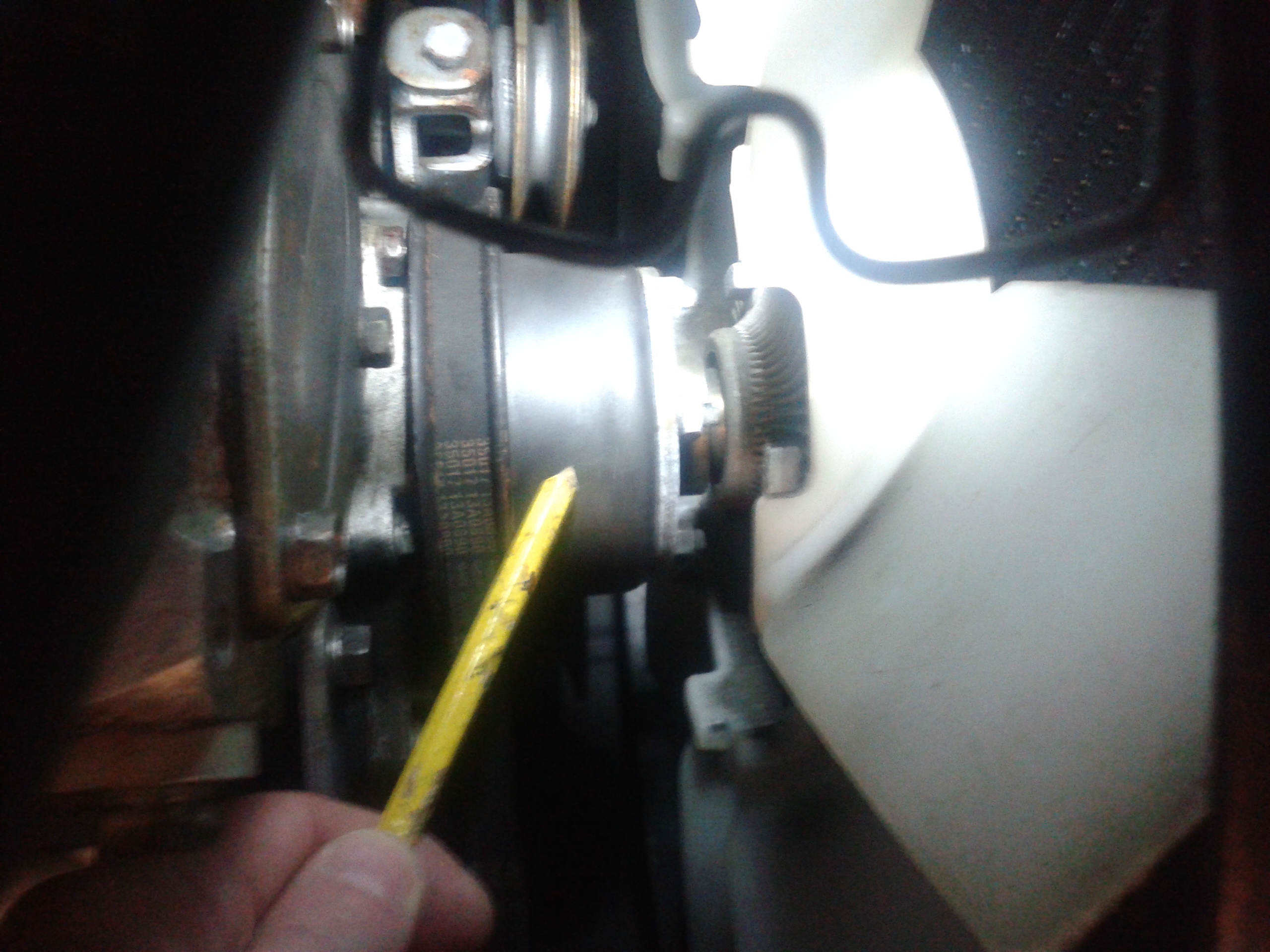

the hub does not budge but i can barely turn the belt not a full 1/4 maybe half of that

Checking the fan clutch is a good suggestion.  See how many rounds it'll turn by spinning one blade by hand.  Shouldn't make a complete rotation if it's cool.  It is oil filled and gets looser with heated up oil.
If the bearings are bad in the pump you'll be able to hear something rattling or the blades scraping the inside of the housing.  I shouldn't have mentioned that, sorry.

i tested the fan and its semi warm but the max rotaion i could get with a good push of the blade was about 5-7 inches ( not enough to put the next blade in the same spot as the one i pushed ) is there a way to test if the bearing is worn/shot? should i be able to hear the rattling when its running ?
