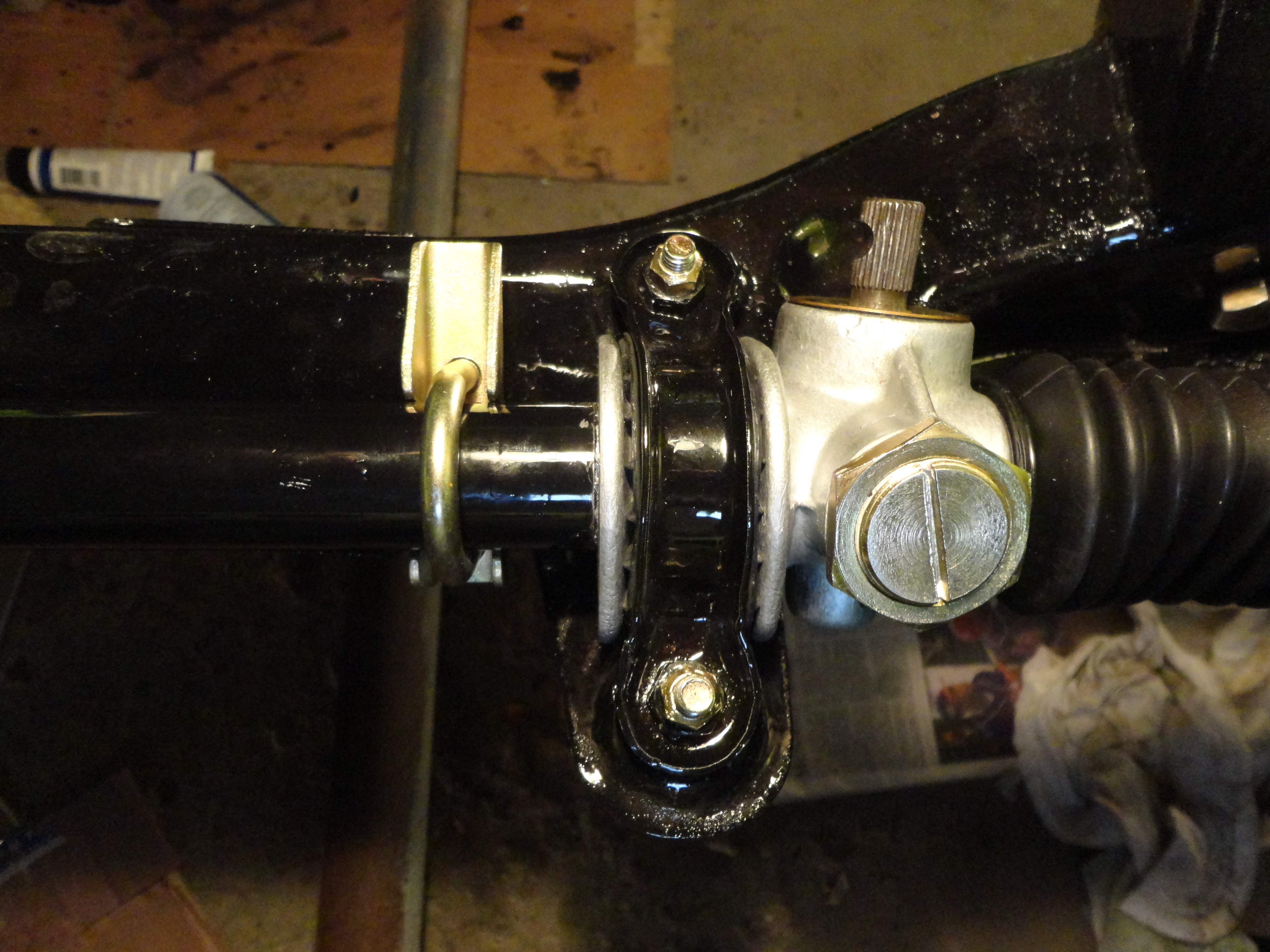

I rebuild the steering rack and installed new OEM bushings on my 1972 240Z.  The passenger side seems nice and tight but the driver side seems to allow the rack to twist somewhat. I have installed the rack stop which only controls rotation in one direction.  Is some movement OK (there seems to be no real up or down movement) or should I apply  a shim under the bushing so it will provide better clamping.

Odd that new bushings don't fit snugly.  In the early 1970s, when Datsun dealerships with parts departments were a little harder to find, a common fix for a loose bushing was to slip a piece of bicycle inner tube between the worn rubber bushing and the metal clamping collar that secured it.  Shadetree maintenance at its best!
