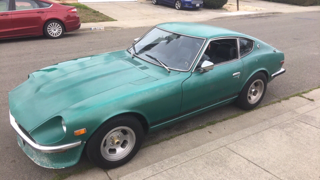

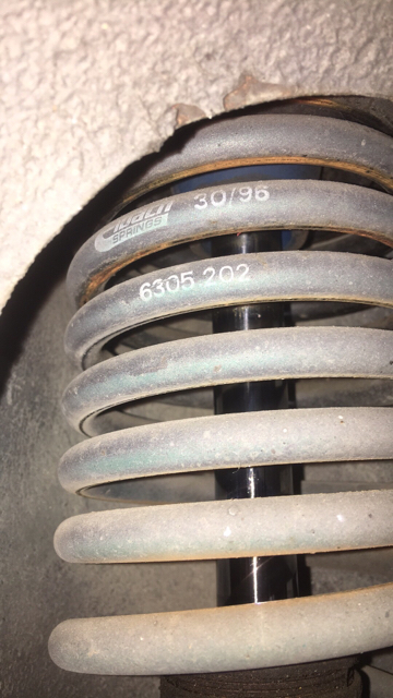

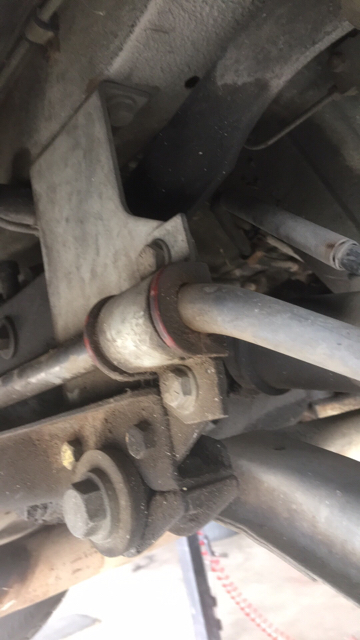

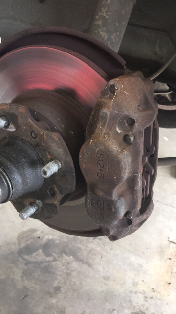

I just bought mine last weekend 9/71 240 completely rust free. Close ratio transmission. Arizona zcar intake and a Holley 4barrel.. eibach on the corners with 4 piston calipers.. I think I found a gem but it goes to show they are out there.. I paid $6k0452BD4E-7484-43CC-B6BE-2BC68DC5374C.JPGIMG_2993.JPGIMG_2994.JPGIMG_2991.JPG0452BD4E-7484-43CC-B6BE-2BC68DC5374C.JPG
