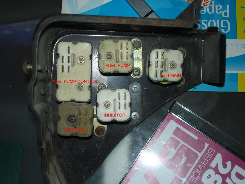

Your question: What is this thing and is it important?
That is the EFI Main relay on the 78 model, (after Aug-77). Yes it is very important.
It looks intact, but the contacts could need cleaning. If its not working properly that will be a source for the EFI not working for sure.
The EFI fuel pump relay is rectangular in shape. See photo (Photo is not mine, but from another thread here under "1978 Z - Fuel pump control relay")

Yes I read that entire EFI book you linked. Pin 1 had power. It was also connected to the coil correctly. I went through the rest of the steps the book said to do. Then Pin 10 had no power, as the book as the book said it should. I went through the wiring and all the relays until Pin 10 had power. This still didn't solve the issue. I recleand all connections and grounds. Nothing. I took out the EFI relay that was in the engine bay and hard wired it. This didn't solve the issue. I cleaned and redid all connections again. I rehardwired that relay and it started up. I'm guessing that relay was just bad and the connector was really dirty. I did follow that book. If you read the par of the book that helps with the no starting issue you'll see that I followed it step for step
