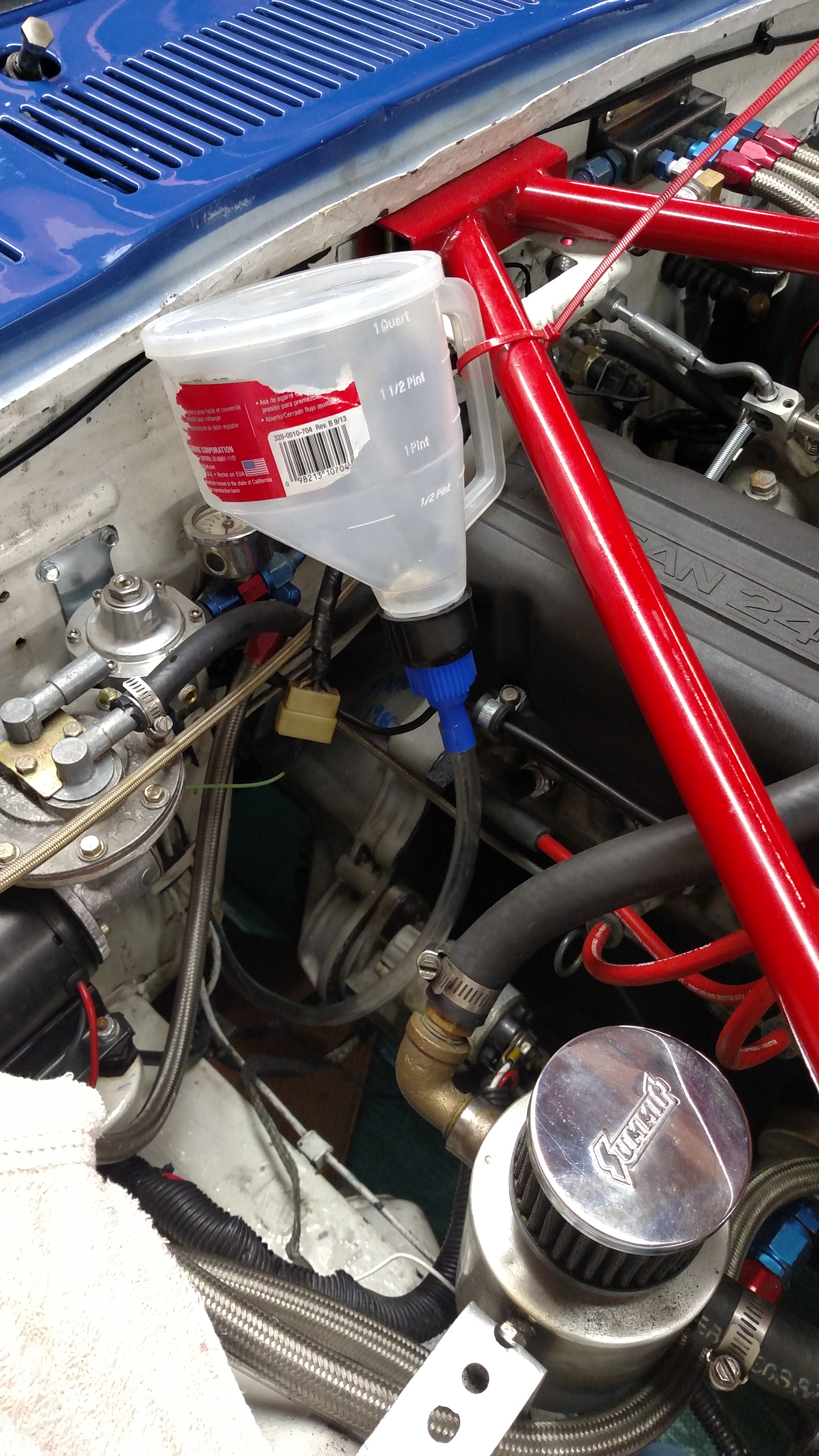

As to getting the filler and drain plugs loose, the drain is the easiest with a 1/2-inch breaker bar and a short section of pipe for leverage while the filler plug seems to resist just about anything you throw at it. With the car on jack stands I use a small Sears jack that has a cup which hold a 17mm wrench within the cup and the other end on the plug. Jacking up the wrench usually does the trick.
Now filling can be an issue especially if you are under the car pumping away waiting for gear oil to spill out. Instead I fill from the top using just the right amount of gear oil which I measure out before starting.
