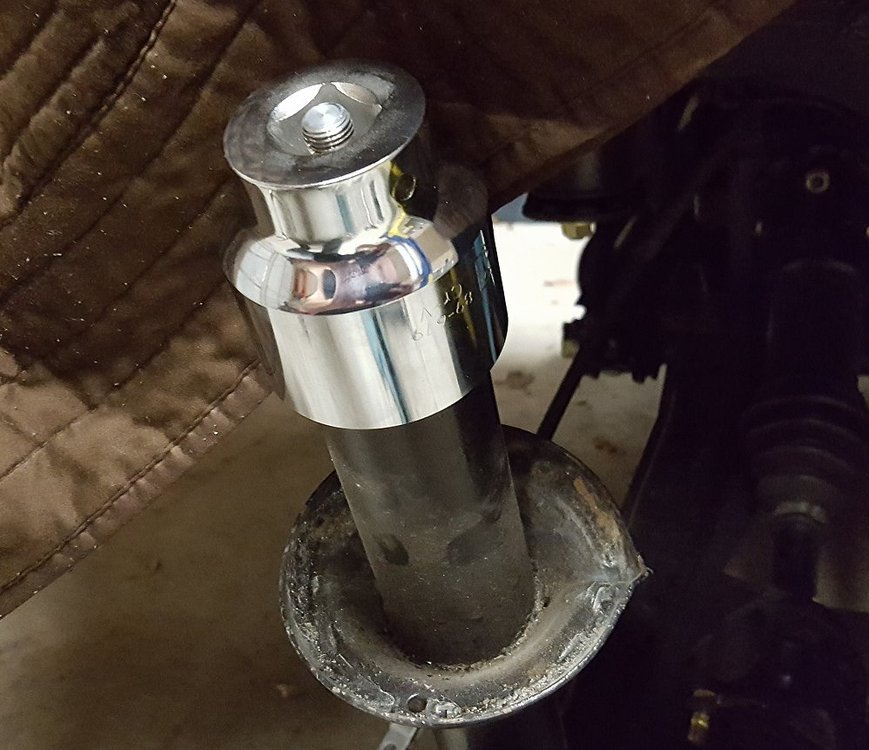

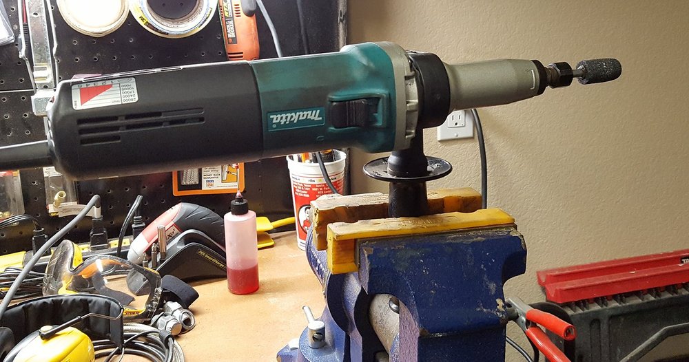

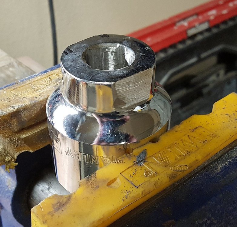

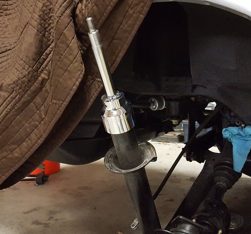

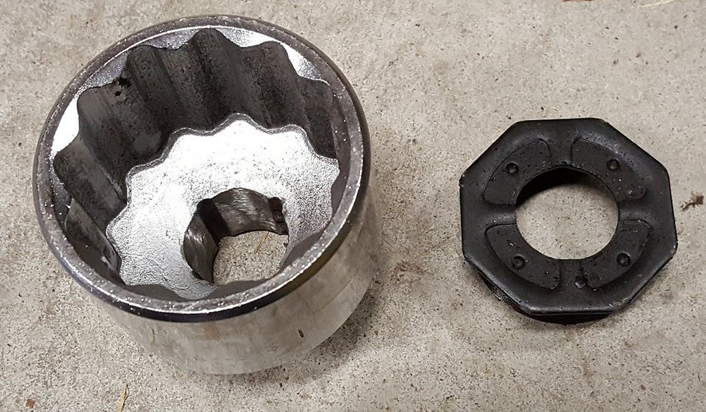

So I purchased a 12 point 2" socket made by Stanley on eBay for $21.50 shipped.  I verified it fit as I could easily push down on the strut piston.  The 3/4" drive opening was already close to being big enough.  After about 30 minutes of enlarging the hole using my "worth its weight in gold" Makita rotary tool, it would now slip over the piston.  Next was to grind some flats on the socket so I could use a pipe wrench to turn it.  Threw it on and with one good turn, the glad nut was loose!  Once I off I verified there was no damage to the strut tube or the gland nut itself.  You can see in the last picture with the gland nut in the socket that the corners are not exactly aligned in to the socket.  I am a little lucky as the entire suspension on my car was rebuilt in the past few years.  Why the strut insert has already failed on stock springs is another story. If your gland nut is really stuck there is a decent chance the socket would slip.  Going down one size may help with this.  Anyway, that was my solution, it worked, and thought I would share.

Thanks for the compliments guys.  The last time I did this I used two big pipe wrenches and ended gouging up the strut tube and pretty much destroying the gland nut.  The socket is much more precise and like all specialty tools, it is an investment.
