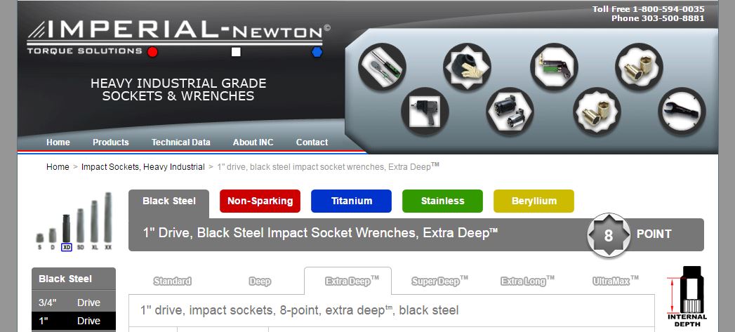

This company, near Denver might be worth checking ... appears to have 2" 8 point sockets in 3/4" or 1" drive.  Standard length, deep, or extra deep.  No idea of the cost on their web site, they have a 800 number or email.   I am guessing it will be expensive.
