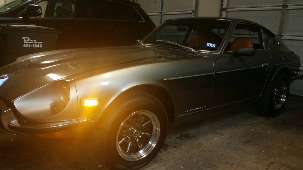

Just wanted to bring this thread to a successful close. Finally had a chance to go on a test drive and yes it was the tires. Perfect clearance with both small tires up front and it did appear the back wheel hub was thicker than the front making the problem worse. I am located just outside of Austin in the Lakeway area. I cannot thank everyone enough for helping, this blog is the best, just goes to show good people drive Z's. I am reliving my youth, as I am sure many of you are as well, it was the car I drove in my 20's but rust and milage caught up with my first one when I did not have the money to repair. Here is my new one that I am going to slowly bring back to its original, if not better, state.
