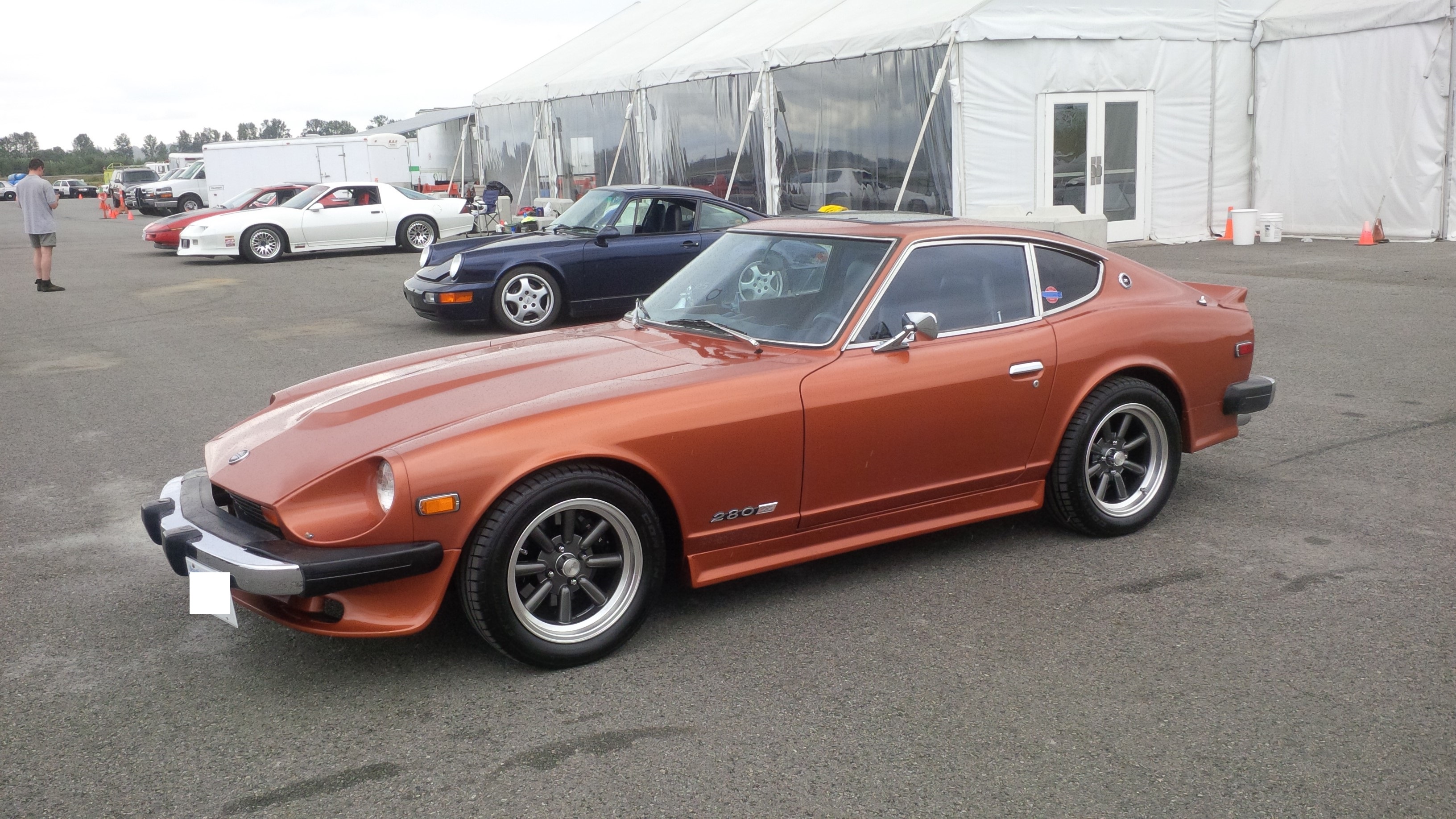

This is interesting. I have Eibach Pro's in my 280Z and it doesn't have a nose up attitude at all. New KYB shocks all around.  Have Conti DW 225/50x16's on Rewinds. 16 x 7. As you can see the front is lower than the back. Might be because my car is a 280Z with Park Benches up front and factory AC. Do the 240Z's and the 280Z's have the same Eibach kit numbers. I haven't checked. I do know that I have the 01's up front. Currently building a set of T3 DIY Coil Overs for the front. In the rear I will use the front Isolators to drop it down a bit. May go coil overs on the rear next year... but not this summer. Reason = &%#$@ Spindle pins!!!

This is interesting. I have Eibach Pro's in my 280Z and it doesn't have a nose up attitude at all. New KYB shocks all around.  Have Conti DW 225/50x16's on Rewinds. 16 x 7. As you can see the front is lower than the back. Might be because my car is a 280Z with Park Benches up front and factory AC. o the 240Z's and the 280Z's have the same Eibach kit numbers. I haven't checked. I do know that I have the 01's up front. Currently building a set of T3 DIY Coil Overs for the front. In the rear I will use the front Isolators to drop it down a bit. May go coil overs on the rear next year... but not this summer. Reason = &%#$@ Spindle pins!!!
Chickenman, I also have the Eibach Pro's on my 280z.    The trick to getting the stance level for me was ... to use the 240z isolators which are shorter, on the rear struts.   I have 205 55 16's on Rota's during the summer.
