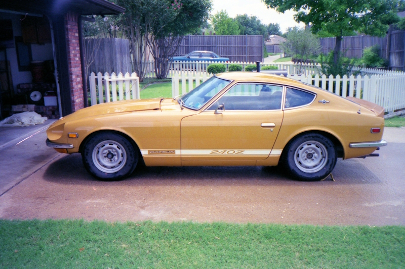

Yeah, always fun to get a short ride down memory lane and you know all about Safari Gold!  This is the car just before the teardown.  You can see it is noticeably lower by looking at the lack of opening at the top of the wheel arches and the tires.  I could barely get fingers into the gaps.  Steel wheels painted silver made do for my "alloys" back in my poor days.  The Mulholland springs eventually went to one of our forum members up north for the price of shipping.
