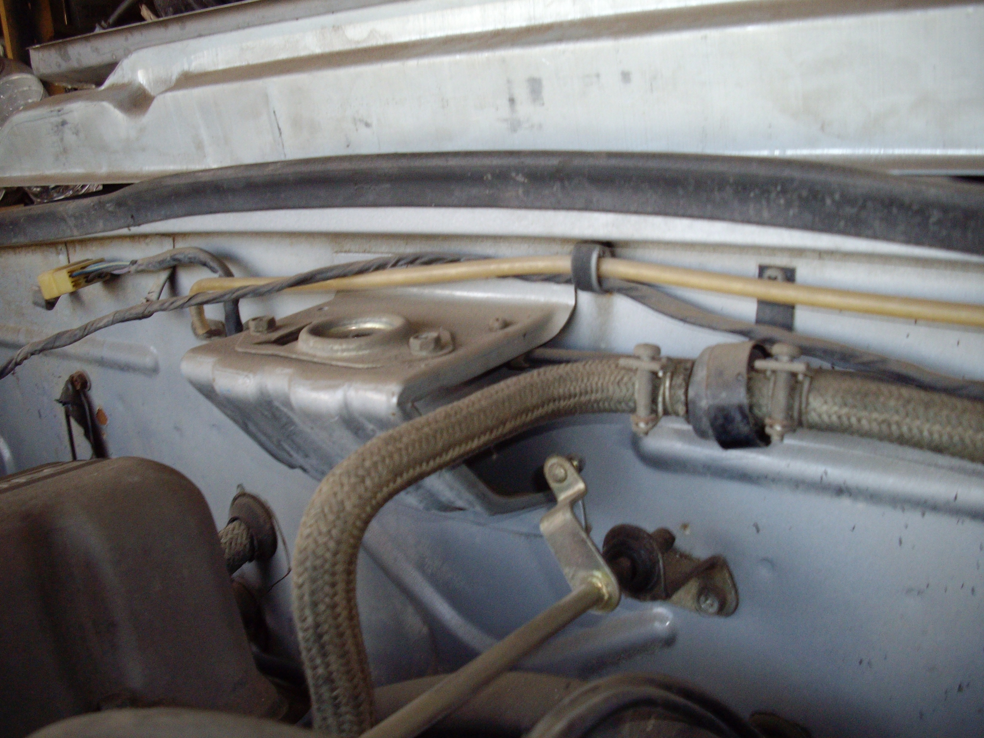

today, I was about to glue the firewall insulator to the inside of the car i'm restoring, and I noticed that on one of the cars, looking from the engine bay... the rubber insulators that go around the hoses for the heater core have the cone facing outward pointing towards the front of the car. And on another one that i took apart, the cone is facing inward.
These are the items I'm referring to:
does the pictured face of these grommets face the engine bay, or face the interior?

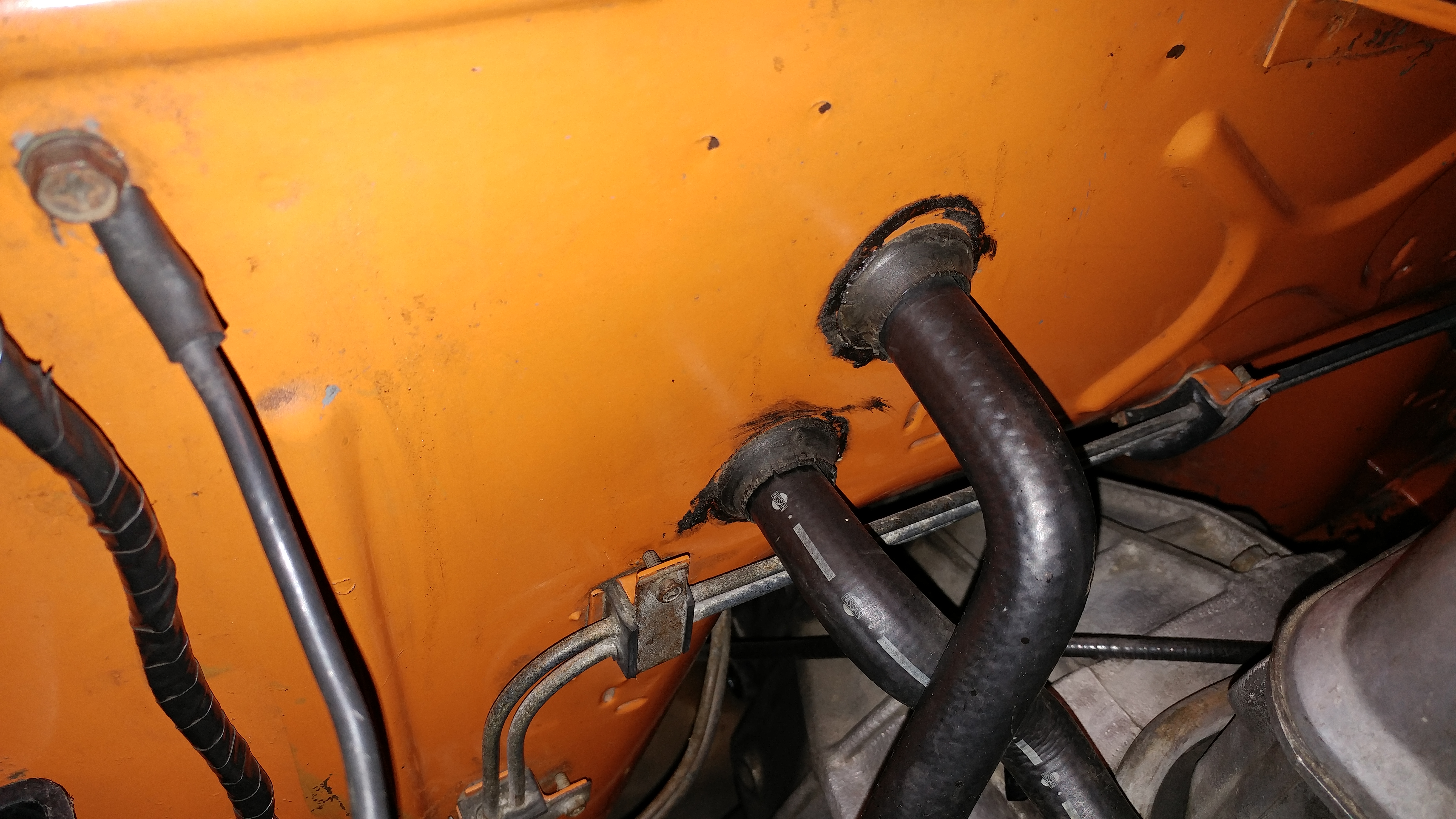

Another photo:

Mine are installed like the second pic and they looked like that when I pulled the car apart for resto.  The normal install for the hoses would be to push them thru from the engine bay.  If the taper were on the engine side, it would have a tendency to fold under as the hose passes thru.
Mine are like this. As far as I know these are original and have never been removed.

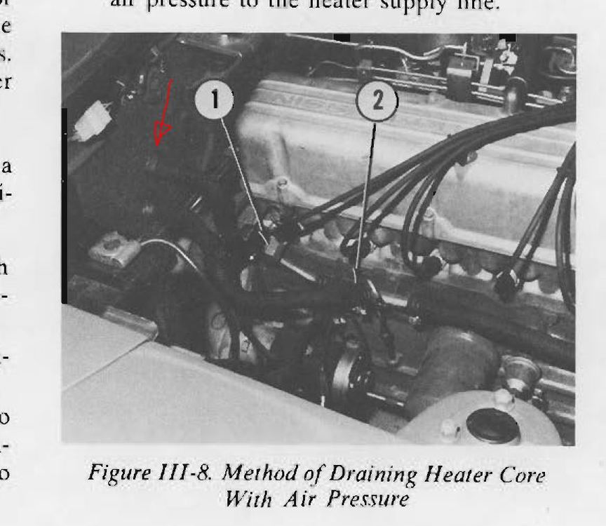

Below is the best pic I could find from the 1971 FSM supplement, it's hard to see but to me it looks like the tight fitting end of the grommet is facing out.
20170322_165110.jpg.

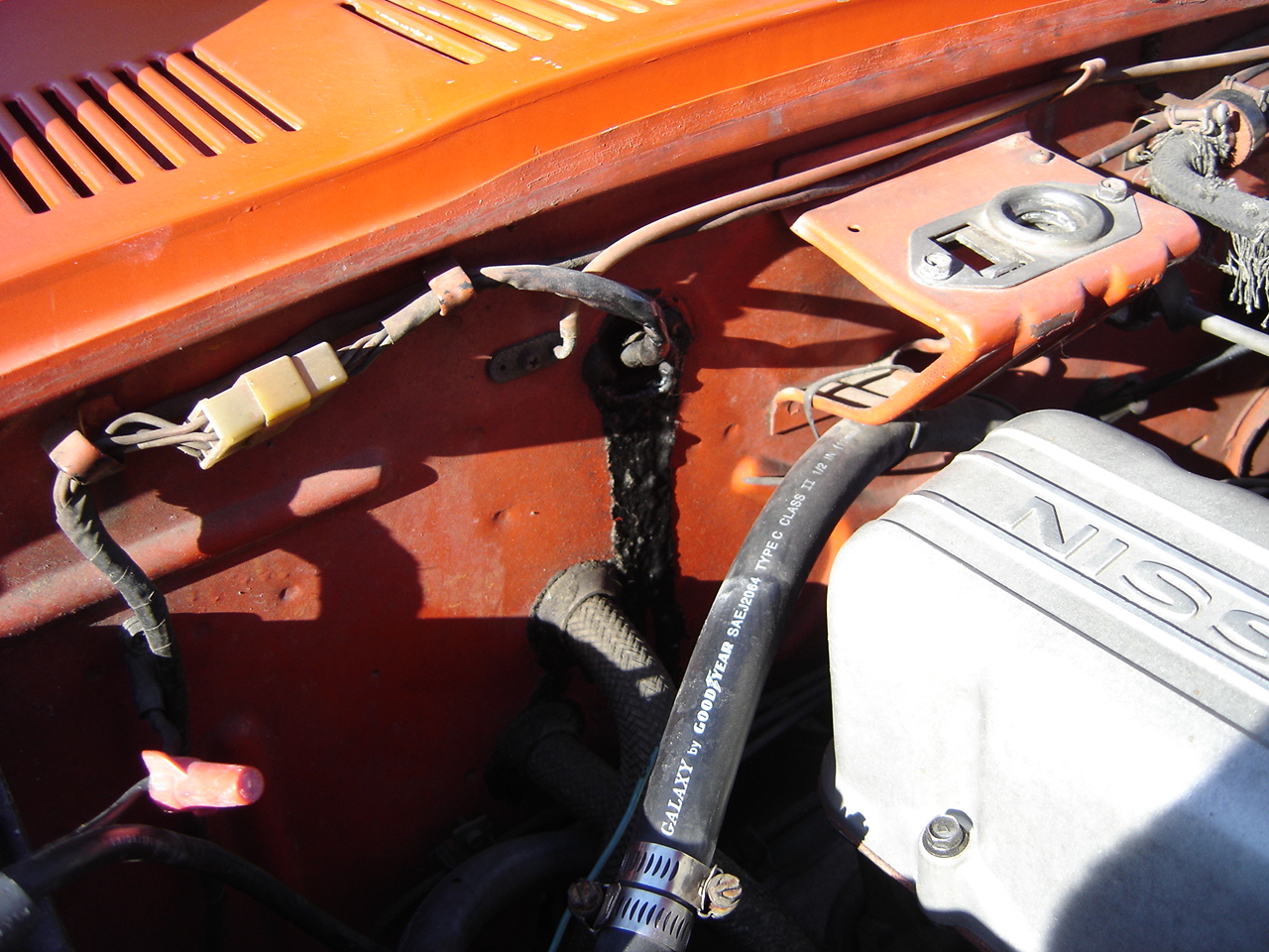

I just managed to find a set of photos from the tear-down of this particular vehicle that I did not photograph, and low and behold, tucked away in a folder- unbeknownst to me... they were shown like so:
IMHO, it looks way better facing the opposite way, considering the other various grommets don't protrude into the engine bay and i like the tucked in look.
But in keeping with the theme of installing it how it came out; if it seems like it's not wrong and will work how its shown in the tear downs... that's what I'll do.
