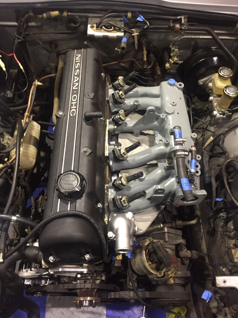

Thanks for the tip. Here is a little mock up pic. Lots of work ahead.IMG_1491263168.335922.jpg
Did you get that from RossiZ?  I'm thinking you did but don't remember too good.
It looks really cool beside that black valve cover.
Yes I did, I had it powder coated and the EGR welded up.
I thought something looked odd with the webbing on there.  It's not an N-42 but a N-47 with the EGR welded up.  Nice! default_smile.png
No webbing, that's the shield, look closely, it's a slightly different color. Not sure I like that though.

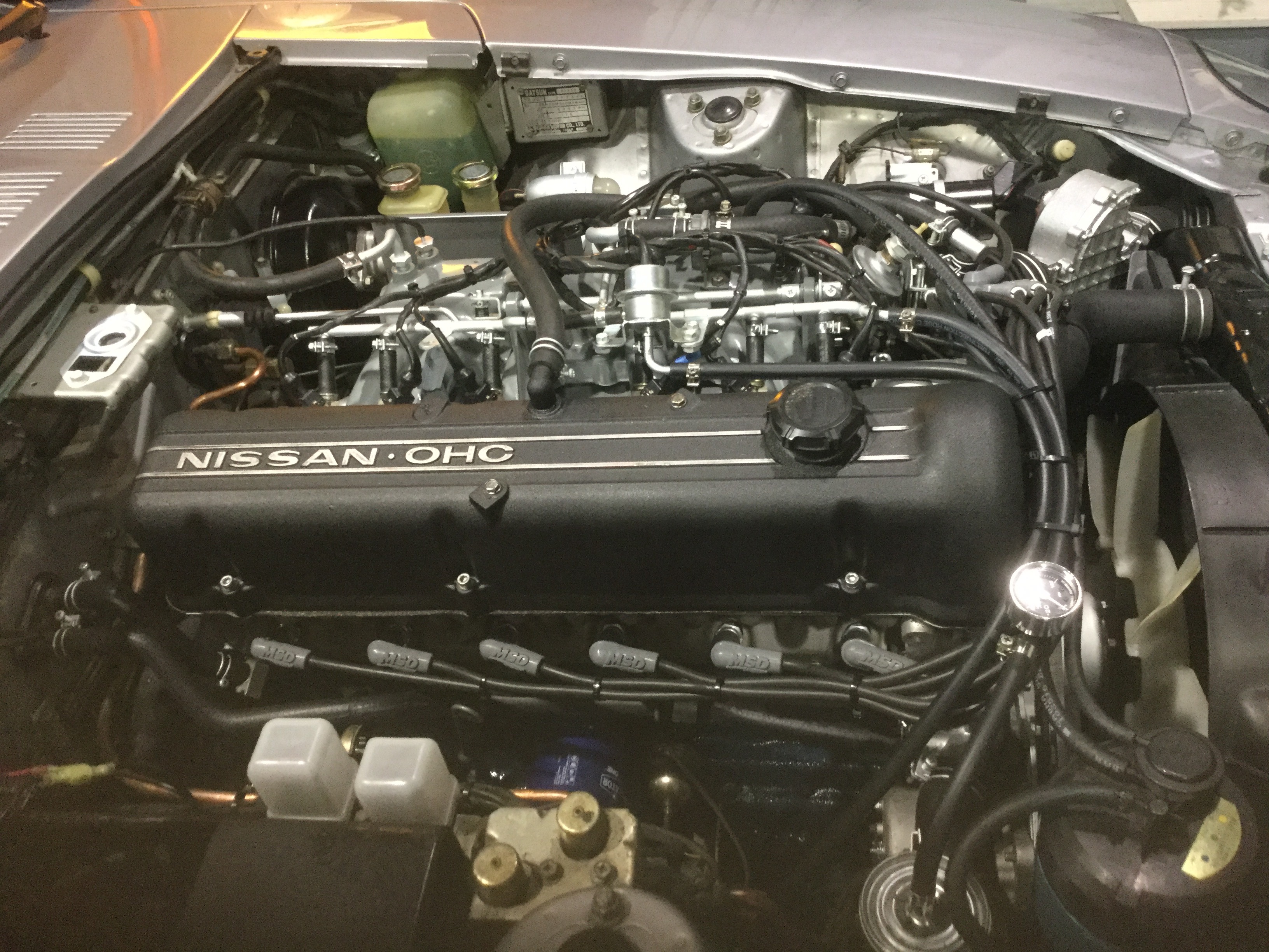

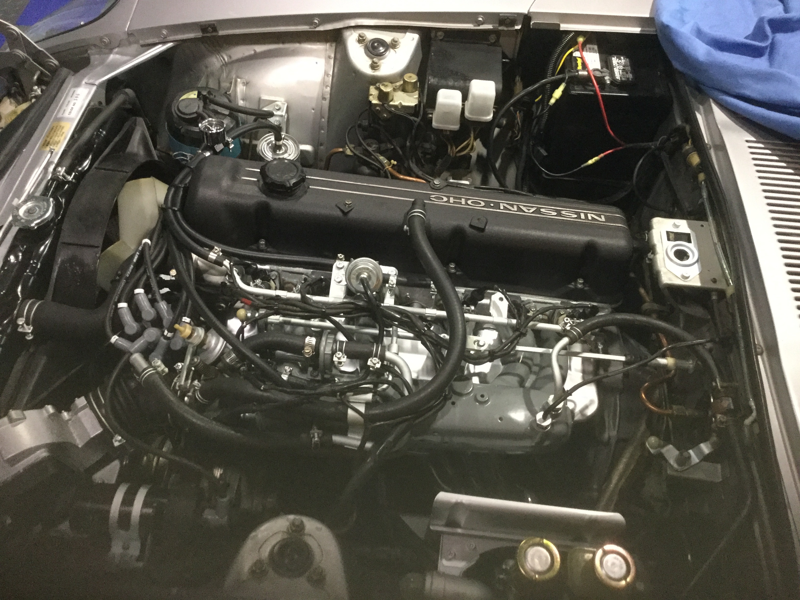

Finally I have it mostly put back together.  I had all the metal parts Zinc plated which was a lot of work, fortunately I had two of everything so I was able to disassemble the car after I got the parts back.  I didn't have to trim any of the heat shield with my header installed which was great.
A few details and then the hood can go back on and off to the muffler shop.  I purchased a 2.5" exhaust system from MSA awhile back and it hangs way low back near the diff.  I suspect I will just have to have a custom piece welded up to get it right.
Great looking engine bay! You did a fine job with that.
Those 2.5 exhaust can be a pain, taking it to a shop isn't too expensive.  I paid $50 to have mine tucked up better. There's that cut out on the driver's side of the differential that it fits in but that wasn't made for such a larger pipe.  I fought with mine then threw in the towel and the $50. Good investment for me. Good way to spend $50, I mean. That's just a couple of days of beer. LOL
