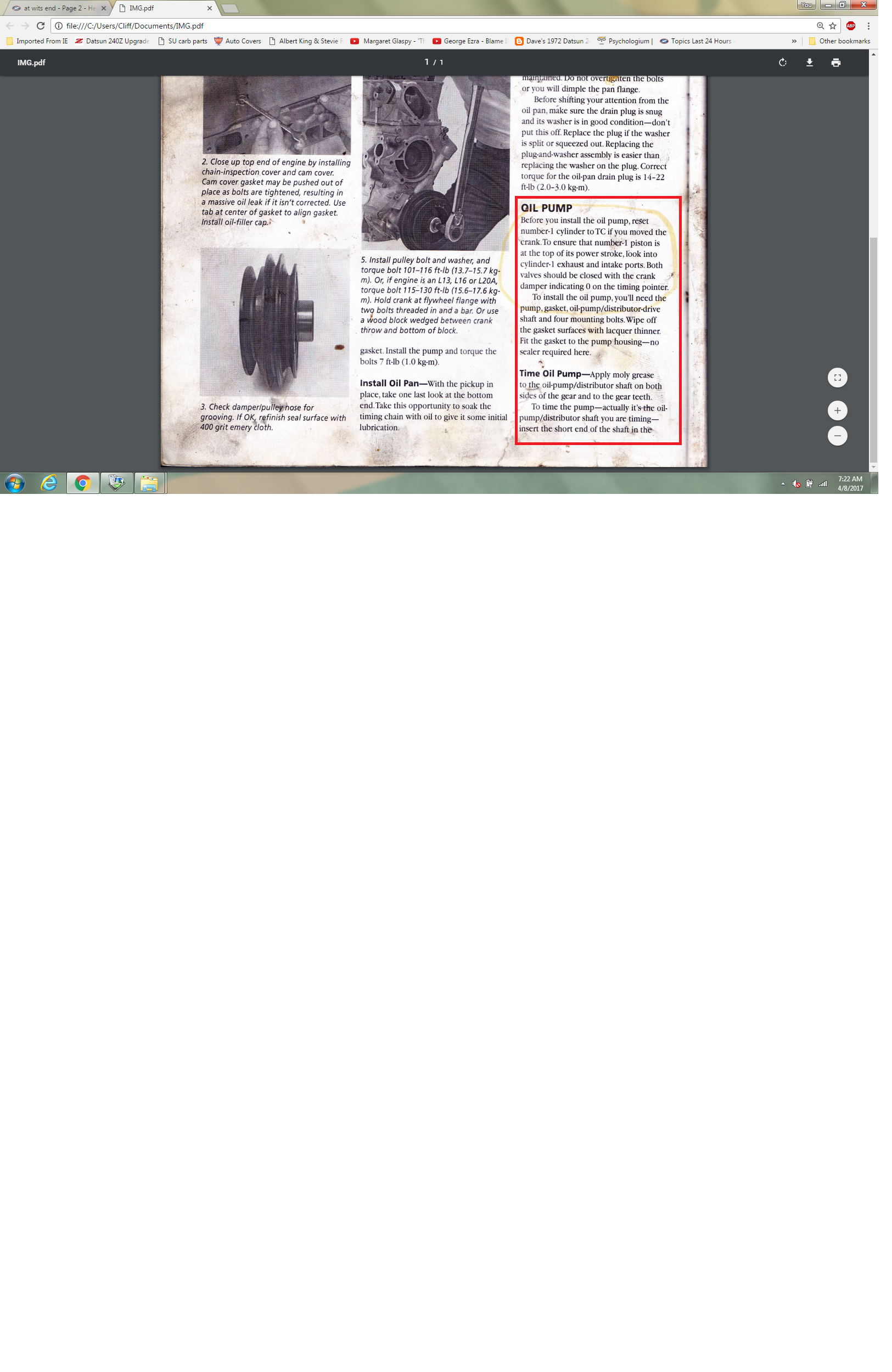

i have a feeling that this is possible. i tried installing the oil pump (with the marks lined up) 4 times tonight. every time it came out like shown in the picture above. i have another shaft that i will try tomorrow. on another note, i discovered that my brand new flame-thrower coil is putting out almost zero spark.

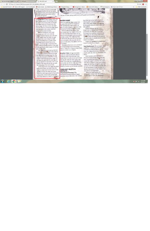

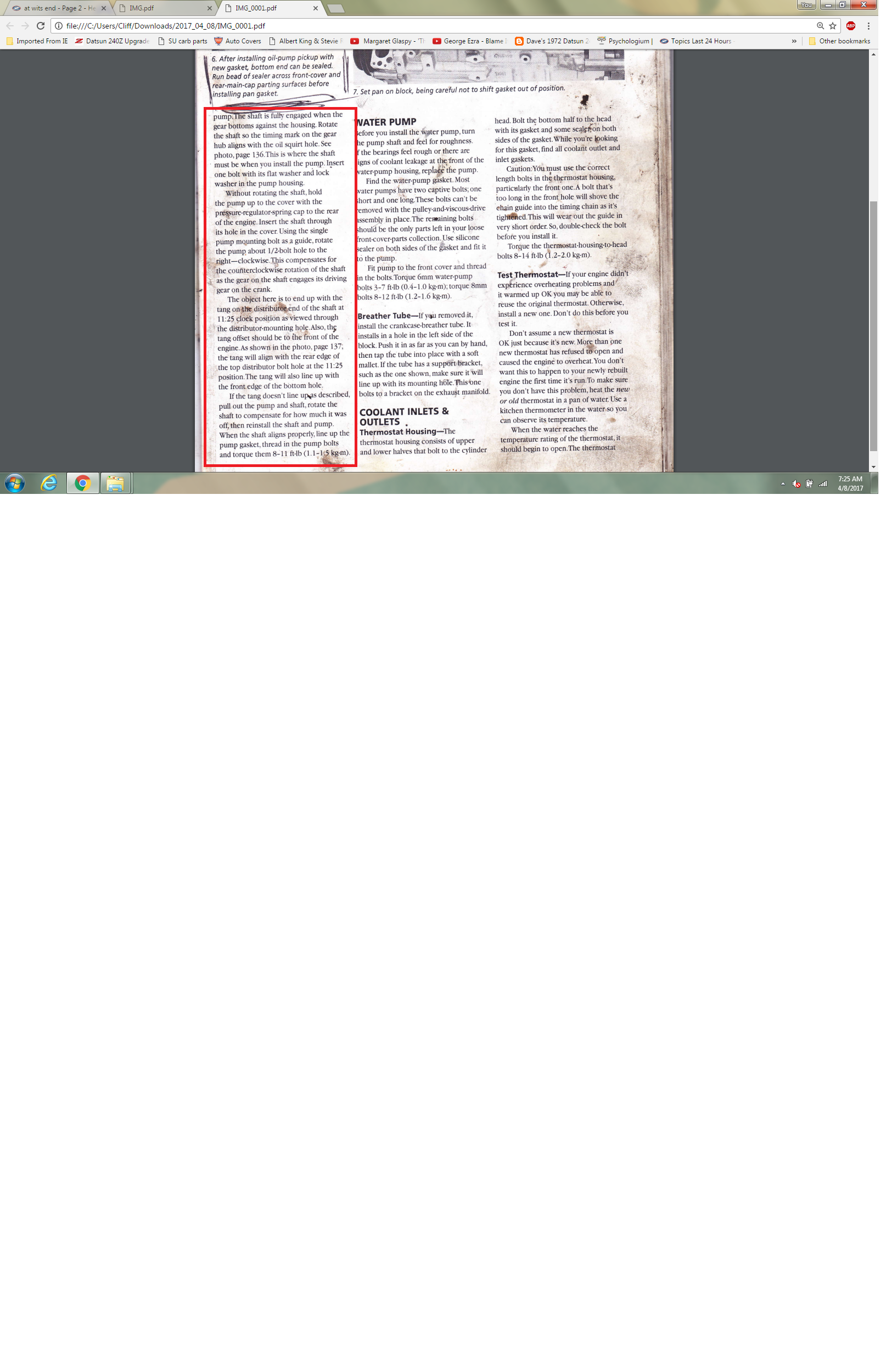

There's a trick Tom Monroe uses in his book I can scan tomorrow morning for you to read. It helped me get mine right on the first or second try. Something about putting one bolt in and turning the pump body to cover the other bolt holes then push it the rest of the way on. I'll get it for you to read over and see what you think, asap Saturday a.m
