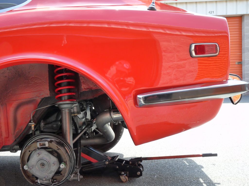

Looks nice....Mine won't tuck up that tight with the piping that came in the kit. And I have to use the offset pipe as the intake and the center pipe as the out pipe to make it fit at all.  Had help breaking it down today and could not make it fit any better than the photo above.
Motorsport told me the center pipe "HAD" to be the intake but when I called the manufacturer of the muffler Xlerator Big Max they said not so!  It is the same blowing either way.  The manufacturer also said the noise I hear could very well be a manufacturer defect.....so I will see if I can isolate the sound and get a video documenting to see if I can get a replacement....If not we will run this one for awhile and then get another....Good times!!!
Sorry it didn't work out for you.  It was a major PITA to tuck it up nicely, many cuss words and beers plus the use of every spare tire jack that I had to hold it in place.  You could run by a muffler shop and see what they'd charge to tweak the muffler.  It shouldn't be much, you've done the hard part already.

I had to cut the top hole or two off the rubber on the rear hanger to get it tucked up in there. It wasn't easy either, I cut it with a hacksaw.
same here. mine is very close, but i still plan on taking it to a shop and having them do the final adjustments

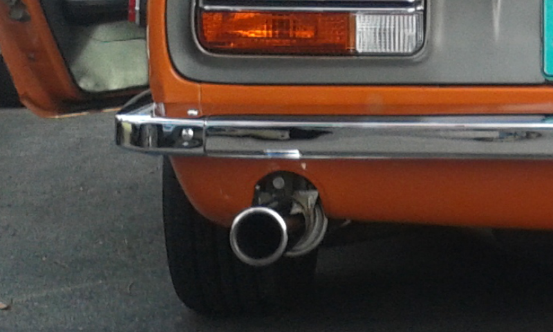

If you push the muffler way up in the open cavity, it looks nice but it gets much louder in the cabin.  A long round muffler would be much better than an offset oval/rectangular one to minimize this.
Here are photos of the muffler tucked in nicely but very loud.
