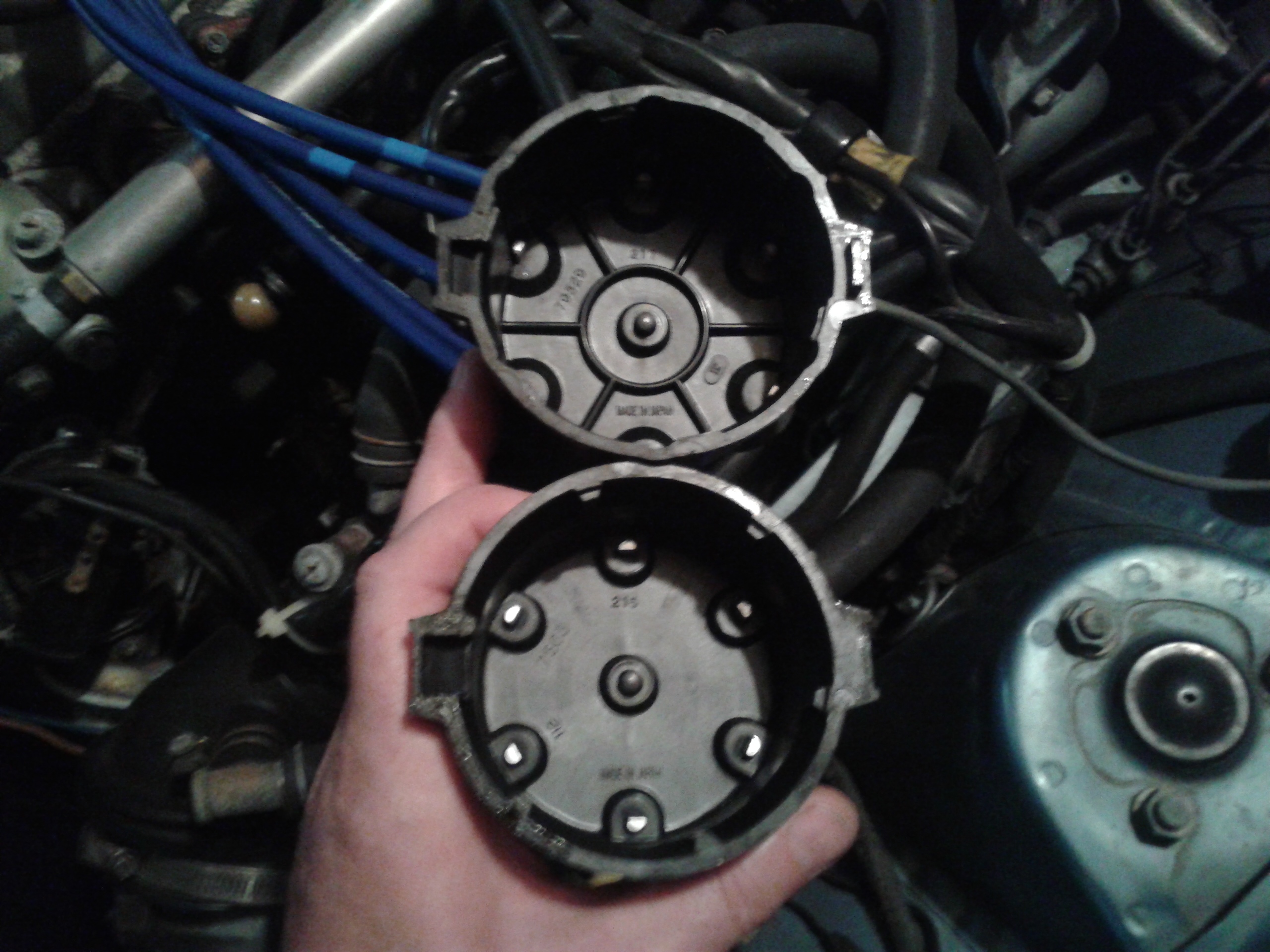

I ordered the wrong distributor cap! the one I have now is for a 1977 280z and the distributor cap needed is for a 1980 280zx distributor. the 280z fits fine tight no wobble  and ignition timing has not changed . does anybody know the difference between the 2 cap as they have different part #s. was ordering plugs for the 1977 and did not change the year for the distributor cap and rotor.

I made the mistake and ordered the 1977 280z  cap and rotor instead of the 1980 zx cap and rotor from rock auto.  the cap and rotor fits tight no play seems to fit like it belongs there and car runs great just seems fine. I would just do not know what the difference is being beck arnley has a different part # for the 1980 zx dissy

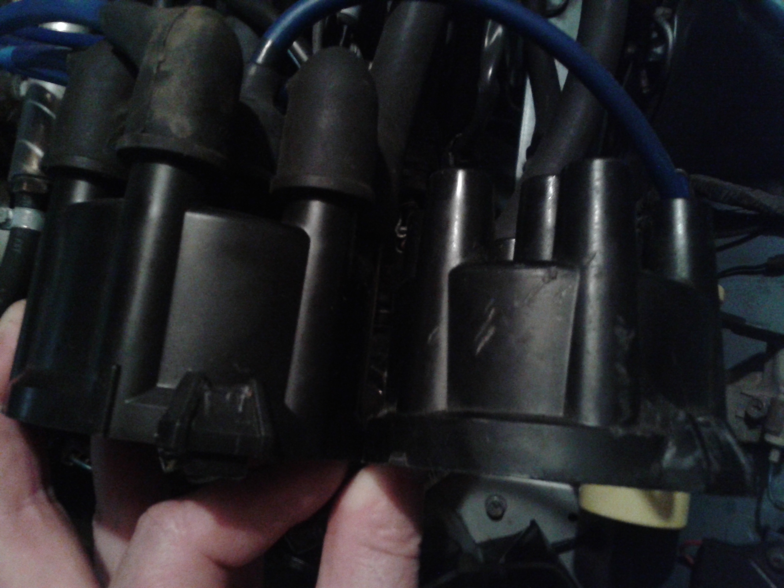

Not trying to be d*** but my '77 cap will not fit my ZX distributor. It's a good bit shorter and I'm unable to to clip the side hold downs on. But if you have the '77 cap and rotor I guess they will work together, if your car runs, I can't argue with that.
I apologize for doubting you.
Cliff
The ZX has the blue plug wires attached in these photos
