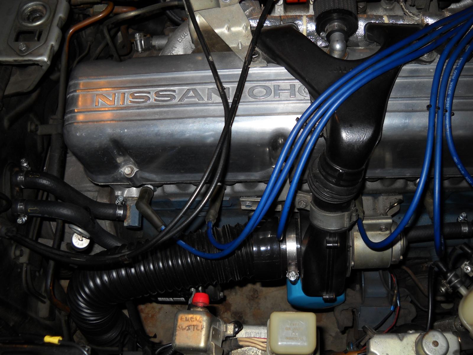

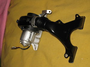

Well if you add choke it clears up. I read that some people in Australia where there is also high temperatures are installing a 280zx injector cooling fan as per the pictures attached. Could this posible help besides from adding a layer of thermo-tec insulation adhesive foil to both of my heat shield extensions?
