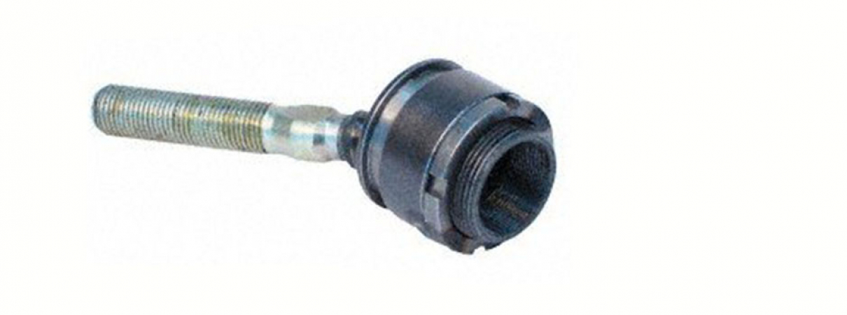

I keep seeing places say that the ZX inner TREs work on Zs, but that can't be right. They look totally different (https://zcardepot.com/tie-rod-end-inner.html?gclid=Cj0KCQjwsNfOBRCWARIsAGITapav6ihEQy_Zt8wIeCAtvXUYBShoFOken7iHYZfG6FZiOdqNRCIFvVMaAlgkEALw_wcB). Anyone know for sure, because you can get them for $18.
So I have used the Rare Parts ITR ends on a couple of different rack rebuilds and they work great.  All of the ones that you see from T3, Z Car Depot, etc are all the Rare Parts ones.  I can definitely vouch for the quality and performance of the part.  Looks a little different from the OEM one but works perfectly.
I can also tell you for sure that the ZX TRE do not work on S30's.  I purchased a set from Rock Auto that were listed for the S30 but turns out they were for the ZX and are nothing like the ones for our cars.
I also know that you can get the Rare Parts  ITR ends for around $60 but I'll have to look up the site where I purchased them  Let me know if you are interested in that information.
