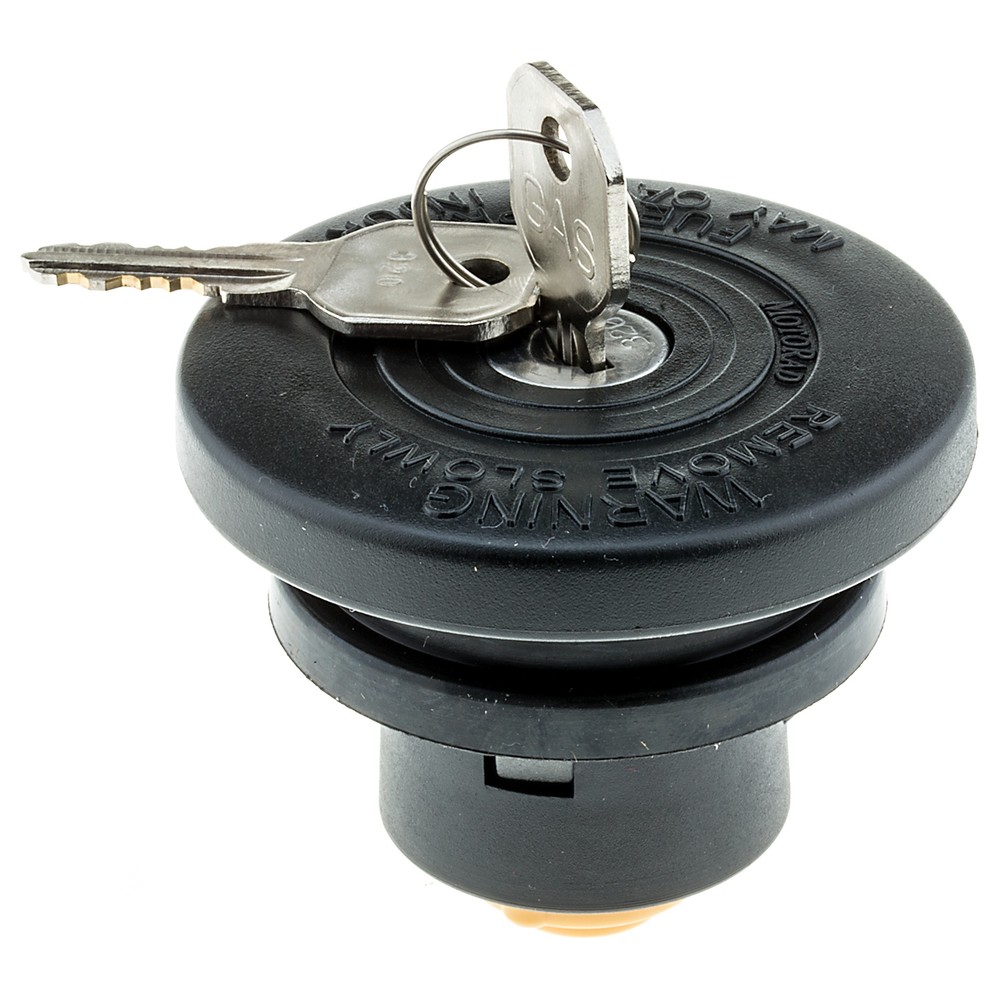

Does anyone know what the vent pressure on the original caps should be? Because when I got my new one I hadn't checked the difference if any in the caps
The factory cap is not a vent.  It lets air in, not out.  That's another reason that zKars' suggestion is probably on target.  Your new cap is the wrong solution to your other problem.  Besides air coming out around the filler entrance, air also escapes through the vent hose up to the charcoal canister in the engine bay.  Sounds like your venting system is screwed up.
Not to take away from the suggestions but I'm curious about the gas cap.  It looks like it is a screw in type.  Is it or does it look like this one from ebay? Where did it come from?
It looks exactly like that one
Did this problem ever happen before the gas cap?  The reason I ask is that according to the specs it says it in not compatible with the 77 Z.  It may not be letting any air in.  It may just be adding to the problem.
However it does not explain why it takes so long to add fuel.  LIke ZH mentioned, make sure the flap indicated with the red arrow opens with the push of something like a screwdriver.  It should not take very much effort.  If it doesn't  push open that would be your filling problem.
Ok awesome. And yes the fuel did spill out and had a hard time filling. I will take a look when I get home and hopefully I don't get covered in gas
