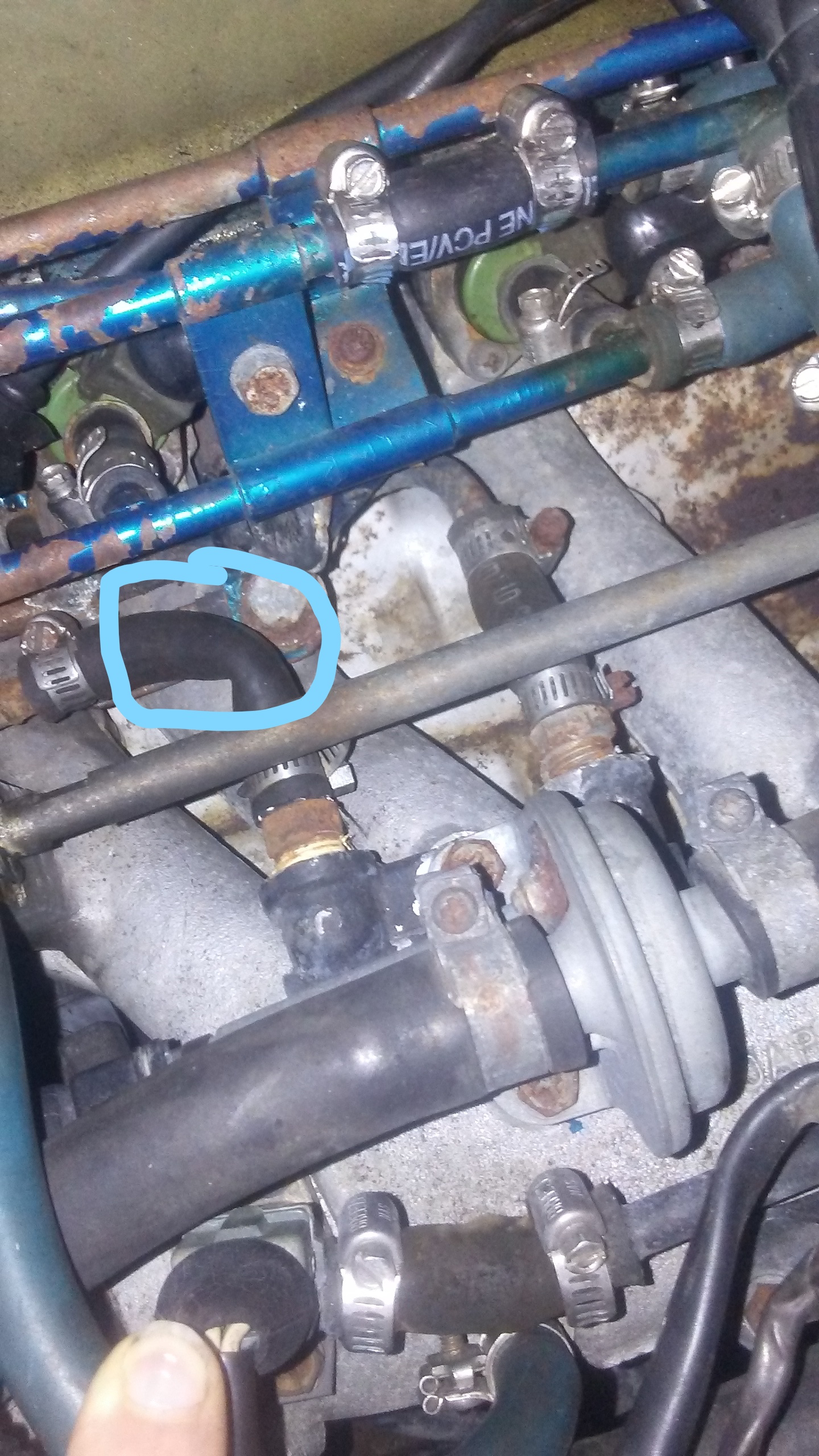

Hey everyone an update on the car. It was last tagged in 2014 so it has not been sitting for to long. The plate in the door jam is missing. I will try to ask the seller if he might have it but I do not think he would have it. I flushed the old gas out and added sea foam to premium which it has been running better the more it runs as well as puttering a new fuel filler in. The fuel pressure was around 38lb is believe. The rotor, cap, and leads all look pretty fresh but the car came with new ones. I have new plugs as well but the ones in the car look pretty new. I already planed on changing all the fluids but have not changed any yet. I tested the AFS by hooking a multi meter to it well it has power and the voltage increased the more it moved counter clock wise. I also want to check the timing on it. I did notice that when I lift the dip stick up that nothing changes in the idle (not when it was surging). I still have not changed the vacuum lines yet, Every thing seems to be not be checked most of the bad line is after the vacuum canister bottle (which is bypassed) and the heater/A.C. controls. Amazon has some regular stuff that around $15 for 50 feet, would that be fine it has a four and a half star rating or should I go a head a buy the silicone stuff for $2 per foot. I also noticed that there was a hose from the radiator to a thing on the intake under the air regulator that looked kinked. I do not know what this is but it might be the problem or part of it cents it seams to happen after the engine heats up.

Up date I found that the hose under the intake going into the crank case was deteriorated and cracked on the inside. I replaced it and it is running a lot better i know this thread is dead but anyone who sees this that was the problem. I wound still like to know if what i talked about in the post above will have an influence.

The kinked hose in the picture above is for water heating of the Auxiliary Air Control valve. Basically your fast idle valve. The kinked hose will not have any effect on the problems you were experiencing.
Not liking those gear type hose clamps on the fuel injection hose though. Those can tear the rubber. Get proper fuel injection clamps that are fully banded and protect the hose.
