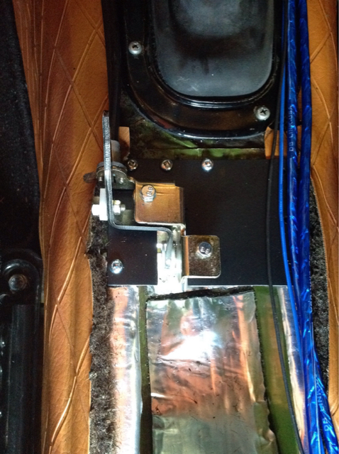

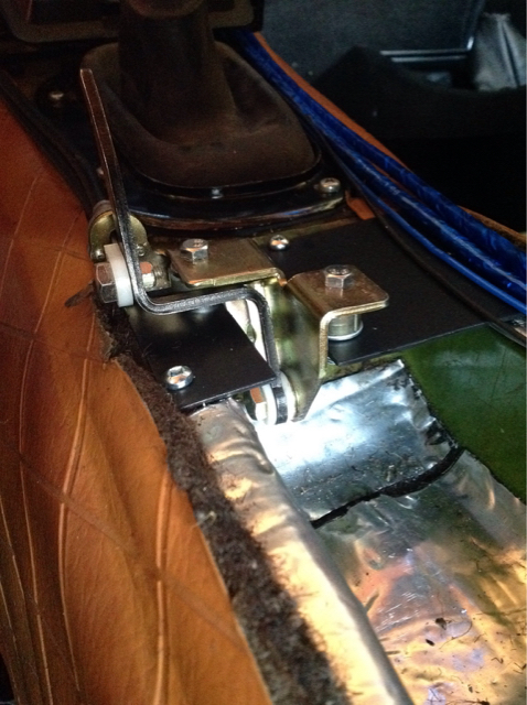

I wanted to remove the Aircon control housing as I've never had Aircon installed, the housing was cracked and I wanted to clean-up my console. After looking at options and searching the forum, I made a mounting plate from a piece of steel, mounted the choke bracket to the plate and the plate to the transmission tunnel.
It took a bit of trial and error to correctly position the bracket so the choke lever was centered in the console slot. I also decided against screwing the plate on the passenger side due to the fuel / brake hard lines that are located in the transmission tunnel. The choke is very solidly mounted now.

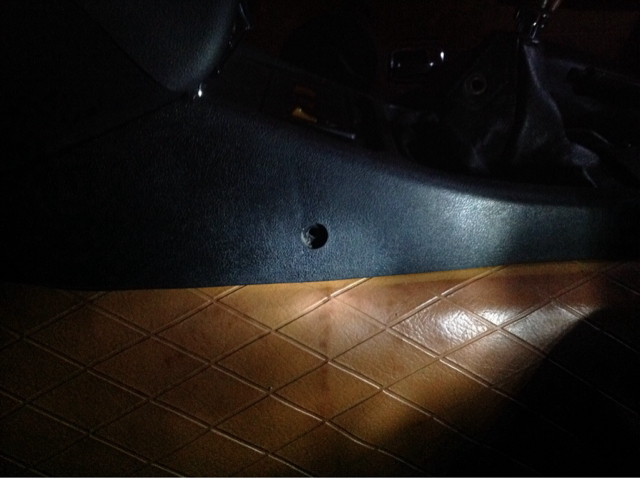

I'm also missing the screws / plugs on the left and right side of the console, and was wondering what screws / plugs are supposed to be used?
