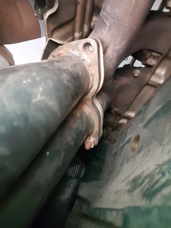

I guess my leak is still at the manifold to downpipe union. Today i found a very rustes broken stud and my mechanics rachet tool attached to it. Should i consider buying the set of three studs and nuts? Maybe a better quality?20170514_100421.jpg
You need a better quality mechanic.
Edit - actually that might not be a broken bolt.  It looks like a ratchet extension.  Still, a good mechanic would have seen the broken exhaust flange stud and fixed it.
Yes, you should get three new studs and nuts and a better mechanic.
Edited by Zed Head
 Ditto on the new studs, lock washers and nuts. You'll also want to coat all the threads with anti-seize. None has been used on the old studs in your pic. (Shame, Shame) Another possibility to ensure there's no trouble with removal in the future would be brass nuts on steel (maybe stainless) studs. Before you tear it apart, how about clamping the side of the flange with the broken stud with vise grips and listen to the degree of change. Should be easy to reach from above.

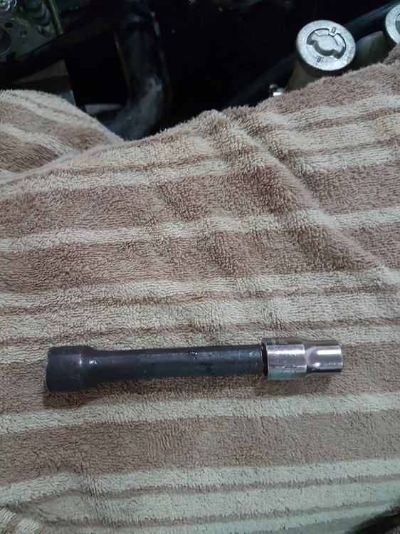

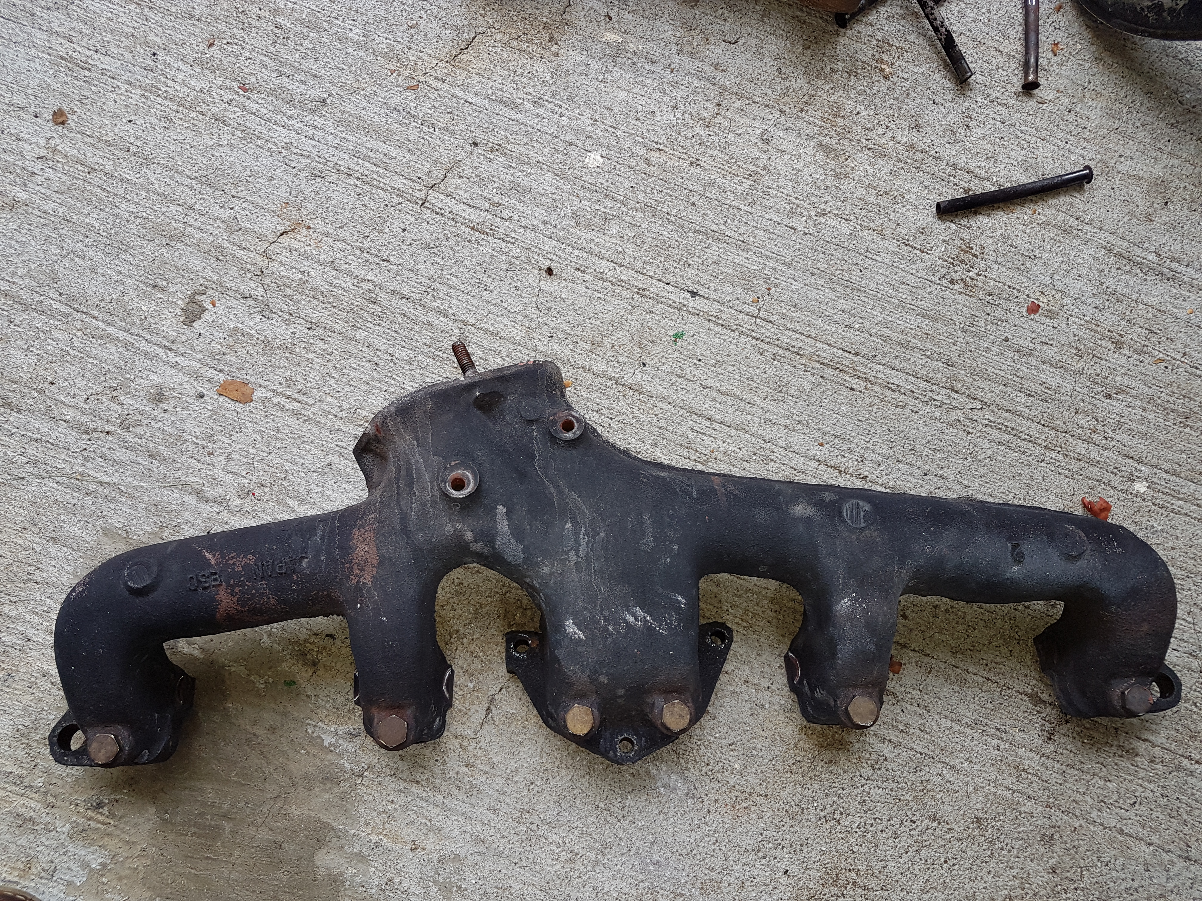

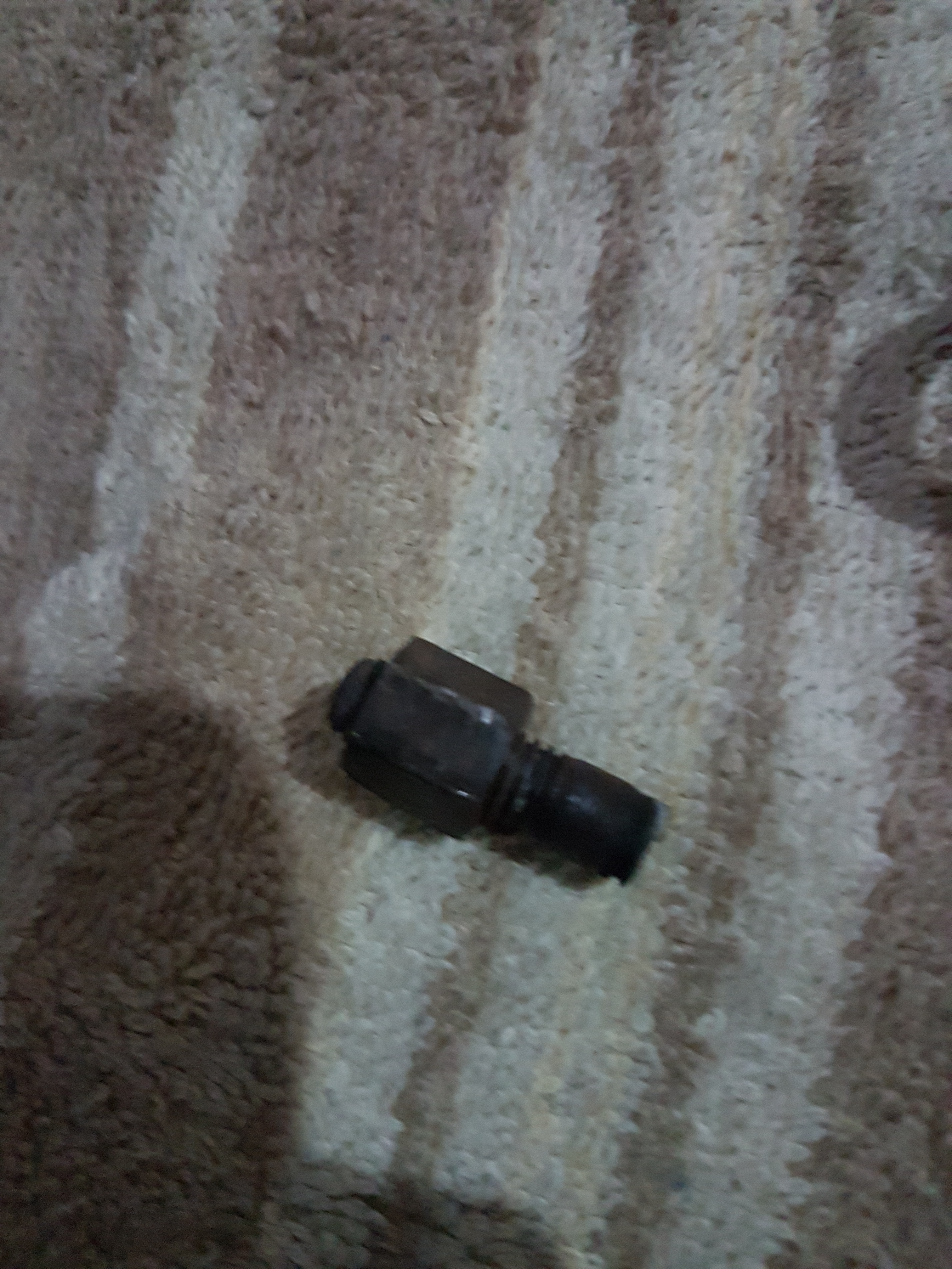

While trying to extract the broken stud the extracting tool broke and now my mechanic has to remover the manifold completely. We have noticed that 3 years ago when the air galley was removed the former mechanics did not removed the guides and just installed new bronze bolts to cover the holes. Ill take pictures of them and will post them for your opinion
