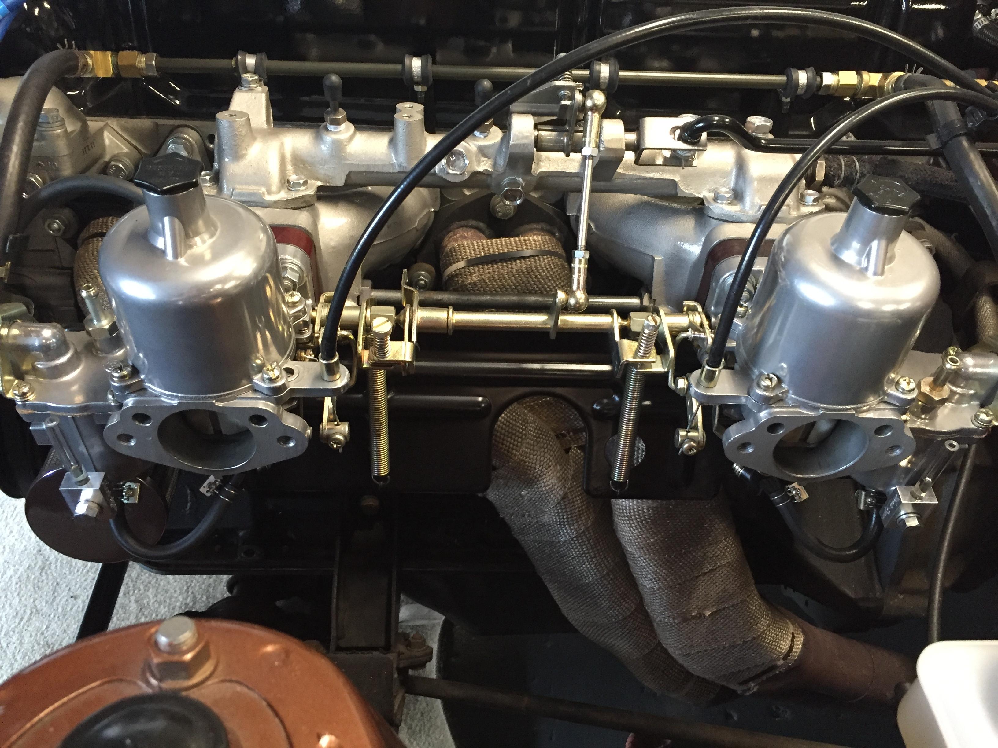

This is the fuel level using the clear hoses Ztherapy sold me long time ago. Im still waiting for Randall to sell me a kit of his great invention. 20200404_163611.jpg
I can't see if they're the same level. They're probably very close which explains your spirited driving.? Glad to see you found the source of the leak. Dripping fuel from the carbs of a Z can be disastrous.

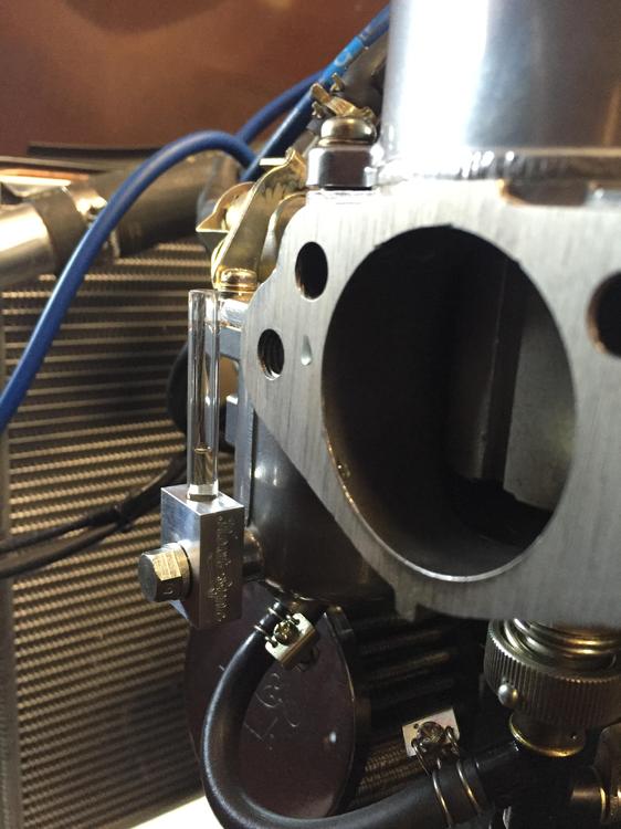

I will likely have new Float-Syncs back in stock and ready to ship by next Wednesday. One of my suppliers says my parts are in the mail and I will  receive them on Monday. I think you will find these much more precise, and you can see the fuel level in both carbs with the car running. Maybe some of my former customers can vouch for Float-Sync.

23 mm down from where exactly? From where to where shall i measure with the caliper?
