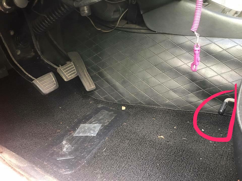

Suggestion:
Buy some plastic rod (black, if you can find it) of the appropriate outside diameter.  Cut an appropriate length, with an inch or so extra that can be chucked in a drill press (preferred) or an electric hand drill.  File a rounded contour onto one end.  Then drill out the core to suit the diameter of the lever rod on the seat.  Cut of the end that was chucked in the drill/drill press.  Spray paint with satin black, with particular attention to the two end surface.  When the paint had dried adequately, epoxy it in place on the seat lever rod.  Cut a length of heat shrink tube and apply over the flat length of the nylon piece.  Heat to shape.  Done.
The original piece isn't exactly soft to the touch, so you won't be giving up much in feel by using the hard nylon and shrink-tube covering.  The original piece has a bit of a taper to it, but no one will notice that your 'faux' cover is straight.
