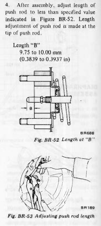

Sounds like you didn't adjust the booster rod to fit the new master cylinder, and the piston in the MC is pushed forward, blocking the fluid return hole.  A fairly common problem.  You need to remove the MC and shorten the booster rod.  Or shim out the MC.  Here's a picture from the FSM.  With all of the various aftermarket parts though, you kind of have to adjust by feel, or take measurements.  I don't think that their "B" length works for all MC's.

We're all on the same page.  If it was mine I might just build a shim, loosen the nuts and slide it in between the booster and MC.  Easy and same end result but you get to keep the new parts.

Not ignoring you Dave WM.  He only talked about replacing the MC so the assumption, maybe wrong, is that he didn't mess with the inside stuff.
Another reason that I might use a shim is that several people have had problems adjusting the adjustment on the booster rod.  It tends to get stuck.  Sometimes really bad.
Fender shims might be about perfect.  You could loosen the nuts, let the MC push out to where you can just feel it touching the booster rod, then slip the fender shims over the studs and clamp it back down.  You can get a whole box of various thicknesses at Harbor Freight, and thye're u-shaped so that you can slip them without complete disassembly.  A little bead of sealant across the top and sides to keep water out and you're done.
Big picture, if it works but you still don't like the shims you can take it apart and do it "right".  At least you'll know what the problem is.
