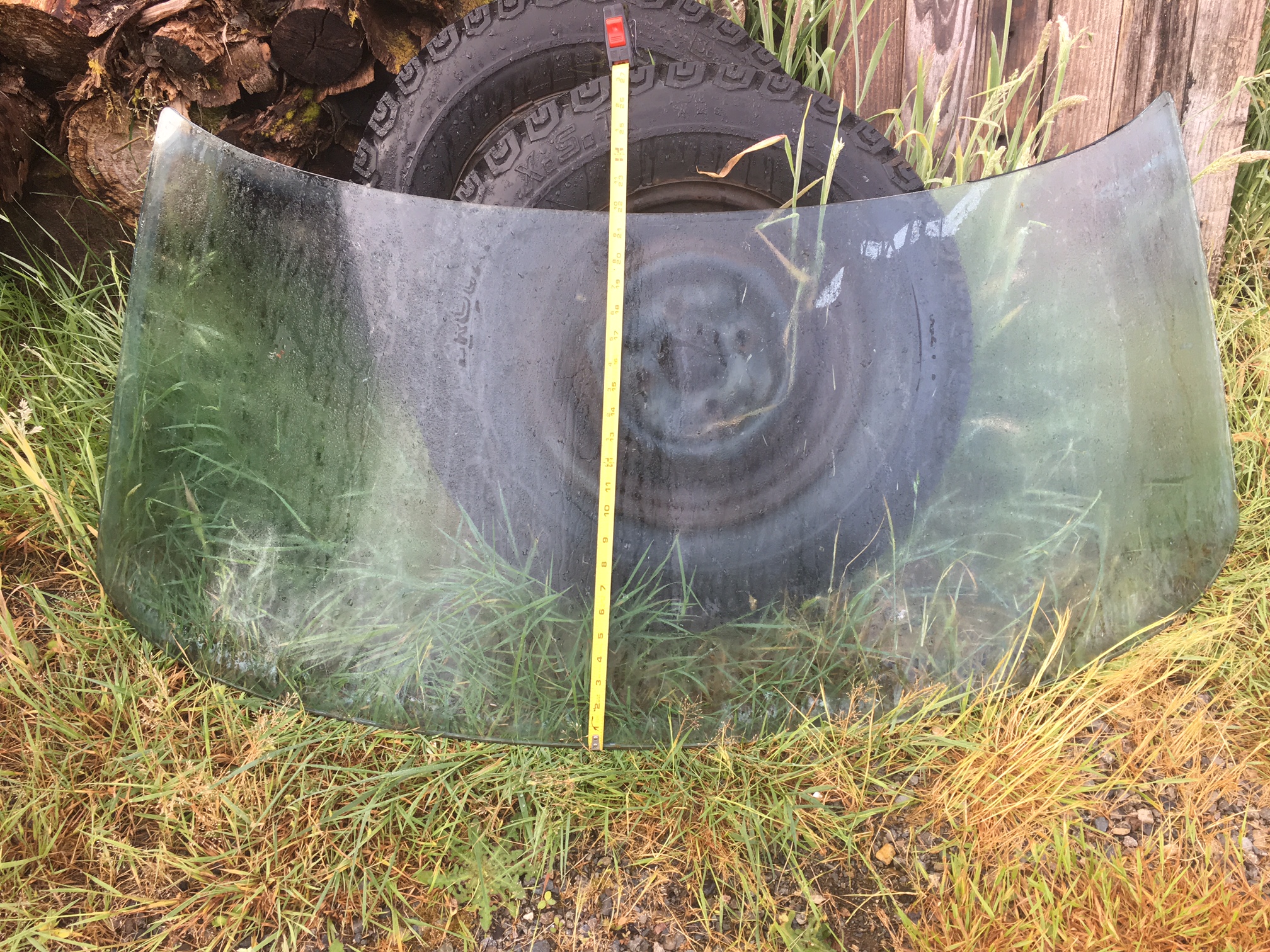

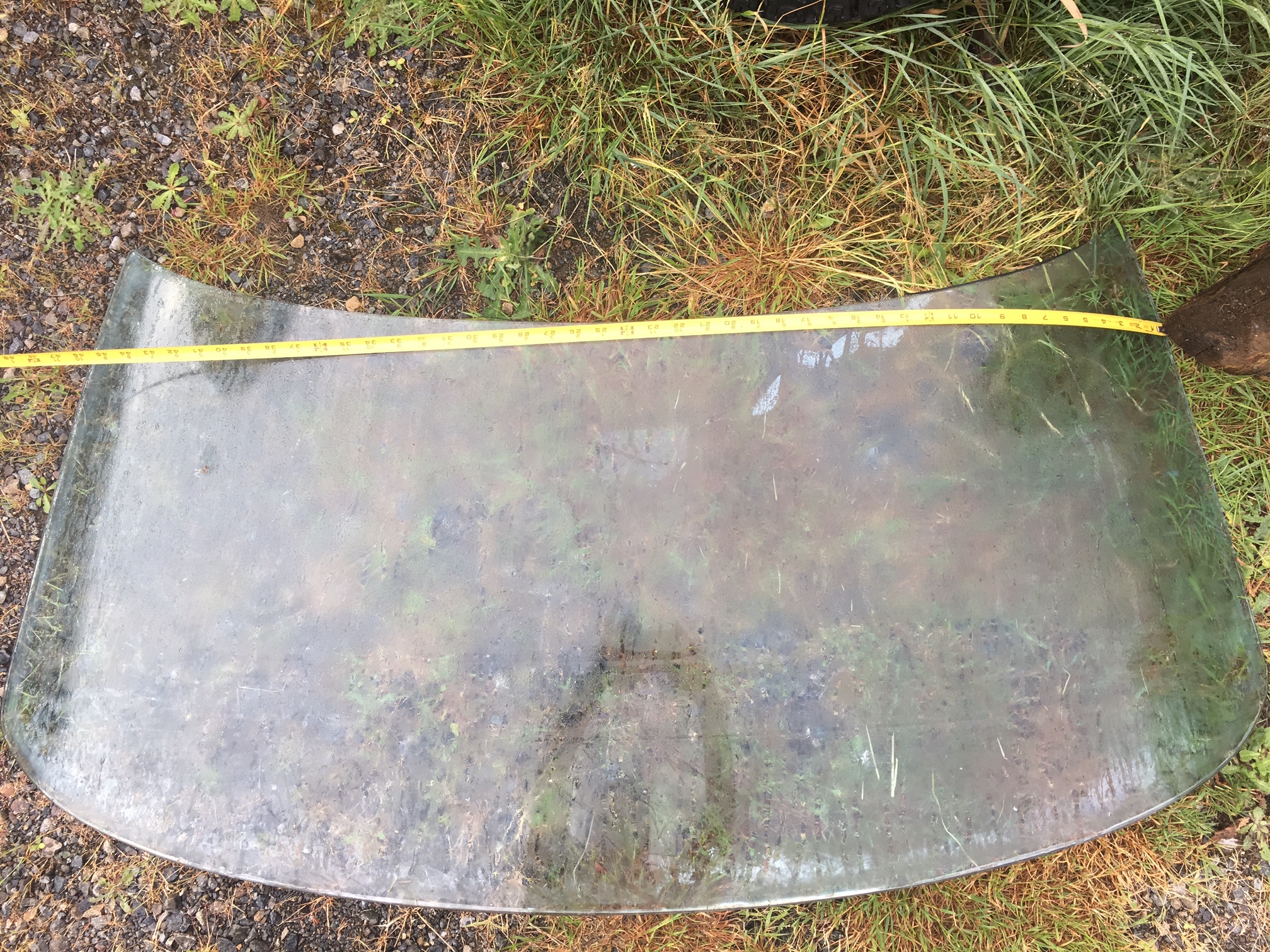

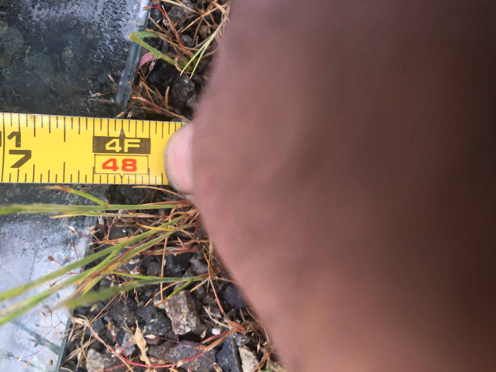

Hardway,

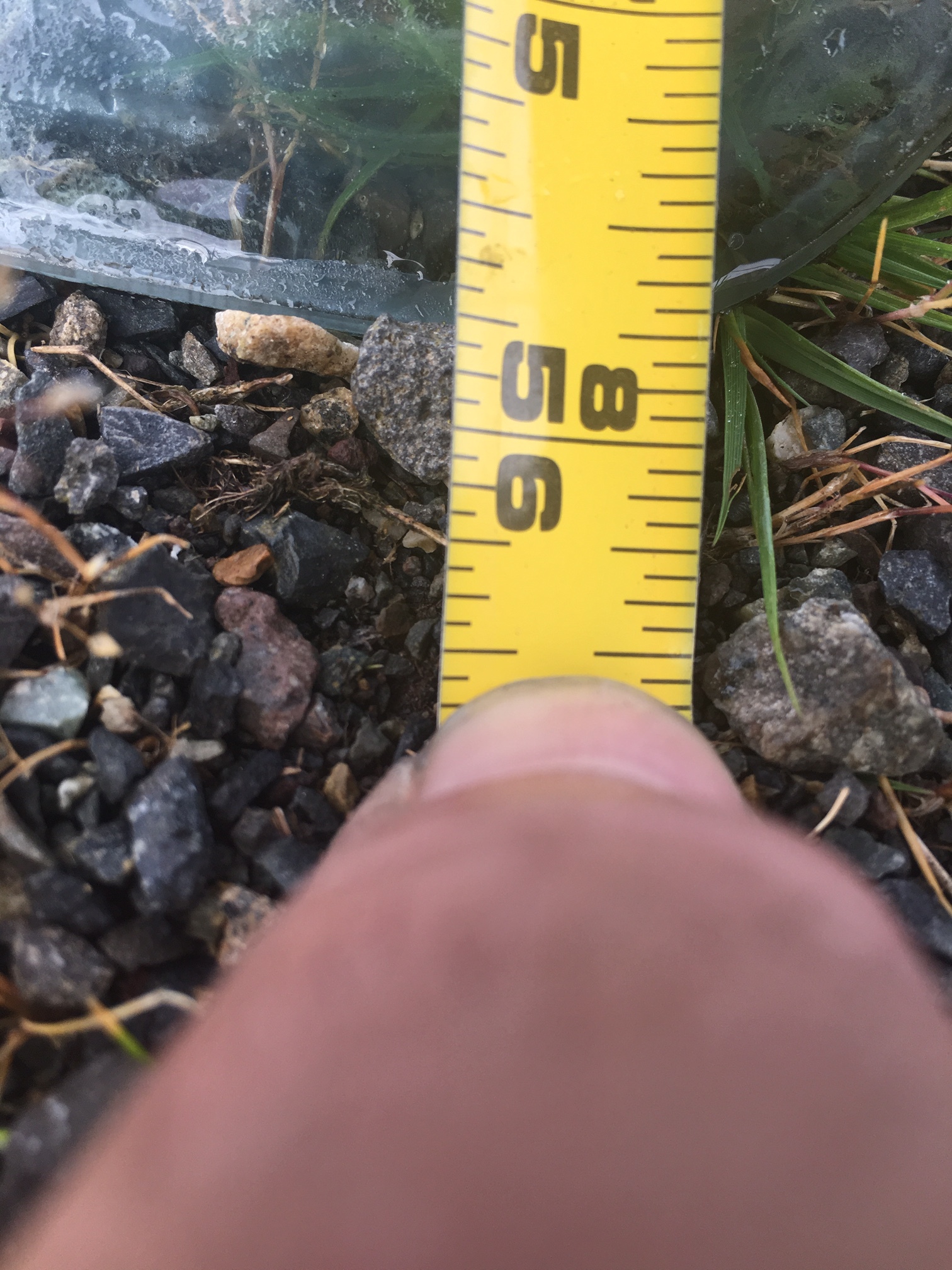

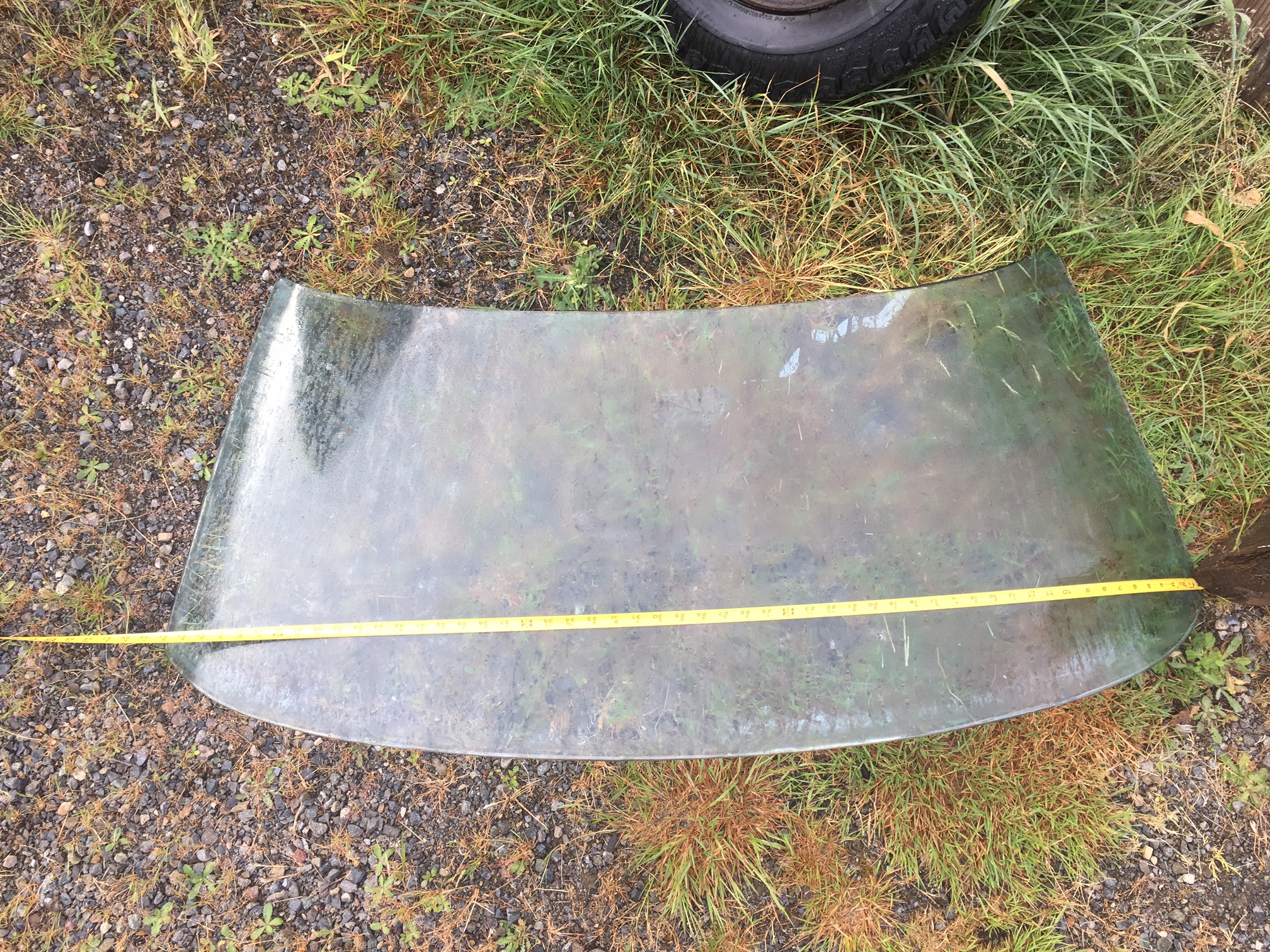

I have a stock Nissan windshield out of a parts car. It has a sizable rock chip in it. I took some straight measurements across the arc at the top and bottom, and one up the middle.
Each has a wide angle so you can compare in the same location, and a close up of the measurement.
I hope that helps you out.
middle 21 3/4"
Bottom 55 3/4"
Top 48"
Thank you so much for the info and tips guys!  Thank you Terrapin Z for all the pictures.  They are a great reference!  One of the local Z club members had an original Nissan windshield out of his '72 240z.  I went and measured it earlier today and compared it against my new one and they match to the 1/16th of an inch.  So it is definitely the gasket.  I have contacted the seller about returning it and getting a refund.  With this experience using the Precision gasket I am hesitant to buy another one, leaving me with buying a Nissan gasket as my only other option.
