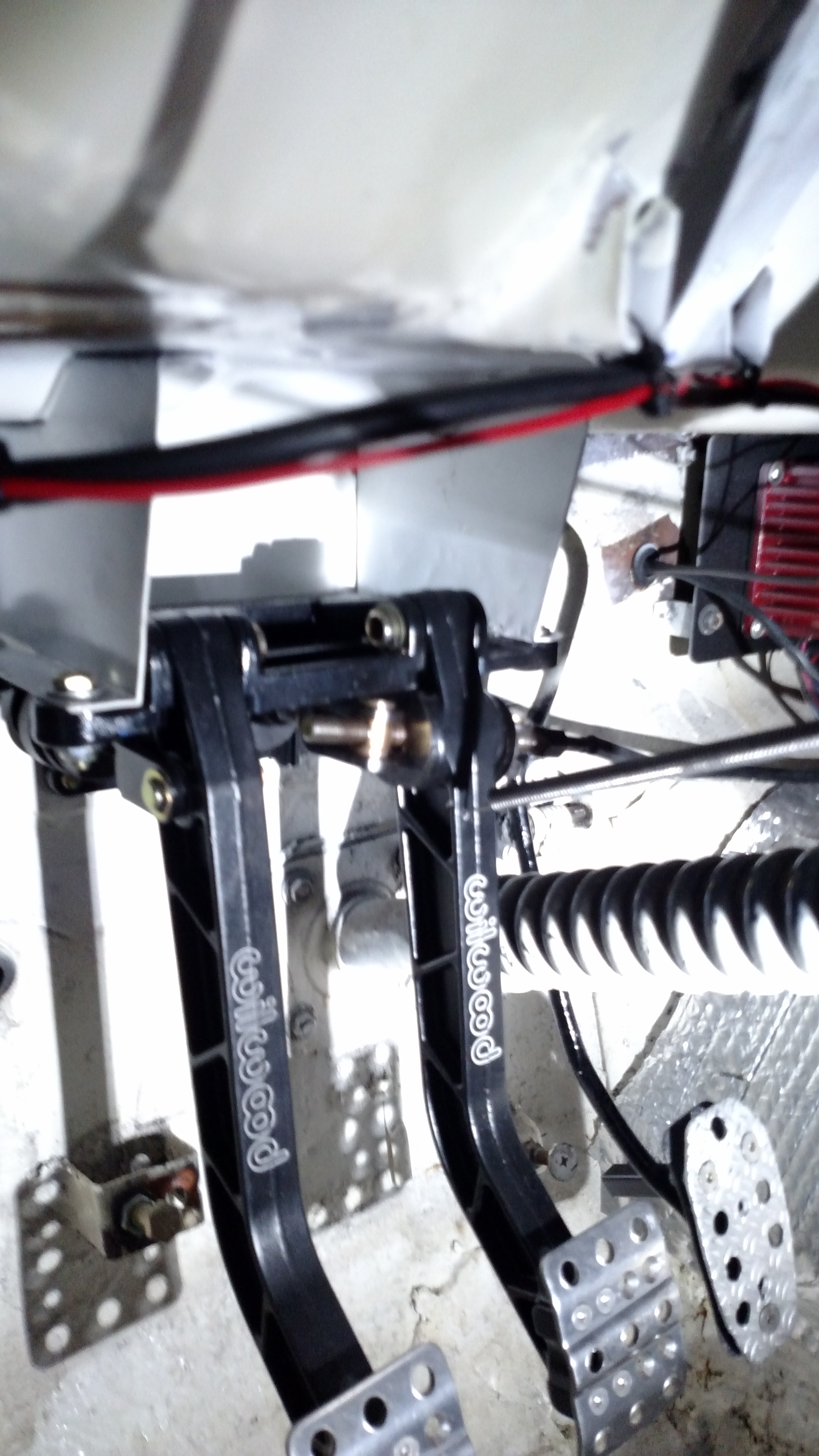

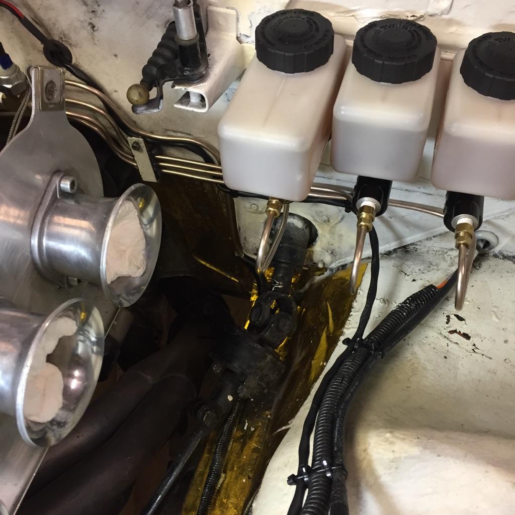

Not too sure if the vac pump will make your braking effort easier but it does help if your engine doesn't produce enough vacuum.
This happens in modified engines with big cams. I ran a pump in my street car (3.2L) and in the race car (CR- 13.7:1) before replacing everything with Wilwood pedals and MCs. Much more effort involved, less weight, dial in bias adjustment and fewer parts to go wrong.
The pumps are not cheap, they are loud (how loud? You can hear them over the un-muffled race engine)) and take up a fair amount of room.

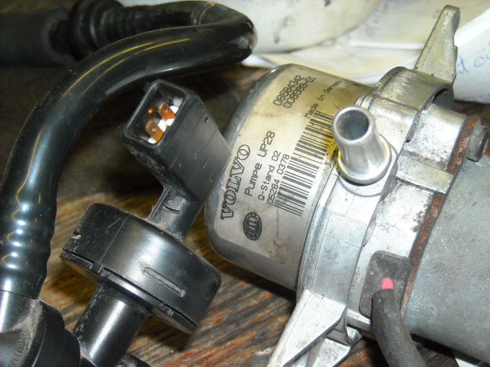

I hooked up a vacuum pump off of a Volvo for my modified Z and although it works well, like gnosez says it's loud and cycles on and off everytime you hit the brakes, kinda of irritating. I'm trying to tap into the vacuum log instead.

you mean like this....see pics
