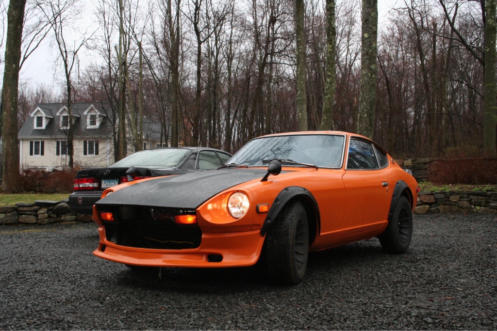

Haha!! You know, right after posted the claim about 77, I was thinking the exact same thing and was thinking someone may bring that up!
However, looking at the pic of the engine compartment, it appears to have the 77 PCV hose routing, so barring higher res pics of the engine, I (got lucky and) stand by the claim of 77.
It's probably a 77 then but I believe it was built in late 76.
I bet that's about right. Late 76 build. Sloped rear deck, and titled (at least it should be) as a 77.
