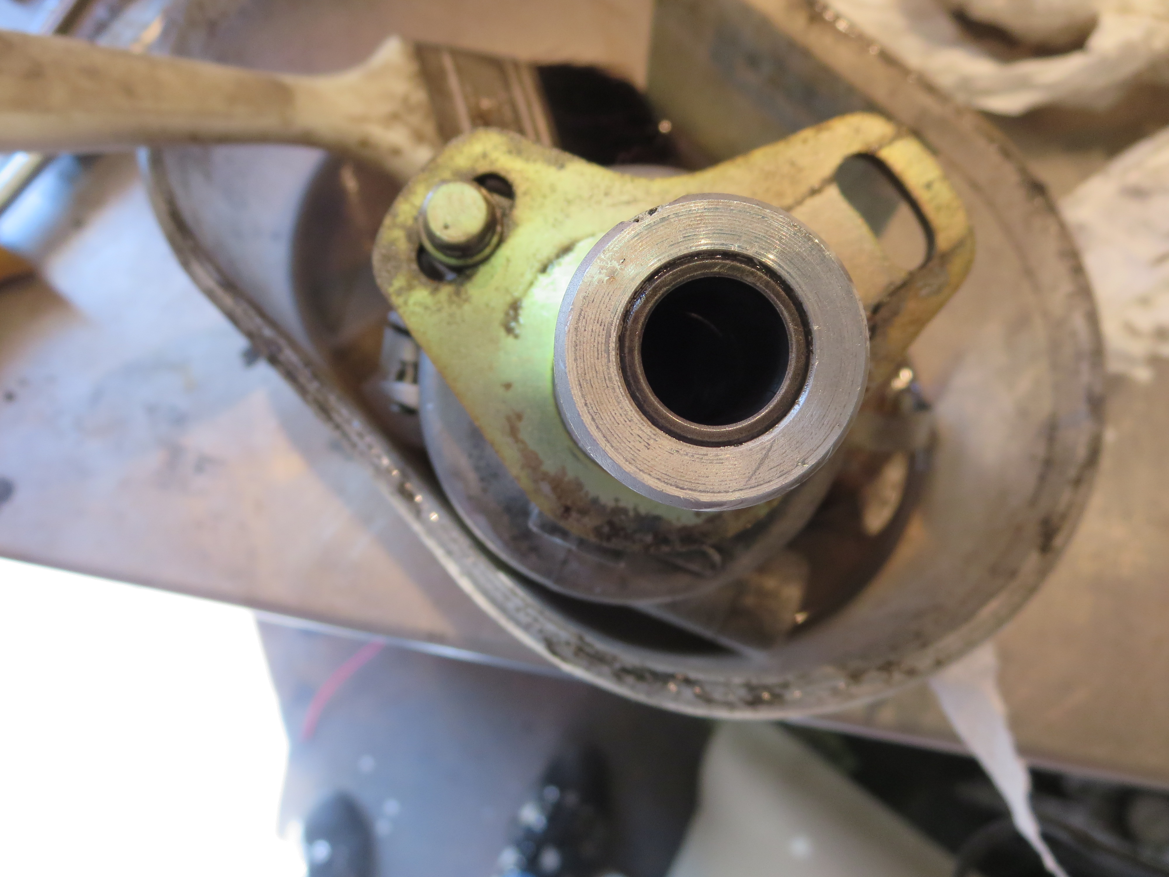

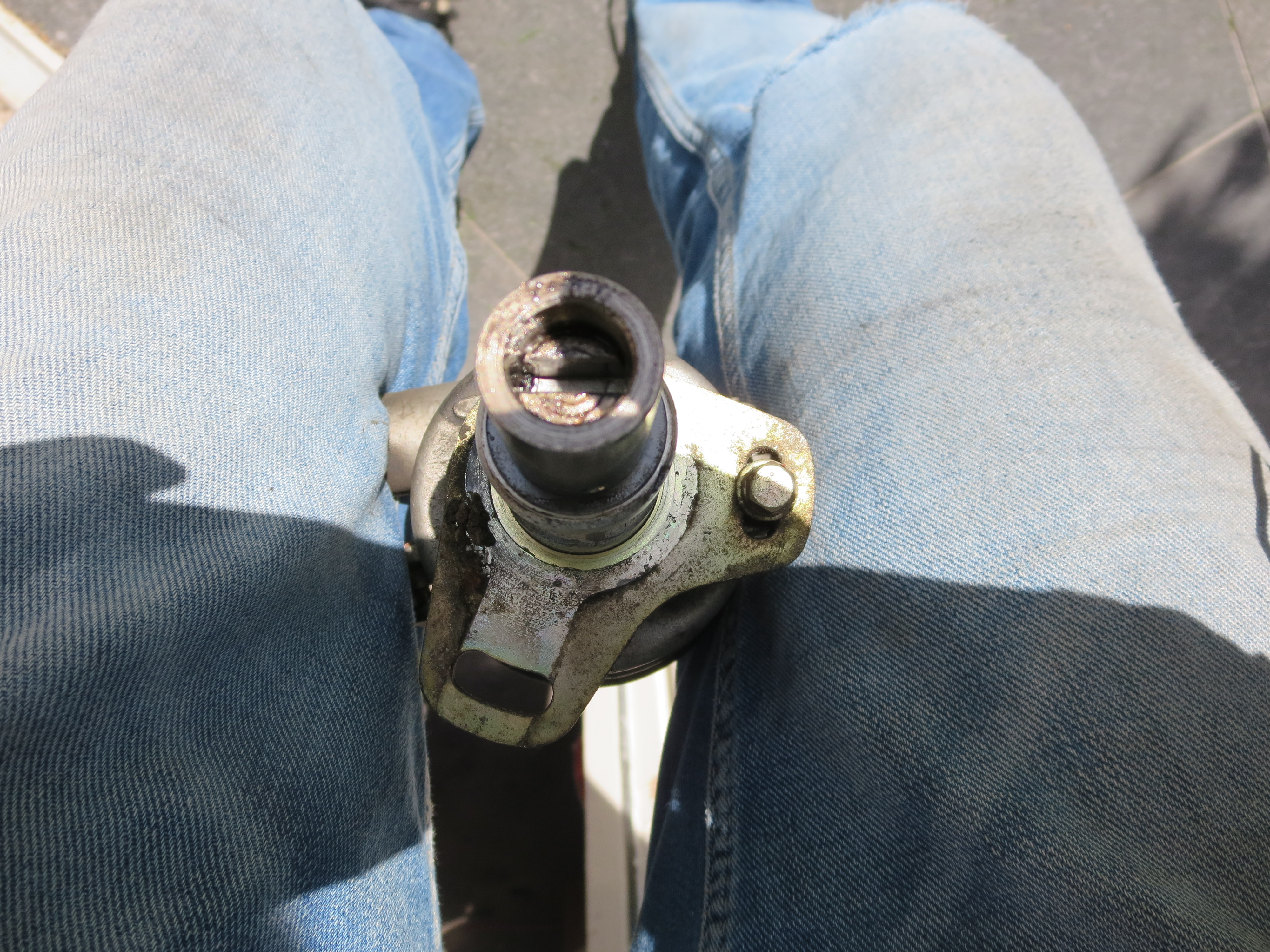

I also read elsewhere that the distributor clamping plate can be turned slightly, which might lead me to adjust the distributor incorrectly.  Should I remove the distributor ad check the position of the plate and its screw?  A picture of a correctly installed plate would be nice for reference.
I wonder if I put that plate on upside-down?  It would throw off the time a LOT.  Icchh-  I got a lot of work for tomorrow.

Here are some photo's of my distributor. Mine works perfectly were it is set-up.
