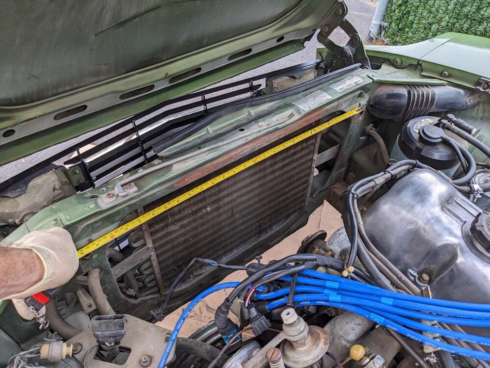

If I keep the current line routing, rather than the factory layout with the receiver drier on the right inner fender, it will greatly simplify the layout. Question is whether I can fit the accumulator on the left side - the receiver/drier is currently stashed down on the inner fender near the manifold/downpipe. Not ideal. I may need to route the lines around to the right & put the accumulator on the existing bracket used for the vacuum tank (I presume) on right inner. That would mean much longer AC lines, so I'll have to figure that out. I have the AC beadlock crimp tool, so making lines from scratch is not a problem.

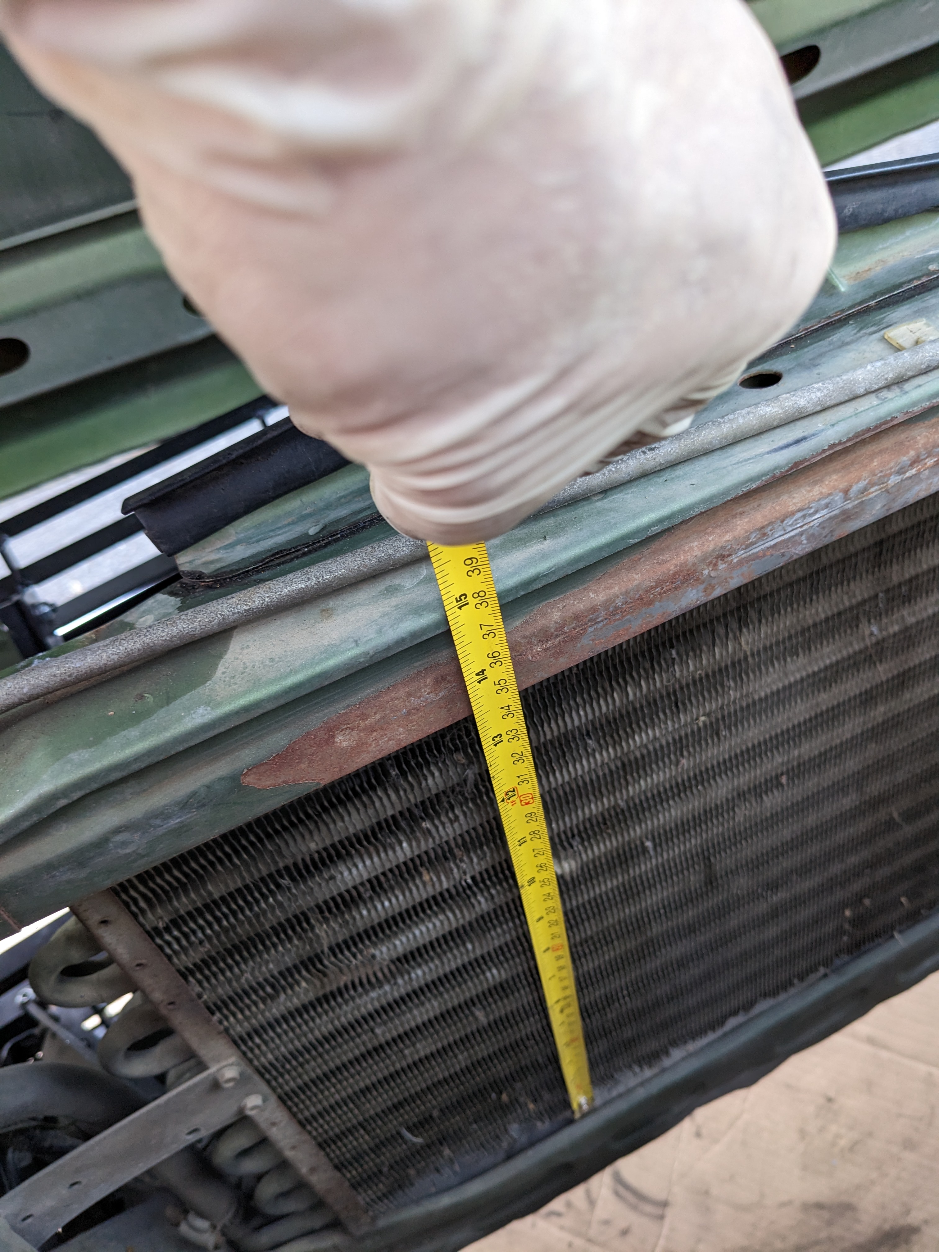

My Z currently has a 14x20" condenser, and I think having a slightly larger overall surface area (approx 300 vs 250 current) can't hurt
