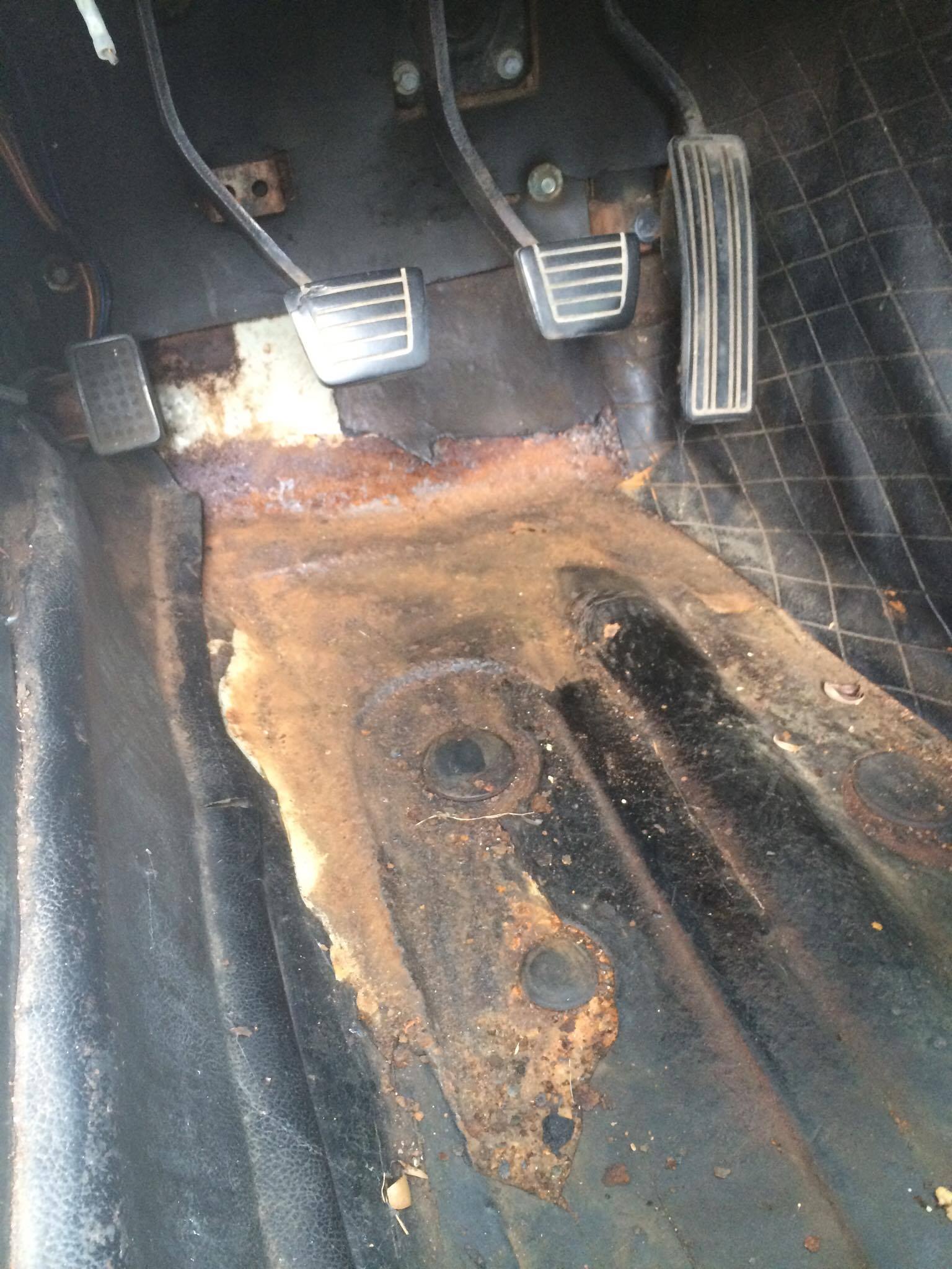

I forgot to upload the worst picture which shows one of the floor boards which is pretty much gone, see here:
Where are you looking for the sill rust? Below the Golden stripes? The guys been out of town the weekend, so I'll be calling him tomorrow evening. Any questions and stuff I should put forward?
I'm sort of preparing myself for the worst in terms of Rust, in hopes I can only be pleasantly surprised.

L O L at your picture of the floorboard being pretty much gone. Dude, that's what we call mild rust. It's pitted, and if you sandblast it, maybe you'll get some perforation. Consider those floors to be reasonably solid, and maybe in need of patching. They might need a total replacement after removing the factory sound deadening and blasting, but I doubt it.
What you're calling the rear valence is what we call the hatch sill. "Rear valence" is usually referring to the panel below the tail lights. Also, what you call "sills" I believe we call "rockers" aka, "rocker panels"
As for what else you should ask for? Battery tray for sure. Spare tire well, doglegs (the bit just in front of the rear wheels, the shape looks like a dog's leg), rear fender lips, underside of floors. There's more areas that typically rust out, but that car looks pretty solid, so I'm guessing the less commonly rusty areas are fine.

Okay you have me there! I meant with the two pictures I received, I didn't upload the worst one :-P I'm glad it doesn't look "completely gone" though.
