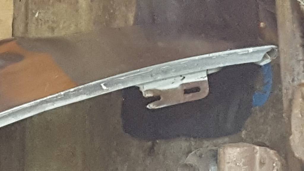

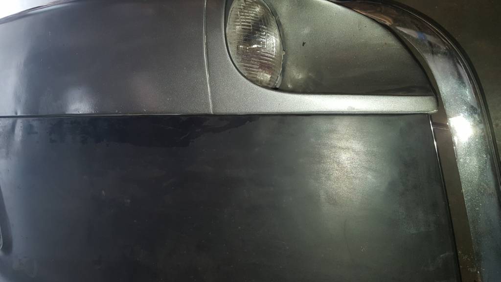

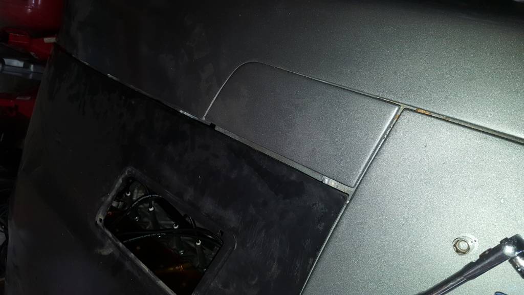

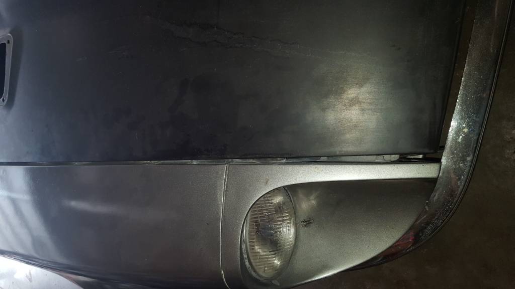

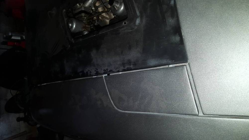

Hey guys so i recently purchased a 280z hood for my 71 240z and upon bolting it up saw that it wasnt lining up correctly at all, am i doing something wrong here? Also i noticed that my original hood had some cutouts where the bolts would go almost looked like it was to slide it either up or down from one side more, not sure why,
Ive attached some pics so you can see what im talking about, any advice and tips help greatly thanks guys!20170624_170432.jpg20170624_170444.jpg20170624_170456.jpg20170624_170522.jpg20170624_170806.jpg

I used the same size spacers, folded cardboard pieces,  on both sides and loosened the bolts at the hood hinges to get it straight. Don't loosen them too much though or you'll fight it all day. Learned that the hard way.
Edited. Your's look like a fender alignment issue maybe?

 Try to pull the hood forward until it lines up with the front of the headlight buckets. Those slots on your original hood are not stock, someone elongated them to get the hood to fit and you may have to be duplicated on your new hood, they are for front/back adjustment of the hood.
Yes it fit right and im replacing just because i liked this on better, no body filler or bending,
But i did forget to mention that this hood i put on was pulled off of a 280z that had been in a wreck (hit from the side) the hood looked fine but now im starting to think its warped somehow.

Yes, but you will want to remove the hood latch so the hood sits flat and you can see the relationship between all of the panels, after you get the hood into a position you like tighten the bolts equally on each side a bit at a time so everything stays the same relative position then re install the hood latch and line it up.
Quick update: the hood is now on and its lining up perfectly LOL, ive noticed though that the driverside hood hinge doesnt fully close all the way unless you push it down the rest of the way. Other than that everything looks good

Your original bonnet / hood mounting holes have been elongated drastically! I'd say your car likely had a small love tap in it's life and someone frustrated trying to get the bonnet alignment right modified the holes to get it to sit right. Getting hood alignment right on a S30Z is 1 of the worst jobs out there I reckon.
