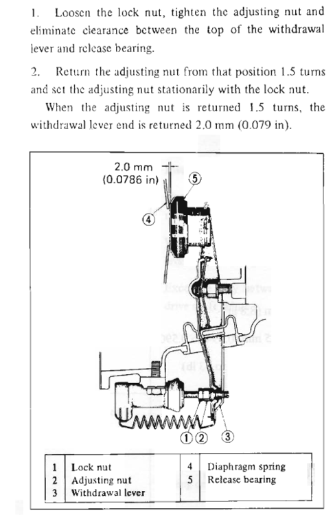

Very recently I did a clutch slave adjustment. I was trying to back it off at the slave so there was a little play with the clutch pedal fully up. (so I wasn't putting undue pressure on the diaphragm spring)  Maybe I went too far? I would assume this failure mode would be that I couldn't disengage the clutch enough to change gears, not that the clutch would then slip.  Am I all backwards?
I suppose I could have backed off the adjusting nut too far and there is now more clearance than there should be between the withdrawal lever and the release bearing. But again, I wouldn't expect the clutch to slip in this case, just that I couldn't properly change gears.

Good idea to check what you last worked on, but your symptoms don't really sound like a slipping clutch.  A slipping clutch will make more engine nose as  RPM increase but the car won't go any faster.

2) Clutch slave had been replaced with aftermarket. There is no return spring (not sure if it is required with this slave).  The piston extends outward automatically to meet the withdrawal lever, so any of my adjustments to the nut aren't going to mean anything... unless of course I need the return spring.  Either way I adjusted the nut out so the piston on the clutch slave is basically at the start of its travel, like it would be with a return spring. The auto adjusting outward force is not strong at all so I don't think its significantly preloading the clutch.

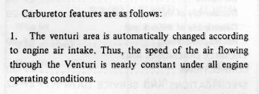

If I read the operating description in the FSM right, the pistons control air flow and the pistons are controlled by intake manifold vacuum.  So, basically, if the pistons don't rise to let more air in then the engine is effectively throttled.  I'd like at where the pistons vacuum source is, and if it's possible that it's blocked or lost.  Maybe the carbs are loose, causing a big vacuum leak, or there's a fitting or plate that's loose.  Seems like the pistons must not be responding to intake vacuum is what I'm implying.  They're probably open a certain amount for idle and low RPM, so you do get some response.
It's a neat concept, but the carb's air opening is controlled by a secondary mechanism, the piston, not a primary one, like a throttle blade.  If your throttle linkage is working, seems like it has to be the pistons.  Assuming that the other engine parts are correct, like ignition and cam timing.
I could be way off, I'm just using your problem to learn SU stuff.
