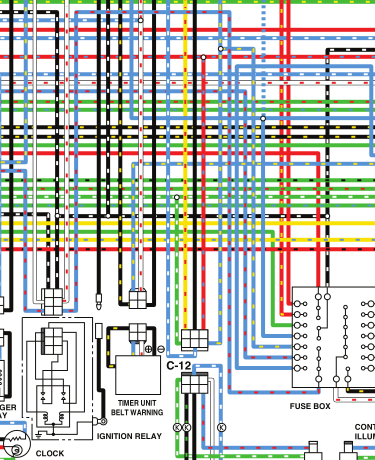

Actually, those three get power from the ignition relay.  My car had a mysterious blue wire to the ignition switch in addition to that box of rust.
The relay is over by the fuse box.  There's a diagram in the FSM, BE chapter.  The 280ZX igntion relays will work, they have the same pins, but have an extra dedicated ground pin also, so they get a different part number even though the'll plug right in.  Nissan moved the relay to a dry spot behind the glove box in the ZX's, I got a spare from a wrecking yard.  I replaced my 76 with a 78 though, that I had from  a parts car.  Somehow it survived.
