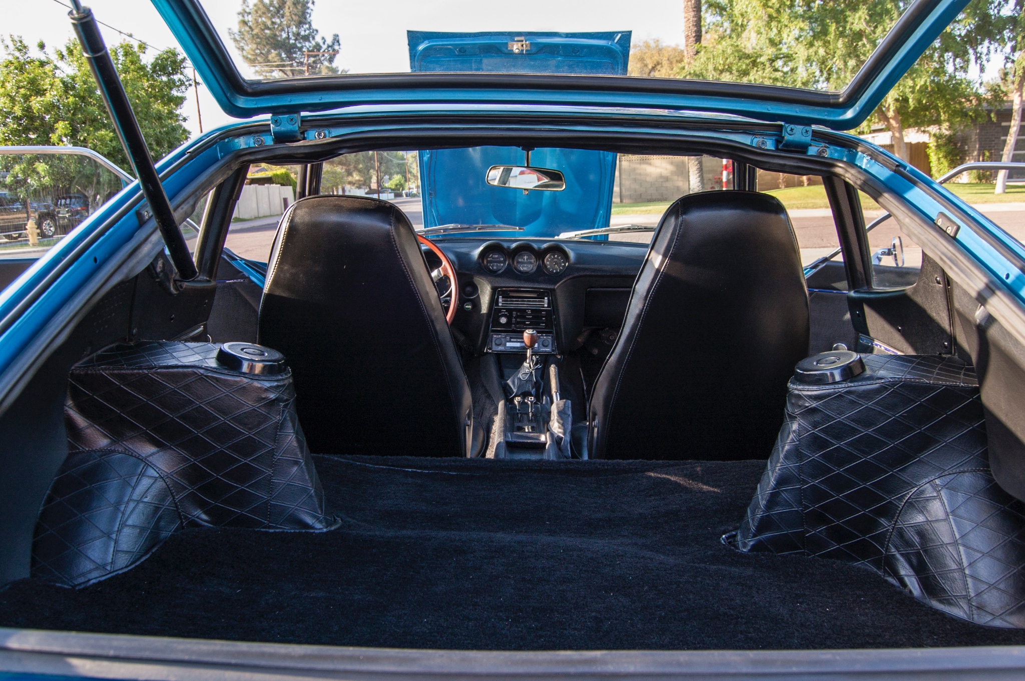

I have a 1/1970 240Z that I recently bought. The car had 3 previous owners, first two being the long-term owners. These folks did a lot of work to the car over the time they owned it. The first owner had the car re-upholstered around 1980 (hmm, that didn't last long!). The second owner had the car up on a rotisserie for restore/repainting. Which is great, because they seem to have done a great job on rust. Also, the headliner is nice and firm. But there are some unoriginal elements to this car:
  • rebuilt, non-matching L24
  • most of the original vinyl is gone, replaced by carpet (even on the tunnel).
  • all/most of the original jute material is gone. sometimes, replaced by foam, sometimes by nothing really.
  • dashcap
  • luggage straps removed
  • original wheels gone
  • etc etc etc
I use the car as a weekend+ driver. I don't want to restore to concours or anything. My goal is to have an enjoyable Z that I don't feel bad about driving; and also I want to "do no harm". I might want to see the car in a few years, we'll see how it goes.

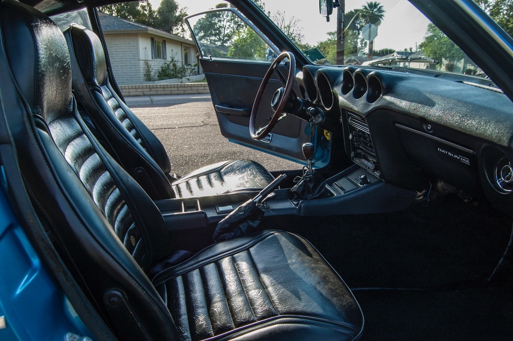

I agree with everyone else.  Your plans would not negatively effect the value at this point since much of the original interior material is gone.  It is hard to tell from the photos but your seats look like series-2 reclining seats as I do not see the knobs on the sides.  Since you want to go with something more modern this is a non-issue.  The only thing I would suggest is pulling the half-cap out and replacing it with a full dash cap.

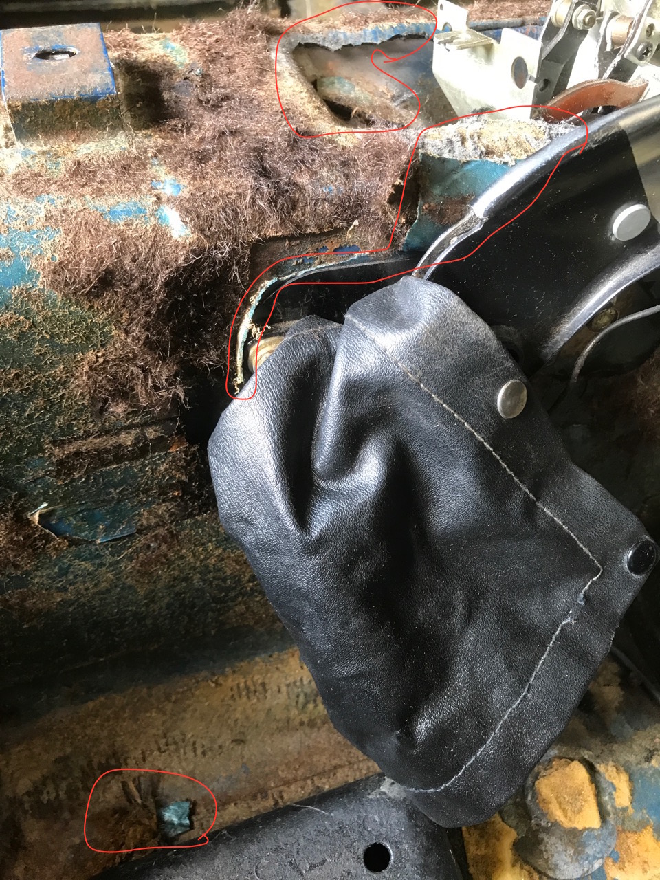

While scraping off the foam (well, not original, but old at this point), and the brown hairy stuff from the tunnel, I found 2 little mysteries:

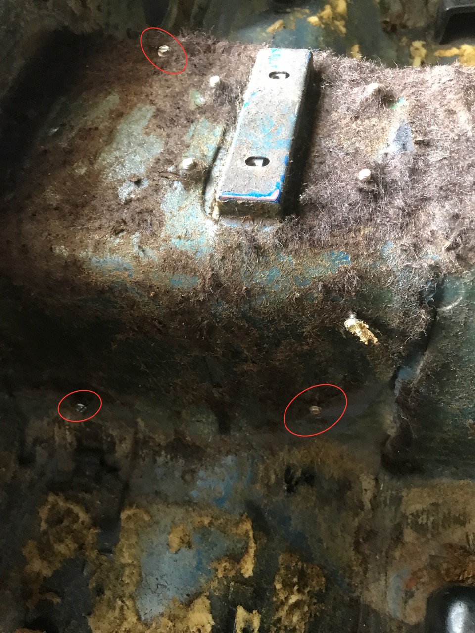

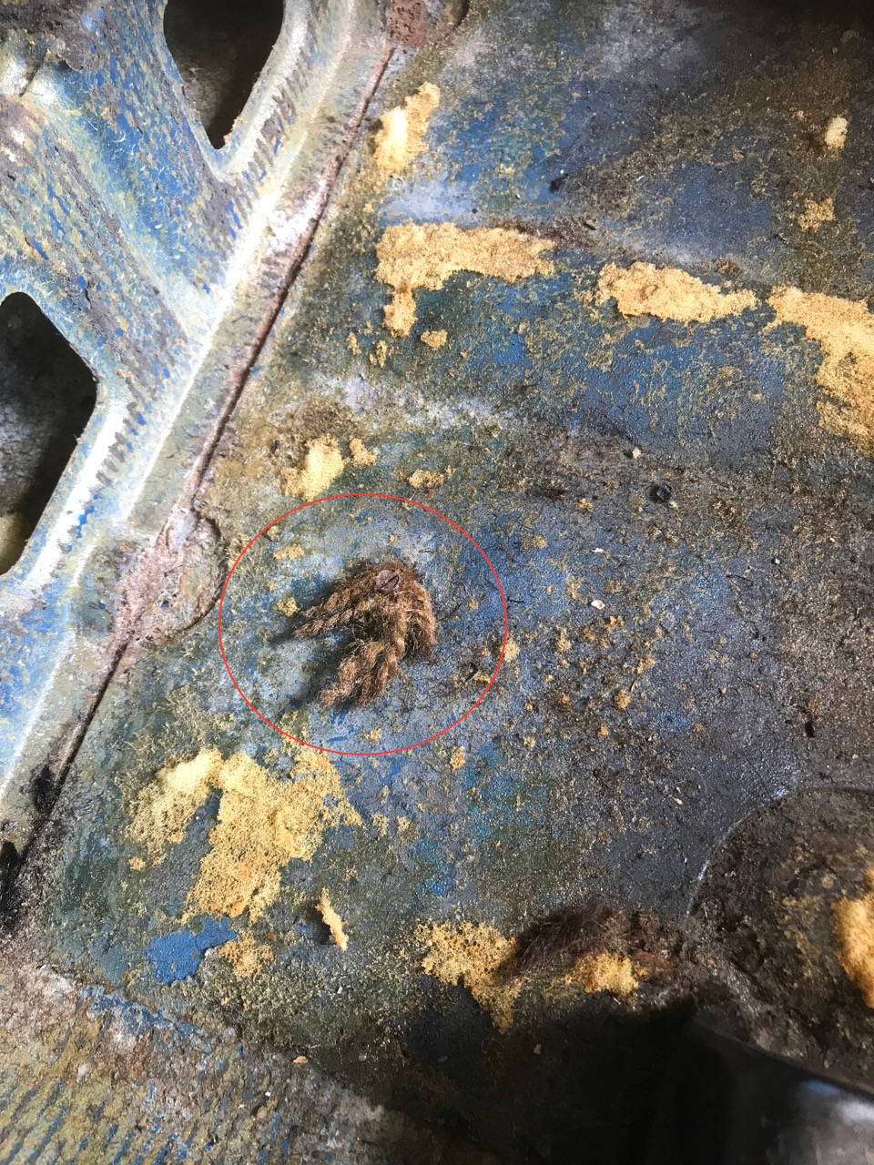

  1. The car had black carpet when I got it. Pretty standard stuff. But it looks like at some point before, it had some kind of brown carpet. And I think it was screwed down. All that's left is a bit around each screw (see pic). Do I need to keep these screws? I presume they aren't original at all. Should I plug the holes they made in the metal if I remove them?
  2. Around the handbrake, something interesting showed up. With all the brown stuff, I didn't realize what it was at first, but it appears to be the diamond-pattern blue vinyl. It's still behind the hand brake mechanism.
Does that mean what I think? This car had blue vinyl originally? If so, would it have had blue panels too? Or in 1970, was the blue just limited to the vinyl?

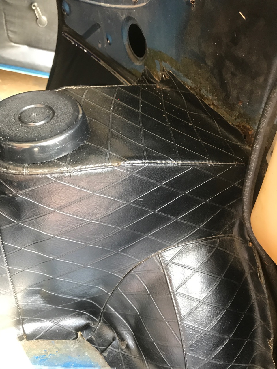

I was also going to ask if there is a way to know if Vinyl is original or not. The stuff in the back is in good shape...

Forget to mention: the seats are not original. They have the later bar that will allow tilt mechanism, and they have wire underneath, not webbing.
