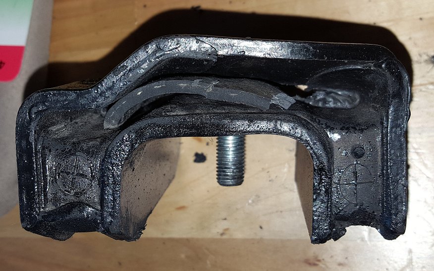

The engine/diff mount insulators are originally HNBR. Nissan uses HNBR and noted in the price. The NBR aftermarket units are a lot cheaper, but will sage much quicker.

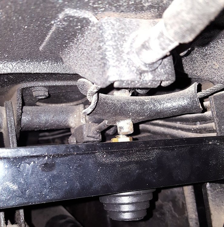

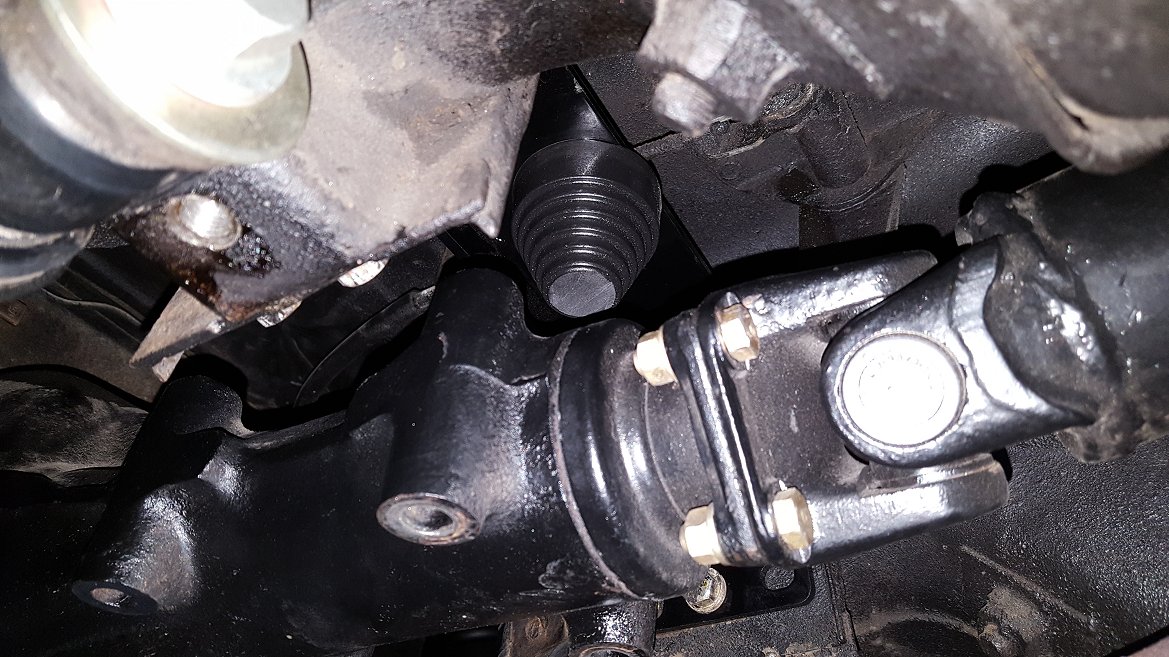

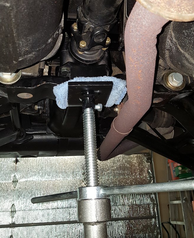

Wow!  This thread has really taken off.  Once again the Z community is out in force.  Well GOOD NEWS!  I solved MY rear diff clunk (yours may be different).  I went back to my original "diff sandwich" setup but with a small update.  First, using another member's suggestion I cut a piece of heater hose and inserted it in between the two plates of the lower diff mount.  This took some real effort as I used a large flat head screw driver to pry open the mount enough to get the piece of heater hose in.  As I talked about it later with Mike W, it probably would have been easier to put it on the diff so it was held in place while I worked on it.  Either way, its in and you can see it in the pictures below.  Next I had ordered a new snubber bushing for my RT mount a few weeks ago.  If anyone is wondering they are made by Prothane and are part number 19-1318-BL.  Got 'em on Amazon for $17.61 shipped for two as they are sold in pairs.  Just like I did with my old '72 240z, I only cut off one layer of the bushing.  I also cut the threaded stud down to clear the parking brake mechanism.  Using my adjustable safety stand I was able to push up on the cross member to get all four bolts in over half way, then working from side to side I tightened in equal steps and torqued anything down.  With everything buttoned up I did a once over on all the other suspension fasteners to make sure they nice and tight and they were.  Down came the car for a test drive, success!  Just cruising around and doing some spirited driver revealed no clunks or noises.  The only time I heard anything was when I drove it really hard, almost approaching abuse I could hear and feel the rear drive line make a thump/thud sound but not quite a clunk. I think it was just from drive train shock from hard driving.  I never drive the car like this so in my opinion I think everything is good as the drive line now feels rock solid.  I do not get any noise or vibration from this setup either.  If you have any questions please post them and I will do my best to address them.
Glad you got rid of the clunk!!
Just one comment/question. The rubber portion of those inboard control arm bushings are clamped into place by the brace you removed. With the brace removed, the rubber can rotate.
Point is... If you had the wheels hanging when you took that brace off and put it back on, I believe there's a risk that those inner bushings rotated changed position. Did you do the final tightening of the hardware with the car on the ground (or the wheels suitably loaded)?
Glad to help.   :)    Only reason I even thought of it was because I had removed the same brace not long ago. I took the cheaters way out and put blocks under the tires to keep the suspension loaded while I had the back end up high enough to get under there.
Hardware... I am going to be cutting up a heater hose this weekend!!
That was brilliant... Now I wonder if their s a way to inject some hard curing silicone to accomplish the same thing. Some type of rubber epoxy maybe.  Very nice!!
