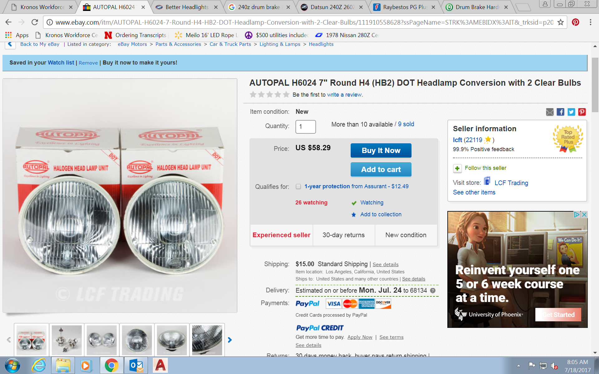

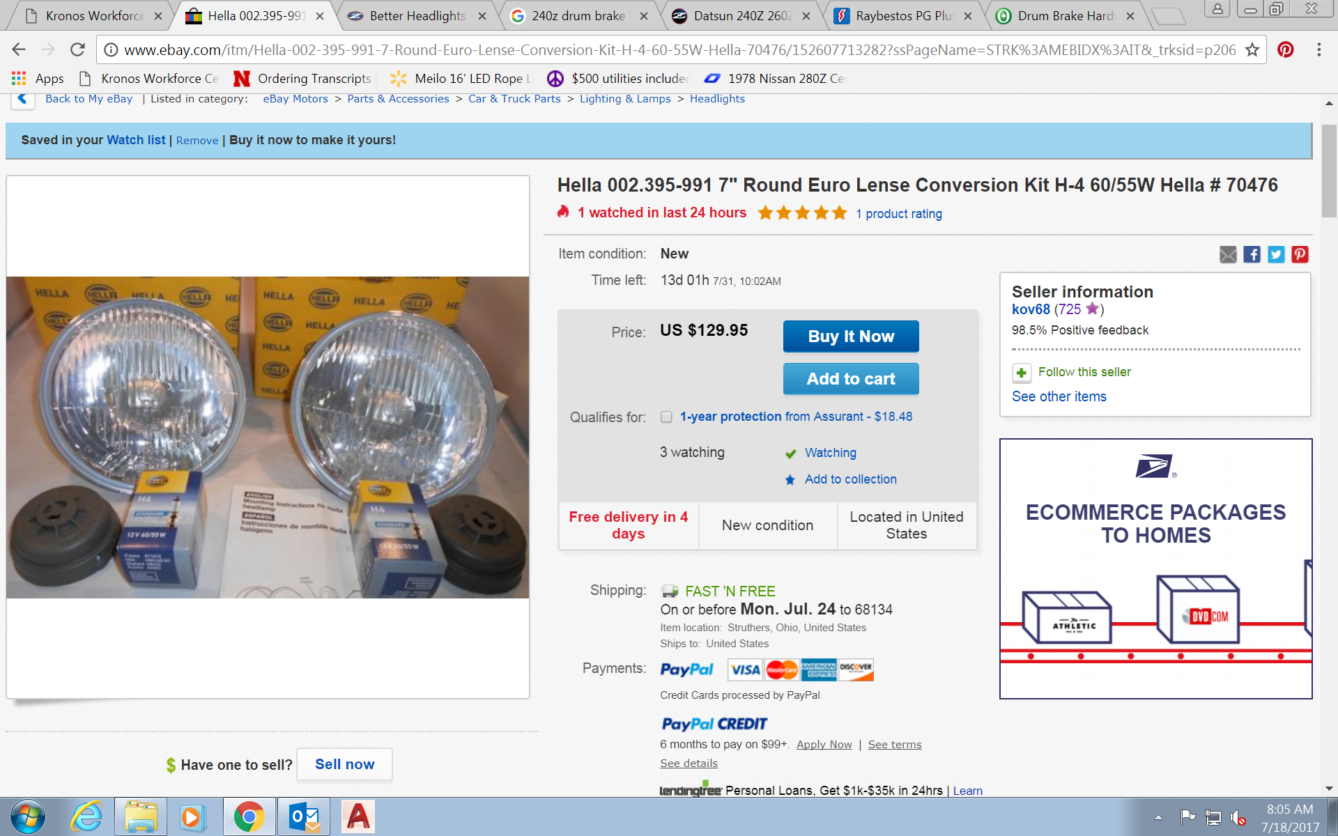

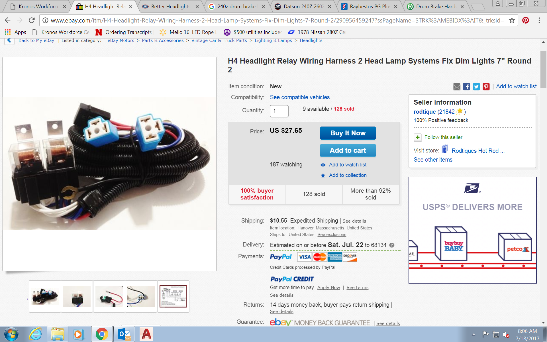

Thanks for the replies.  Lots of good info.  Would these kits below hook up to the stock harness?  Is the harness below good, plug and play?  Opinions on the kits I listed that I was looking at?  Some of the kits I see (the Autopal's?) have a "holographic" look to the glass, I want it to be as clear and colorless as possible.  Do I have to make the headlight mounting bracket bigger?

Re: Daniel Stern -- he has a reputation for being eccentric. You either take his recommendation or he shuts off the conversation. Many satisfied customers and many perplexed by his "customer service". If you can work with him, things generally produce the desired results. Google shows this time and again.
The light and wiring kits would seem usable. The wiring kit looks to have the plugs and relays you'd need, with the understanding that these things are generally "universal fit". Hella is regarded better than Autopal for optical quality, pattern, cutoff, etc. and that's what matters most, but Cibie still seems the tops by comparison. Unfortunately their prices are at the top also. Any replacement will likely be an improvement over old, stock bulbs, so it really matters how much you drive at night, require brighter light (older eyes), and can afford to spend. Google specific products when you have things narrowed down, just for backup information.
Edited by NVZEE
I went ahead and ordered a set on ebay of the autopal housings (with some assuming crap bulbs).  They are e code.  I plan to get other bulbs.  I also ordered that wiring harness.  There is a guy in my city that used to build Datsuns for Nissan, and he has a few shells and lots of parts.
I got my engine from him.  I plan to see if he has an OEM 280z headlight harness, so I can use the connector piece.  Is this the one I should connect the new harness to?
The one on the front radiator support?  I can post a pic of the new harness when I get it, to see which wire goes to what on the connector.
