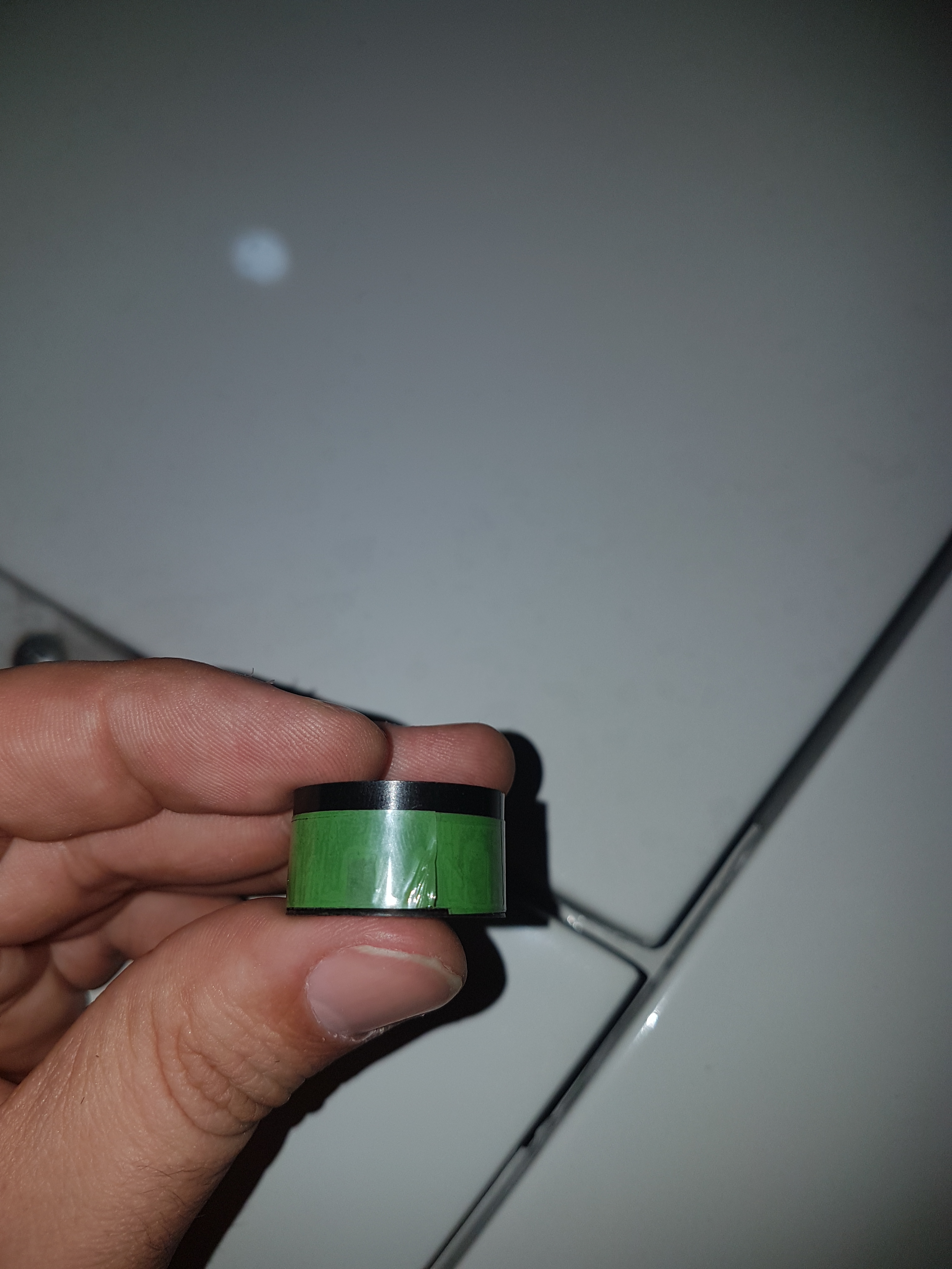

2 hours ago, Jarvo2 said:
Why did you remove it in the first place? Trying to give yourself more problems?

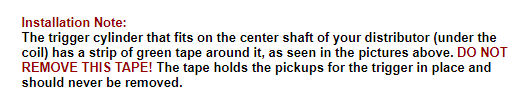

pickups fly out because the tape was removed. new post that will be something like "im not getting spark on some cylinders, why?"
