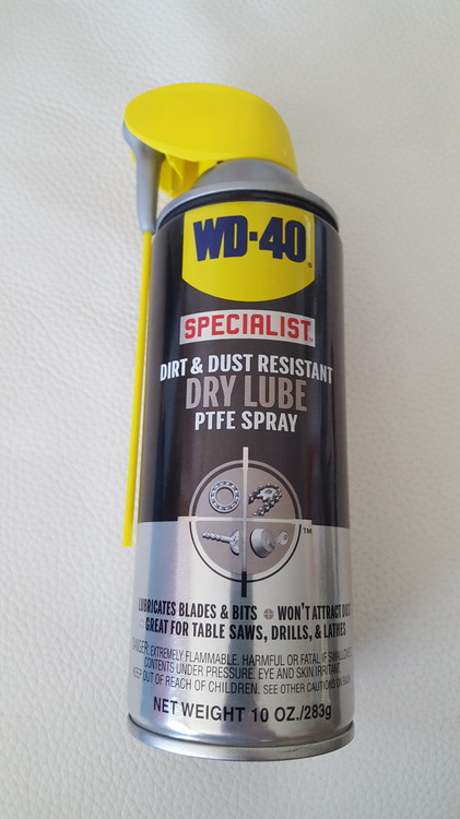

I had the exact same problem after reassembling my interior. I was ready to take the panels apart and add some felt strips until someone suggested spraying lubricant in the squeaking panel joints. It worked amazingly well. It's been over 18 months since and the car is still very quiet. I used a member of the WD40 line "Specialist Dry Lube PTFE Spray" which I found at Home Depot. Simply spray into the edges where the panels meet and wipe off the excess. You'll appreciate the silence.20170718_141026.jpg
Really? I would've never thought of this. Ill give it a shot
