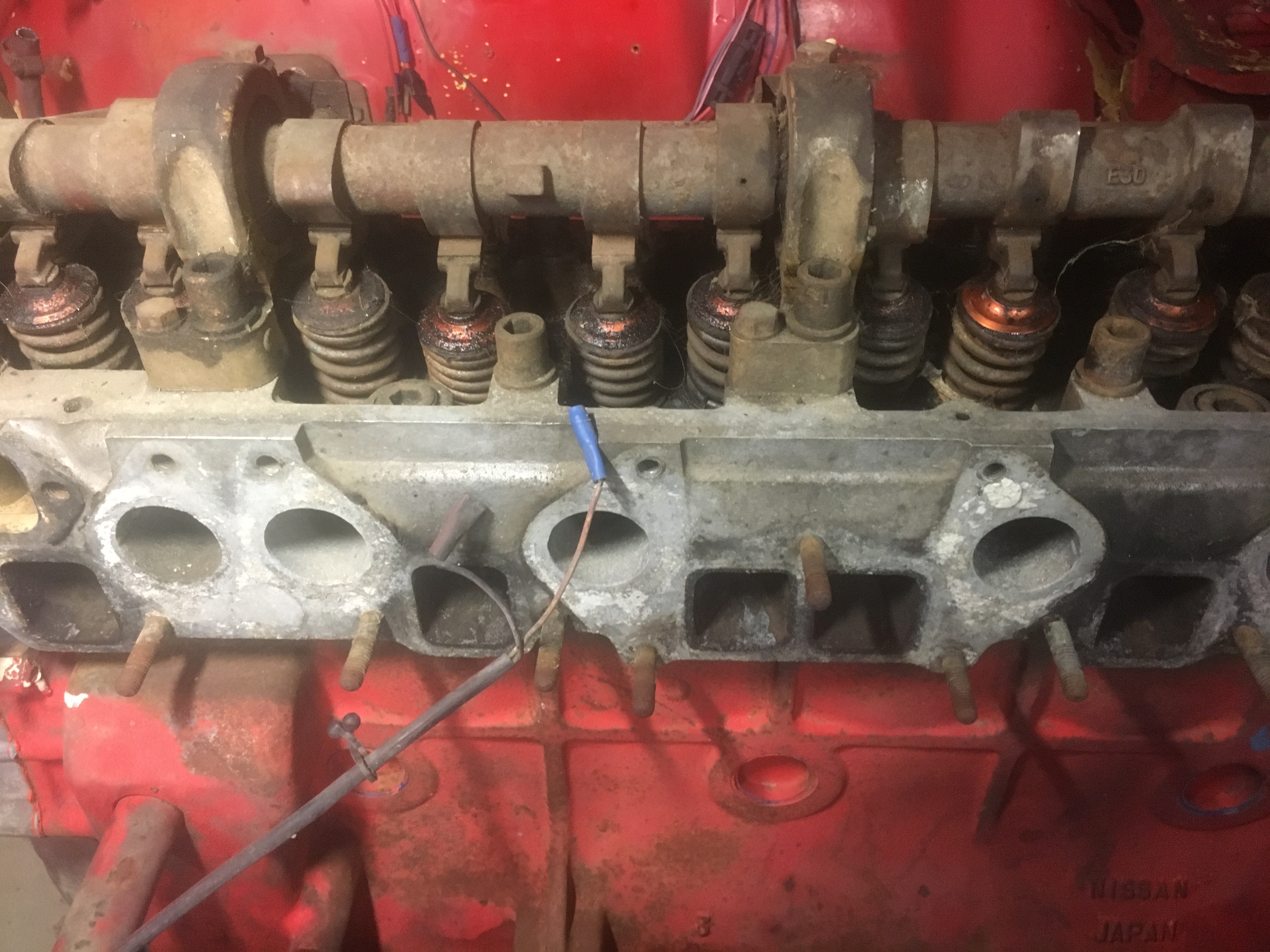

i would clean that cam with some steel wool and give it a try.  i have a cam in an old dodge power wagon that looked worse then that, still running fine since 2001
 Yup, it's worth a try. I've seen ones with a couple of rusty lobes that were cleaned up and worked fine. That one would be a challenge but you'd know after cleaning a lobe or two if it was worth the trouble to finish it.
Valve train certainly is interesting. Those look like early Nissan Comp Aluminium spring retainers. They came in different colors to indicate what lash size they supported.  I wouldn't throw the cam away. May just need a slight touch up and a re-parkerizing......
Any markings on the back of the Cam?
I couldn't find any markings anywhere on either end of the cam. I'm going to clean it up and likely trade it off to Steve Bonk that does cams to see what he can do with it. The head does have the bigger valves and has been shaved a few thou for sure with shims under the towers. Need to finish taking it all apart and getting it all tanked
