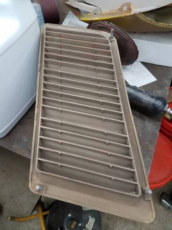

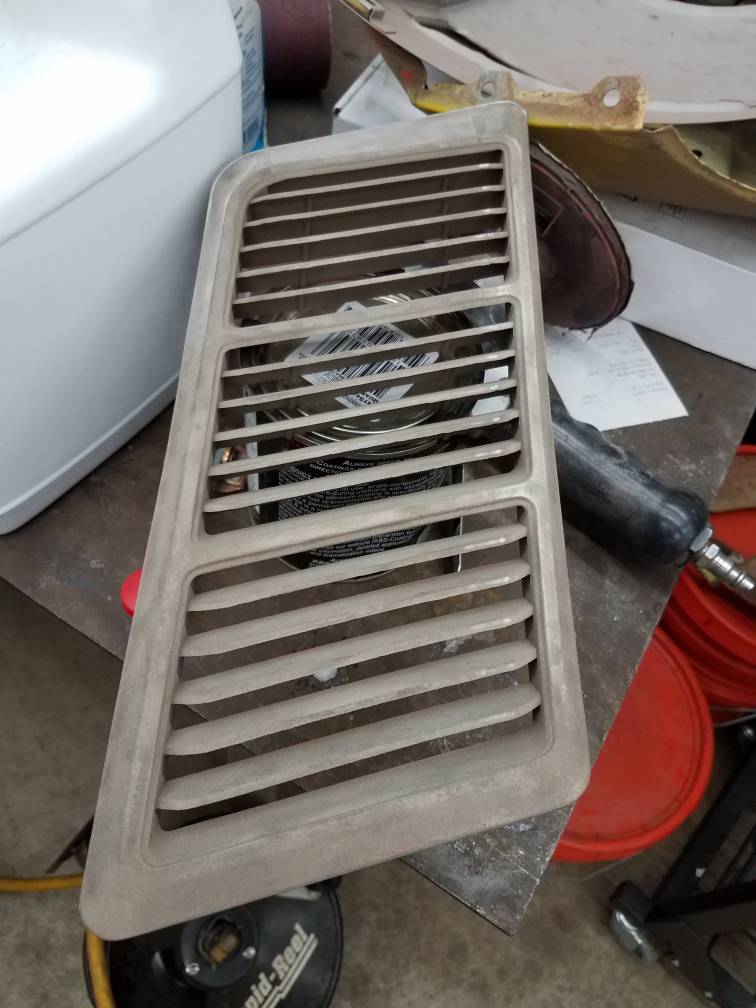

I just finished my louvers. I used an ultra-fine glass bead in my media cabinet. Took 3 hours for each louver but the results are clean plastic surface. I will still sand each louver with 220 wet and then prime.20170722_081811.jpeg20170722_081821.jpeg

Thanks for all the great input.  The media blasting looks to do a beautiful job.  I was planning on using some Dupli-Color engine paint-supposedly good to 500 degrees-never thought about the barbeque paint or maybe even some exhaust paint in satin black.  Plenty of options.  The clean up will obviously take a good bit of time.  Thanks again, John-Lugoff, SC
NOTE he said "ultra fine glass bead"  . I tried normal glass beads and stopped quickly as it was pitting the plastic. I was using about 110 # of air pressure also.
I wound up sanding by hand carefully  ....  takes a while . Repaired the pitted area with filler.
