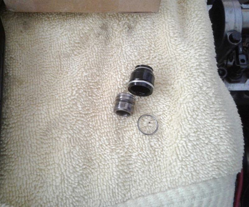

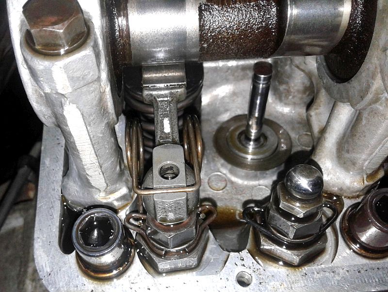

I will get a picture of it. This is a E31 head with bigger valves and had been raced hard in the past. I sold the race cam and the super nuts stiff Isky springs.
I put a smaller Schneider cam and softer Schneider springs in it. I think this was fractured at the time and I never noticed it. I even put the valve seals on it.
The plug was a bit wet with oil lately, then when I was on the track Friday it got soaked with oil so bad I was running on 5 cylinders. It finally fully broke I expect.
I dropped off my original N42 head that was on the engine at the machine shop this morning. He is going to tank it, do a surface cut
and install all new Nissan valves that I already had. I will just swap my cam kit to this when I get it back. I want to get some more driving
in this year while its still warm weather up here. Got a photo coming next.
