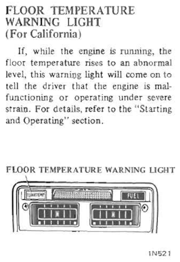

Mine is a 1/77 car.  I noticed the bezel on your fuel gauge is different than mine.  I don't have the fuel type notice on mine.   Is the "unleaded fuel only" notice common for 78' models?
I saw that too, and I think that might be a California thing. You can also see the "Floor Temp" warning lamp that only came on the CA cars.
All to do with the catalytic converter. Leaded fuel will damage the catalyst. The catalytic converter will also generate a lot of heat, therefore the floor temperature warning light.
As far as I know, they started using cats in California as early as 1975.
